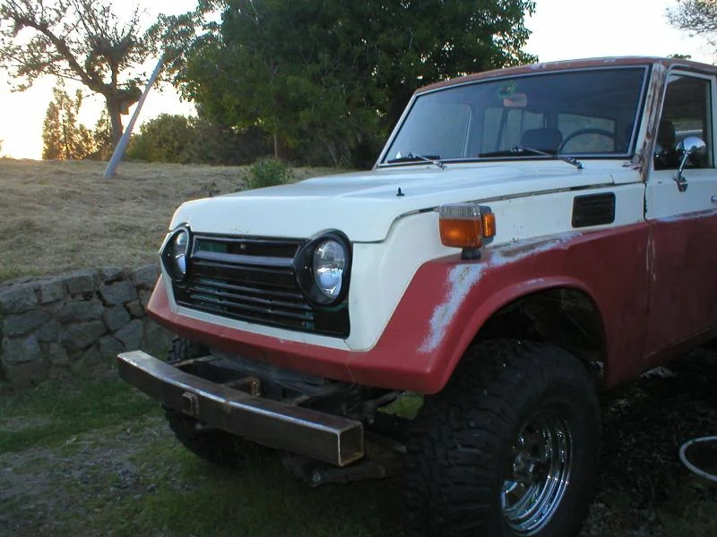

something like this one:
UZ-2T_9Lz1KwaKc74qd_nWPm_EisG2h5llheo30HvI8sF5sSUEGMHCsFC9L-x-iNmPt3M1GfKqdLErmYoRAYaNtzlP4xUrNPc2gWYXvvz7izXQcRntQP7DUwMte4ZX2mBDX44Q45toojKcJy_tvdng2oVg
I took the square tube that makes up the receiver and welded the front flush with the front of the bumper and welded a tab to the back of the receiver tube that bolts to the front crossmember.

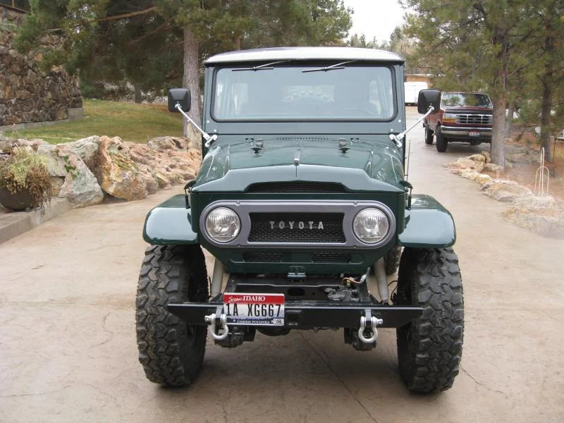

May not be too helpful to you, but here is mine...
Receiver female welded thru center of front bumper
