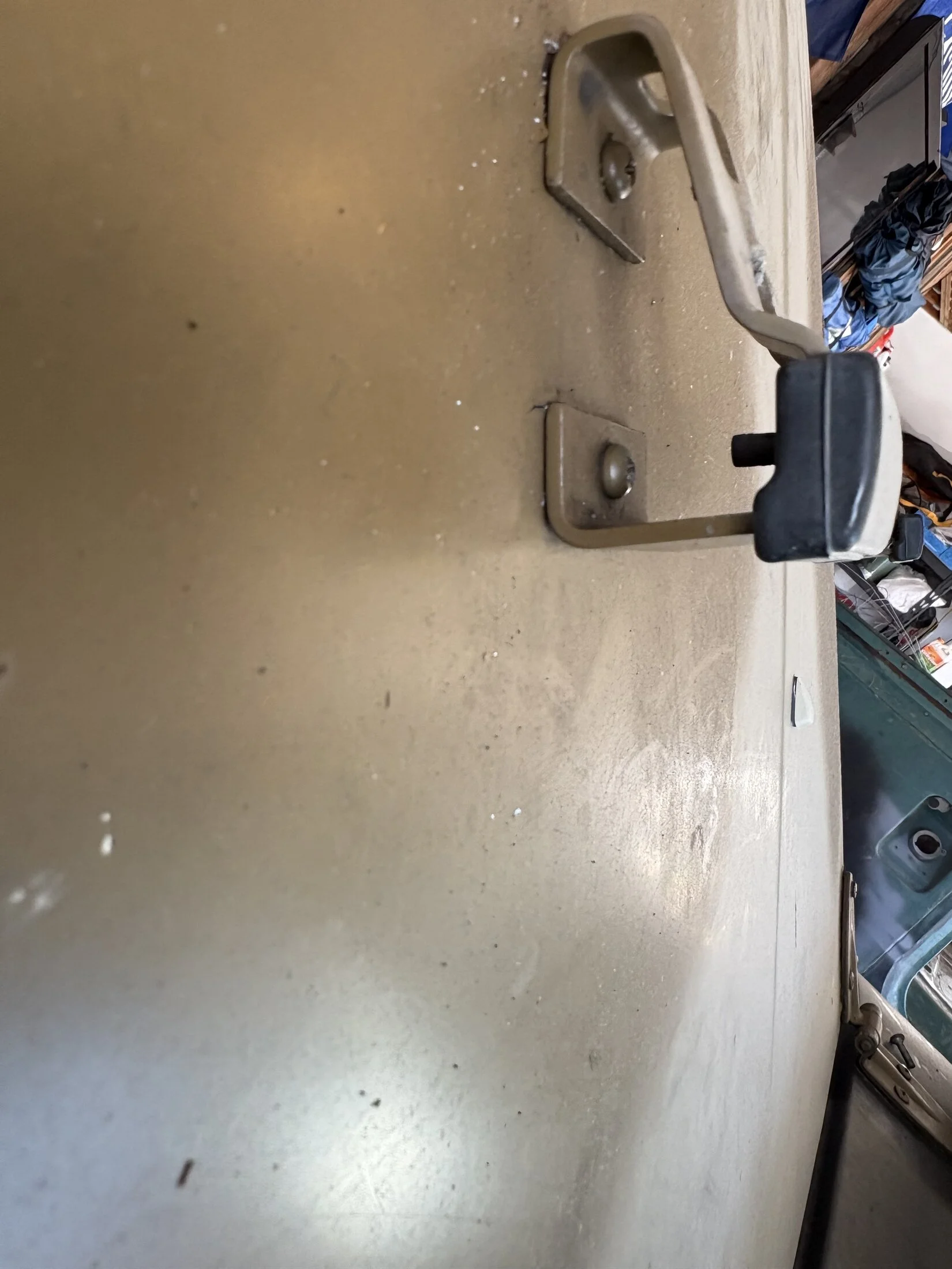

Such a dumb question, but I'm a dumb guy. How do you remove the rubber pad from the hood bumper? I really want to reuse these, so I thought I'd ask here first instead of me just starting to yank the crap out of them. Thanks guys.
I believe there is a not on the back. If head spins you’ll need a 90-degree Phillips head. Mount has opening for straight Phillips, but under the pad you may need a 90-degree one. Or use vise grips and spin nut off.

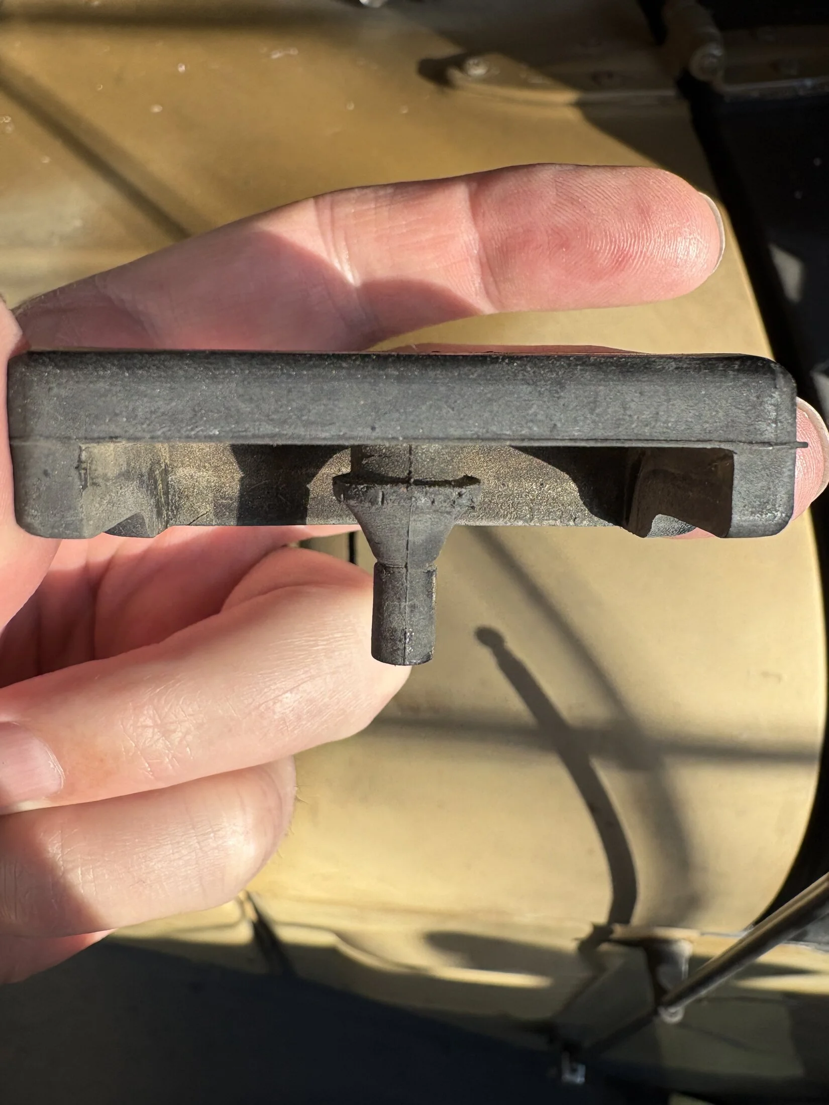

For future searchers, it just pulls off. I grabbed some long-nose vice grips to probe around a bit, and discovered it was rubber. Pulled a bit and it came off. Here's a pic of the profile after removal:
