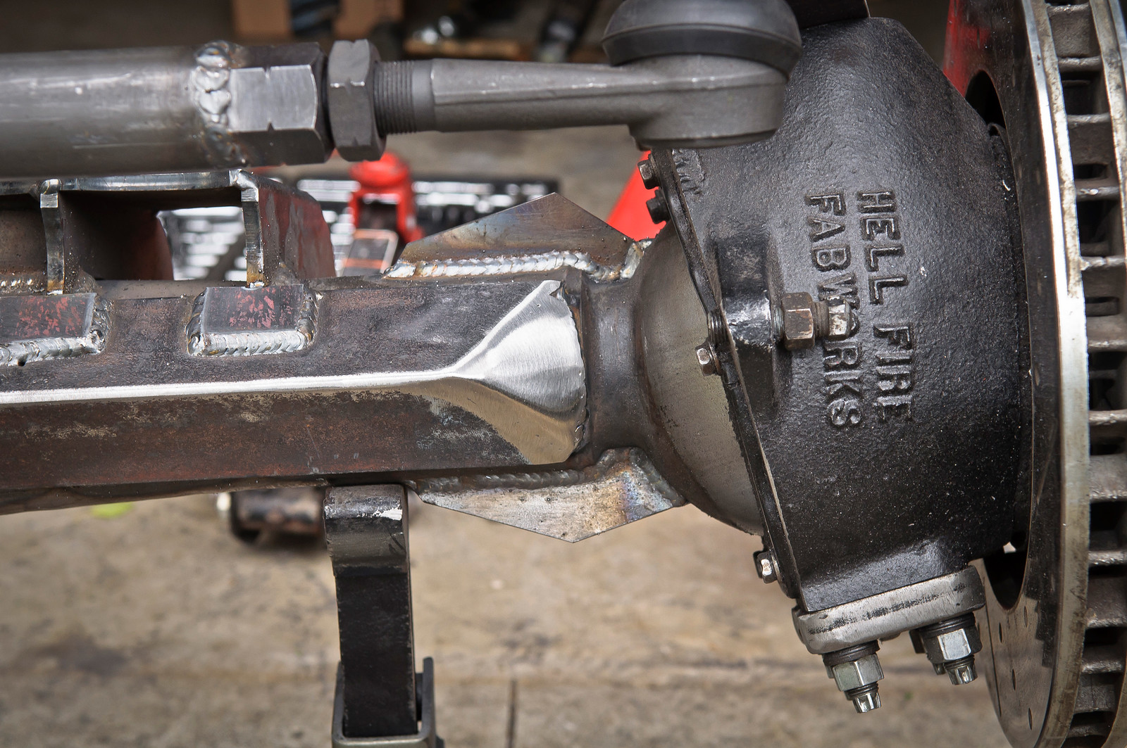

I added RuffStuff knuckle gussets to reinforce the neck at the ball...
