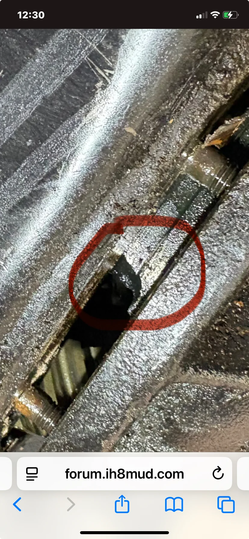

I’m trying to do this, I should say.
Anyway, while picking and scraping away the factory gasket I noticed what appears to be broken metal inside the carrier.
Has anyone else seen this?
I also don't see any broken metal, looks like some old gasket that's lifted up but also a large section of old gasket is missing.

We should be looking at the base of the bearing carrier from your camera angle. It has a few odd shapes and angles and looks consistent with your photo?

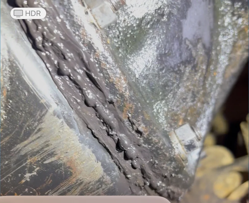

Yes. It’s holding the diff oil.
I used a caulk gun and squirted it into the quarter inch gap as far around as I could. Then I was using my hand to push it in along the top. Then I let it sit for about 5 minutes or so then slowly tightened up the diff.
It worked!

I figured I would drive it around town and off road for a few weeks and give it a chance to chew up any excess rtv floating around in there then drain the diff and refill.
