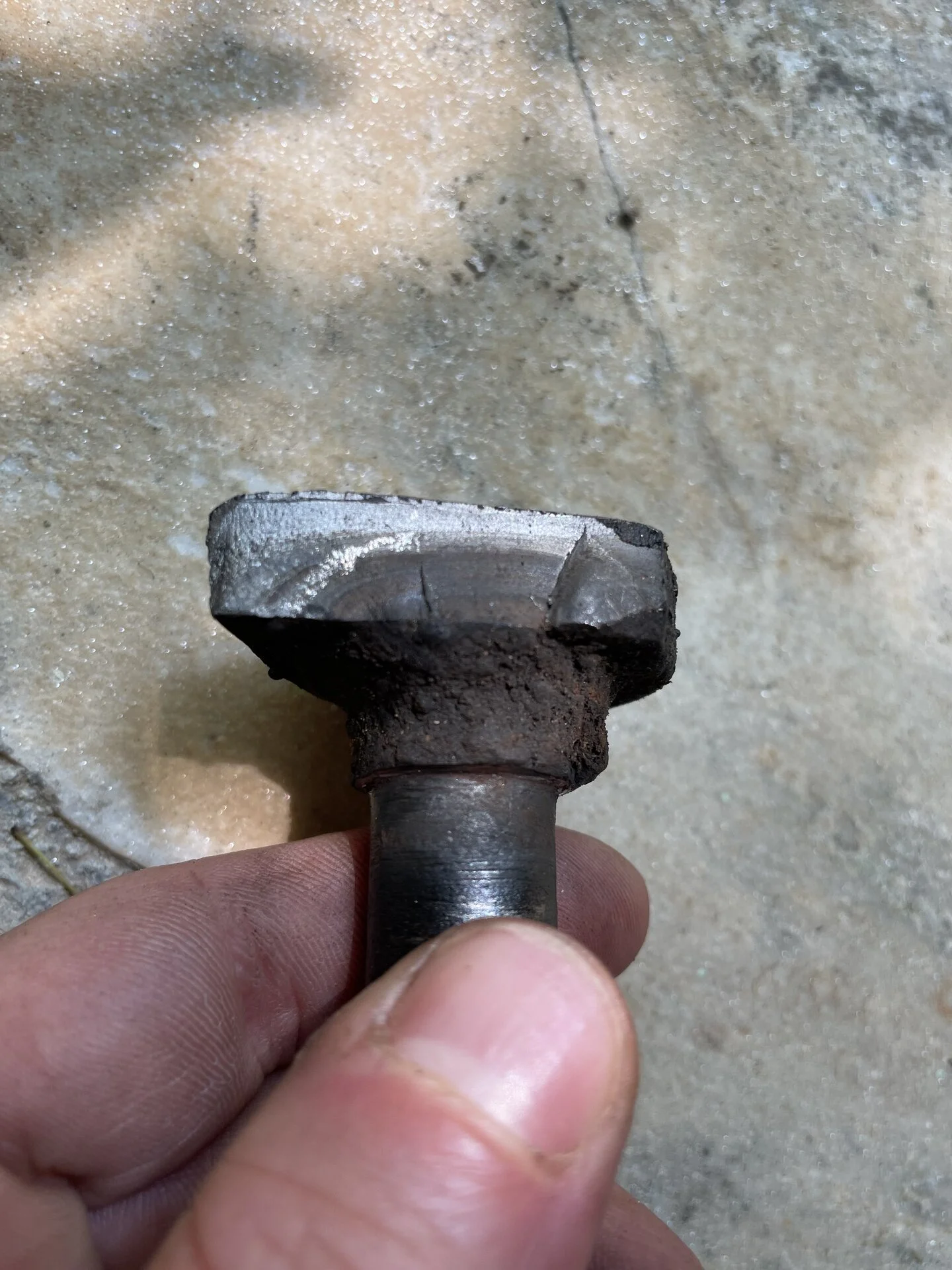

Today I found the bracket for the damper ripped off. No idea why, I just did the groceries:)

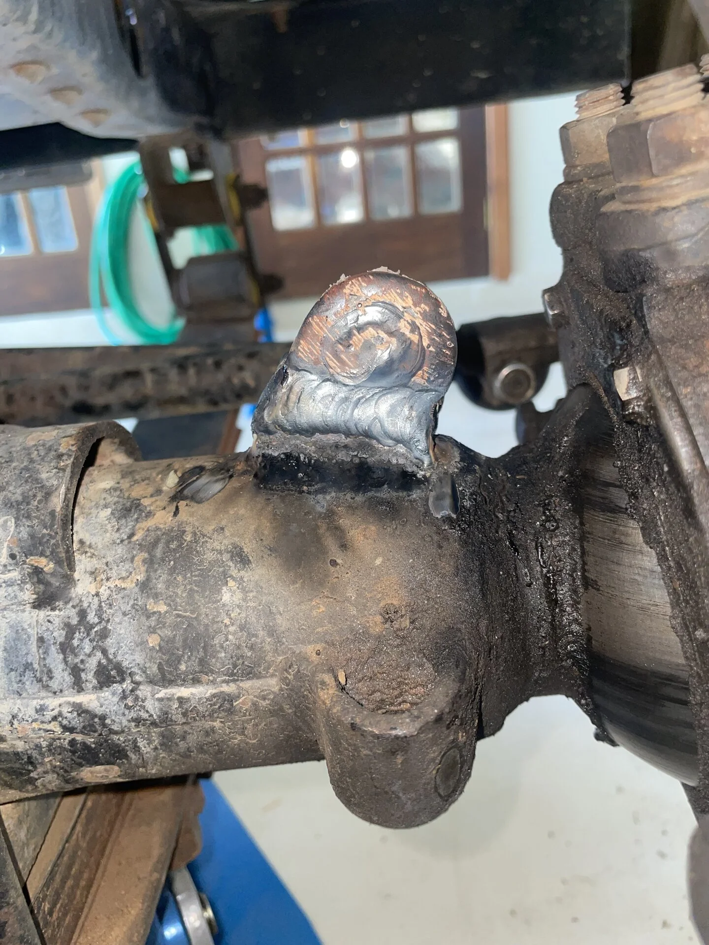

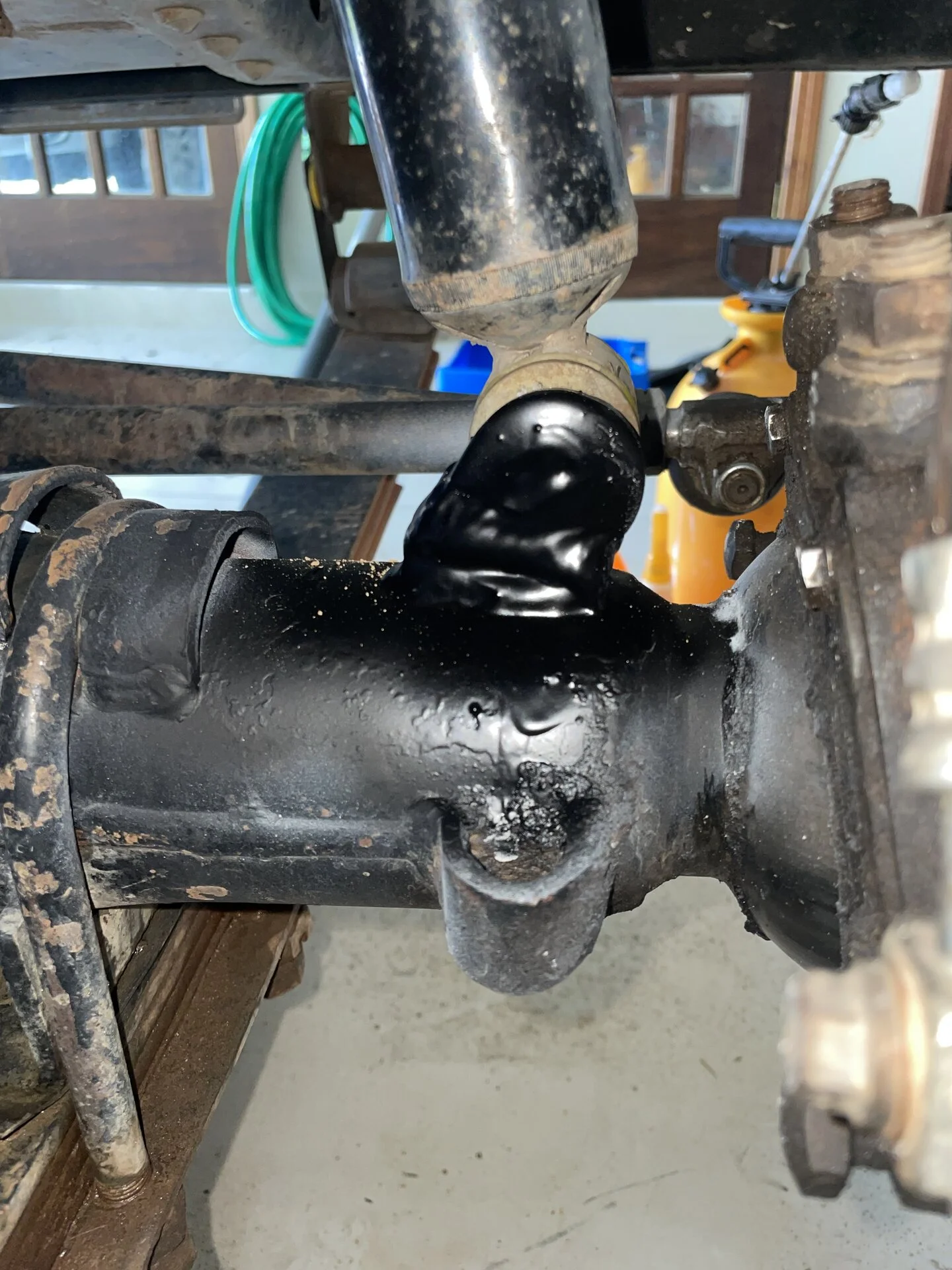

Thanks a lot.
I just was at a welder shop which already did some weldings for my old Jipe.
He was surprised but said, he can do that tomorrow morning. I just need to bring a jack, remove the wheel and disconnect the battery.
I asked him about the additional cornerplate and he said, he can do that as well, but then he needs/ wants to warm the axle. In that case I would need to remove it and dismantle it completely.
So I go with the first option and if that happens again, then I remove the axle and design complete new brackets.
The bracket seemed to be predamaged fo a long time.

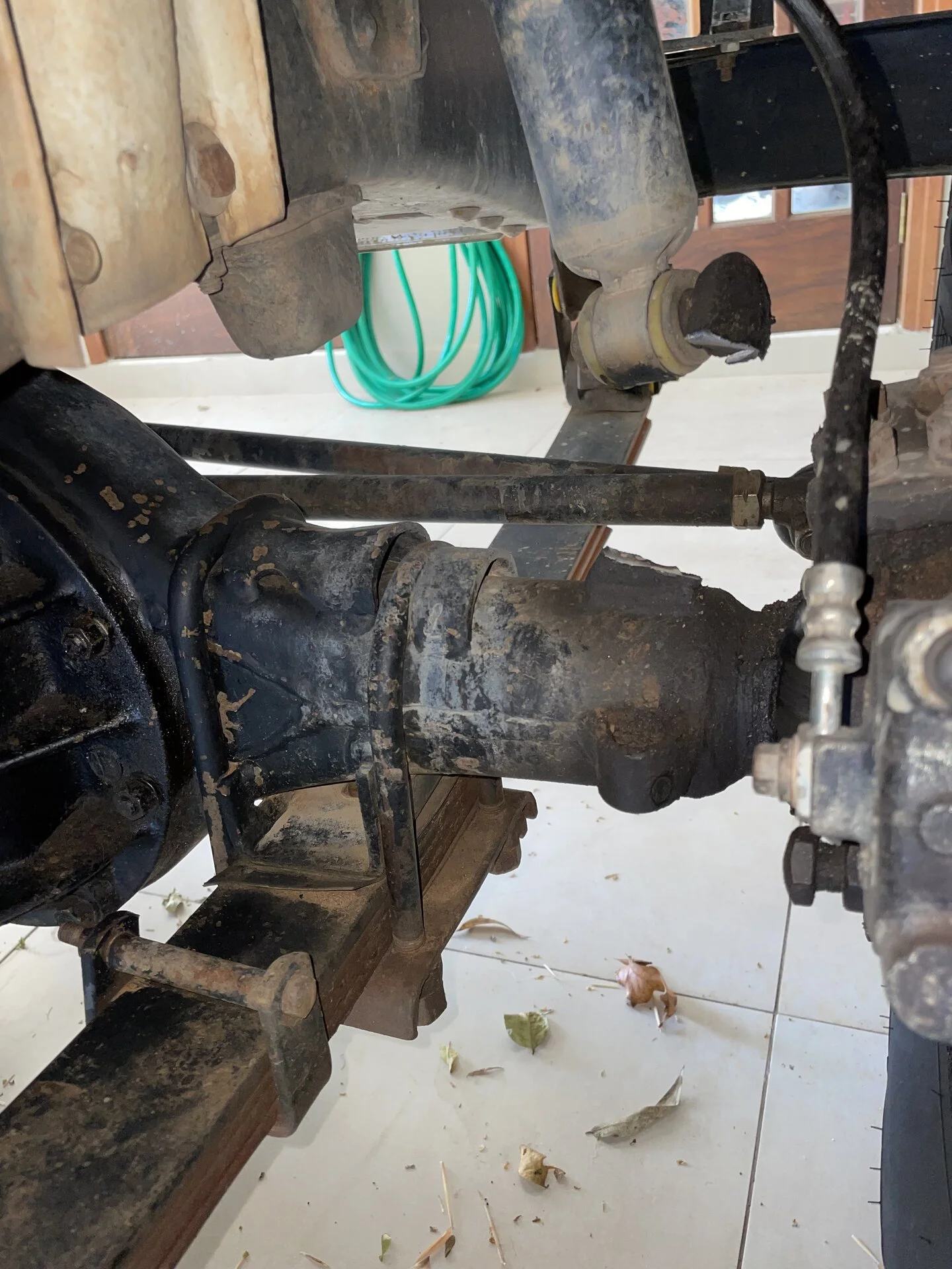

Shock too long, bottom out is on shock not bump stop, spacers under bump stop or shorter shock.
All original, so it should fit. But I'll have a look, If I can lift one side until the axle touches the bumper and then check the shock-absorber.
There was a long time crack in the mount which stress probably broke. I would investigate the length of the shocks. It should weld on fine without stripping the axle but be sure they cut a good root grove to reattached and not just scab it on with a zap here and a zap there.
