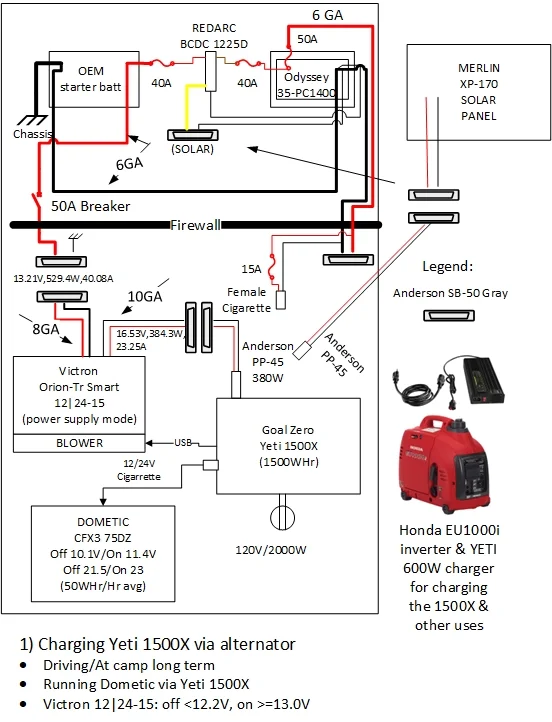

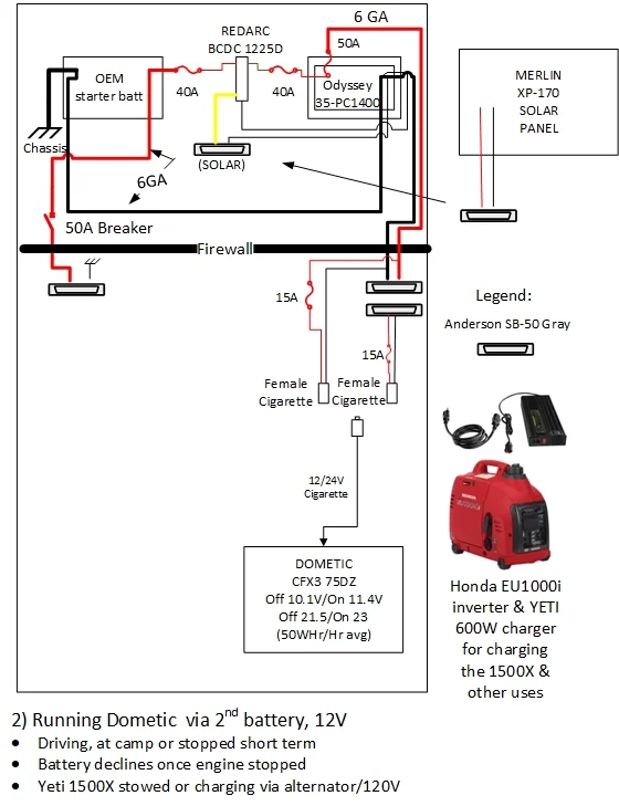

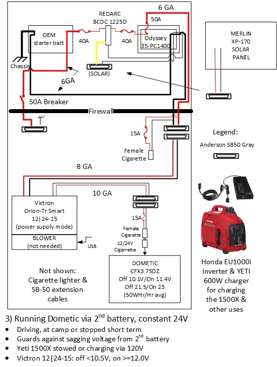

I have 3 batteries: starter (obviously!), a 2nd AGM battery under the hood, and a portable Lithium battery which is used to support camping on and off grid. If I were just interested in supporting just a refrigerator I would have done less. This setup doesn't have to be done all at once. You can pick and choose what level of implementation suits you, of course. One of my main requirements was not to drain the starter battery to where it would not start the car and to stay away from tapping into Toyota's wiring other than at the battery terminals.
Some thoughts:
  • Budget 50Wh/h power usage for a larger fridge under everyday use (hot car, opening/closing the lid) and 25Wh/h under ideal circumstances (75F, no open/closes of lid).
  • You will have to go through the firewall with wiring if you don't want to tap into Toyota's wiring in the passenger compartment; this isn't hard to do.
  • The connection to the starter battery is to mainly charge the Goal Zero 1550Wh Lithium Battery when driving.
    • I use a Victron DC-DC 24V charger (set up in power supply mode) to cut off as soon the engine stops. This is accomplished by choosing voltages to stop/start power output such as 12.5/13.0V.
  • If you have dual battery then drainage is less of a concern and the DC-DC charger, if it's a REDARC, then you can also support solar.
    • You can run the refrigerator directly off the 2nd battery
    • Or, if you want regulated constant power from your 2nd battery to your refrigerator add a DC-DC charger. I use the same Victron charger to run the refrigerator and charge the Goal Zero.
    • We have run the refrigerator on the 2nd battery and taken the Goal Zero lithium battery into a hotel room to charge it overnight.
Here are some drawings which show some the use-cases which we have encountered while on the road.

Use case 1:
Use case 2:
Use case 3:
Simplest solution if your vehicle isn't a dedicated adventure rig, or you don't want to modify your vehicle much is use something like a EcoFlow Delta 2 or similar. Have it fully charged before the trip and supplement with vehicle (cig lighter plug) or solar charging during the trip.

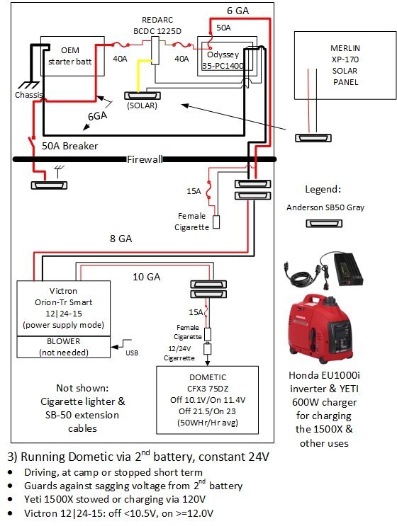

Some thoughts:
Again, all this is to support camping in general.
It's modular so carve out what suits you.
Use case 1:
Use case 2:
Use case 3:
