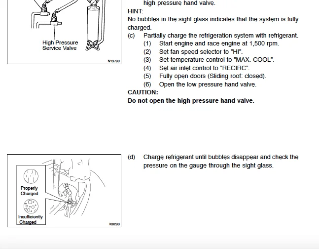

I have question for the A/C gurus-
I noticed bubbles and foaming in my sight glass- it cycles through filling- bubbles- foam- then full/clear then it slowly recedes and the bubble and foaming repeats. Is this acceptable or is my system low on refrigerant? A/C blows very cold-
Here's a VID
If it does it while running it is probably low. If it does it only when you turn it off. Then that is normal from what I have read.
It may be a little low. Only way to know will be to put a manifold gauge set on it and run through the procedure in FSM. Time to find a good AC man.
