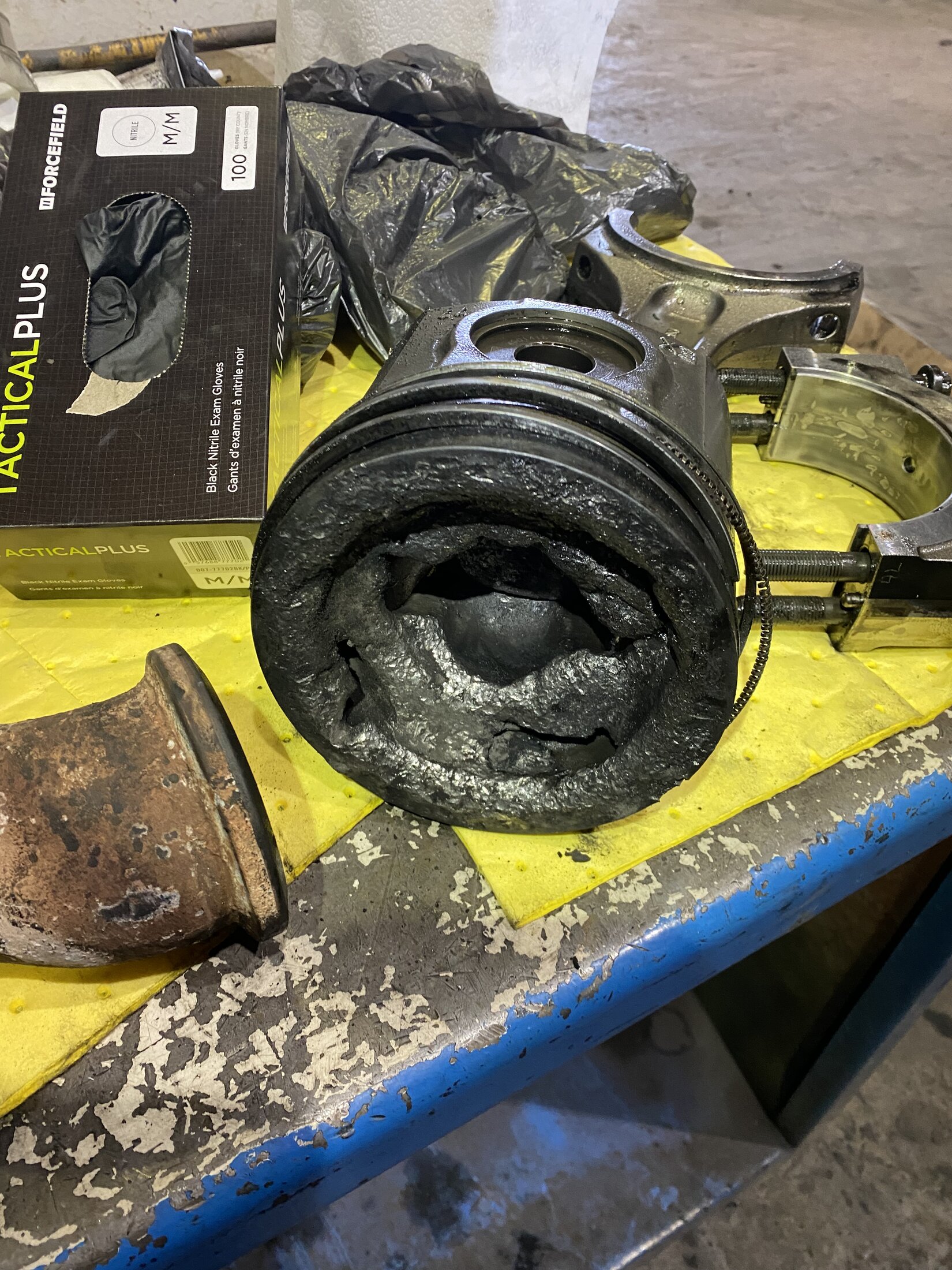

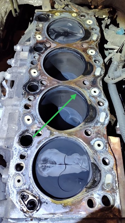

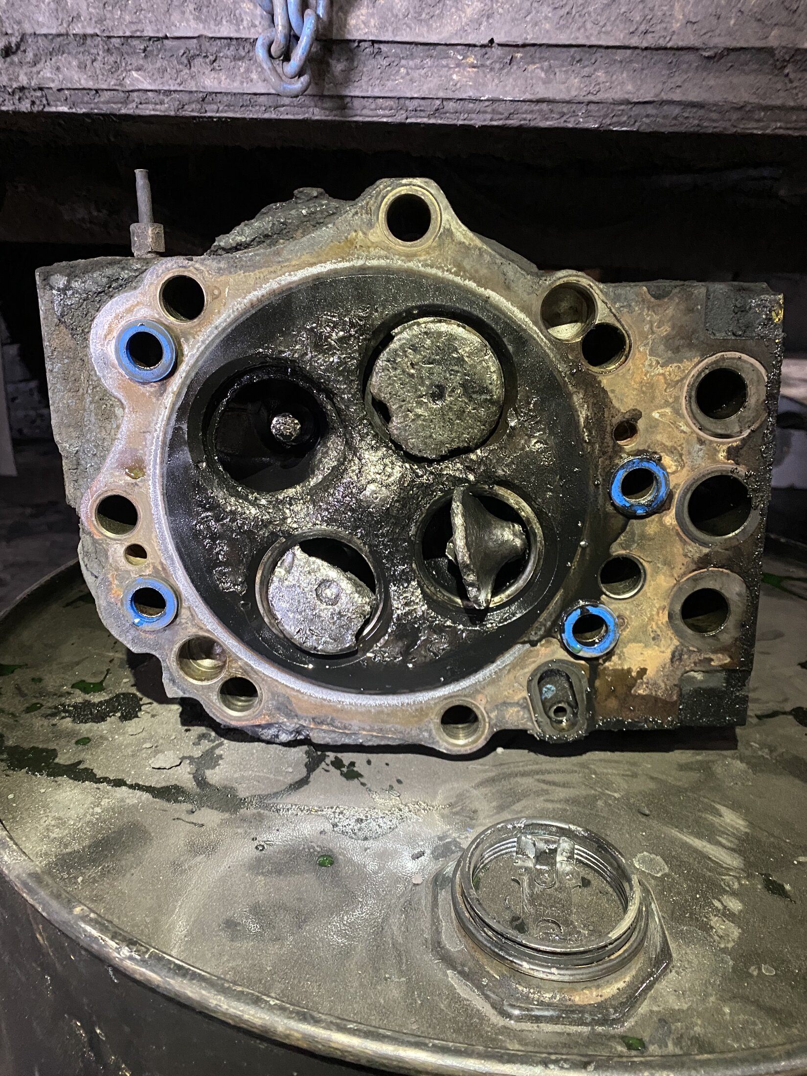

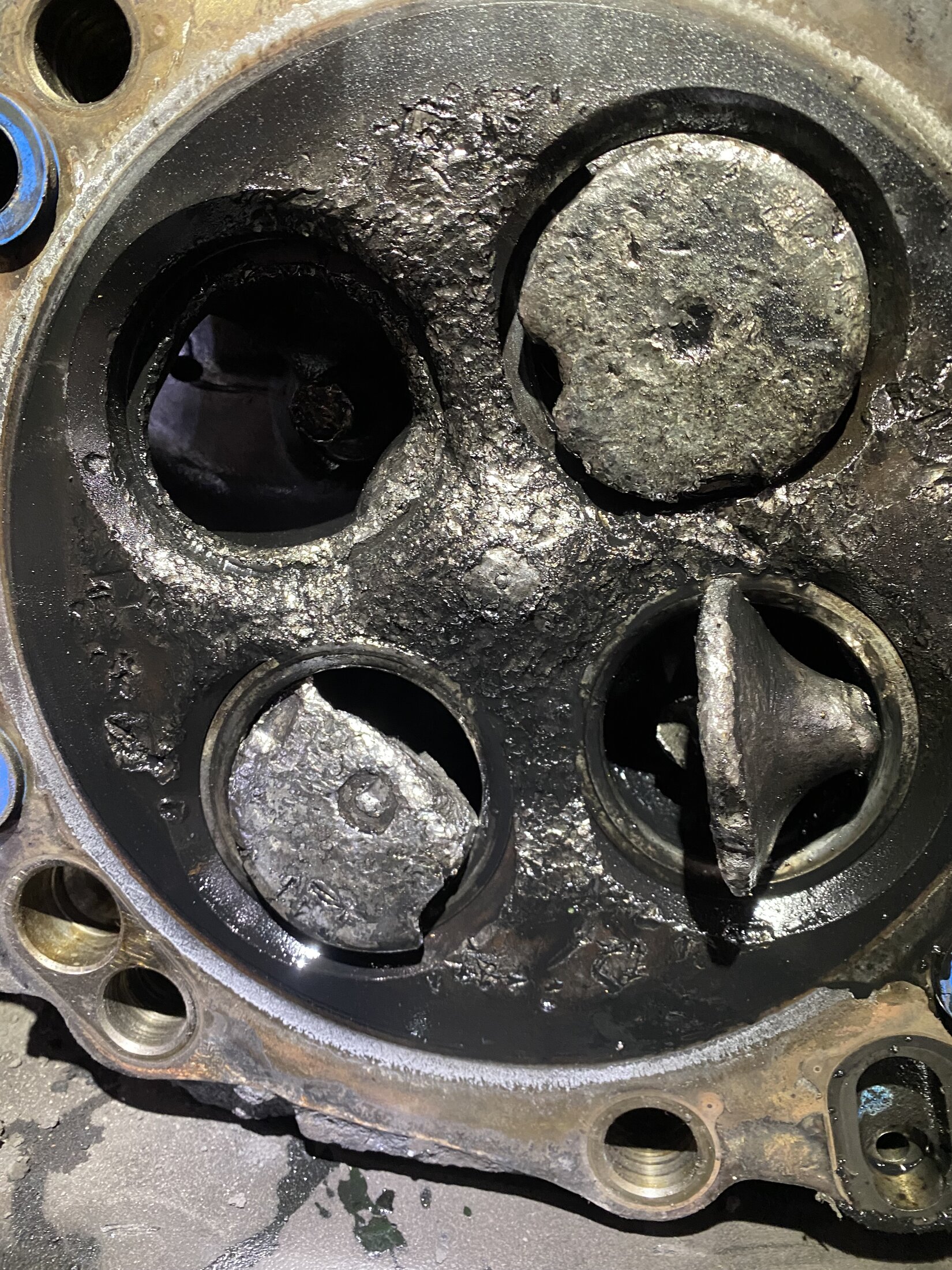

1) I’m not a diesel mechanic… and learned from an older mechanic who has messed with boats, motorcycles, cars, trucks, show mobiles, and everything else imaginable since the 70s.
2) I was taught that on a higher mileage (more worn) motor, you need to do the top end of the head if you’re replacing rings.
They worked on a friends old car that had a valve issue. To keep costs down when they replaced the one valve that failed, they only lapped the valves by hand (with some valve compound) to minimize the charge.That engine always pushed some blue smoke after that.
So, I’d swap the rings and put them Freback with as little change as it charge as possible, and hopefully it’ll work out. Use current rings on new pistons.
Thanks bikersmurf. Appreciate the thoughts. I did do a pretty comprehensive job on it 5 years ago. So other than the cracked pistons, it's actually pretty fresh and in good shape. This is partly why I don't have it in me to go through everything again. But as mentioned, I'm actually optimistic it'll run just fine after this....
Impressive damage! I can only guess the egt must have higher than 1000?
Yeah nothing wrong with a quick and dirty slamming of new pistons in there as long as there’s no lip here:
If there’s a lip it will just smash up the top ring, not good, If there’s no lip (usually isent on Toyota diesels) you’re good to go! But Definitely put new rings on they are very cheep comparatively to everything else.
Don’t worry about honing, but do a break in as you would a new rebuild, full send, Heavy towing with non detergent oil for the first 1000.
Hi Steve, thanks a lot for your thoughts. I did read about lip there, and it's bad if using brand new rings. But original rings on similar worn pistons would be okay. In any case I'll clean and inspect that carefully. Hmmm, okay you're making me think twice about new rings if there's no lip. Guess pulling extra two pistons isn't that much extra work. But if new rings don't seat, then I have four instead of two with blow-by, haha.
