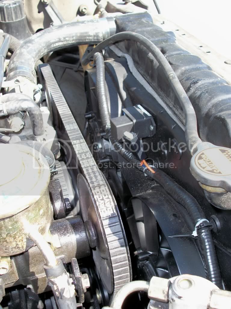

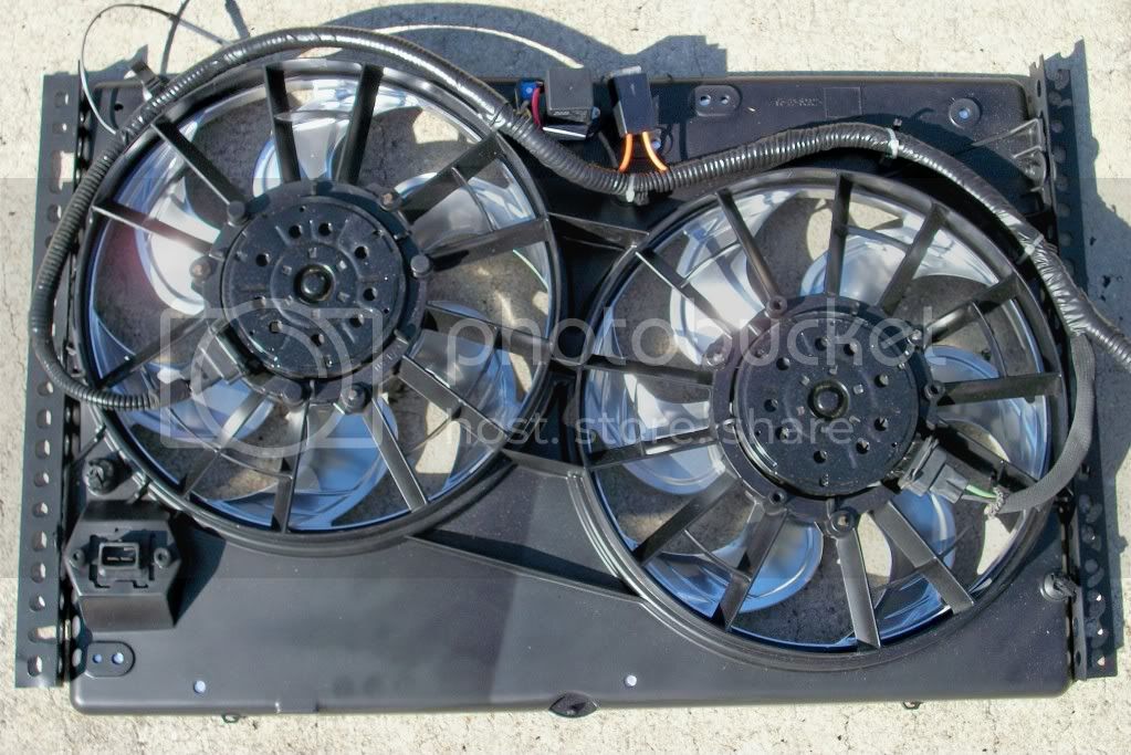

Installed these fans 2 weeks ago. Cost me $35 at the local pick-n-pull. Took me about a half-hour to get them out of the car...took another week to put them in the LC. :bang:

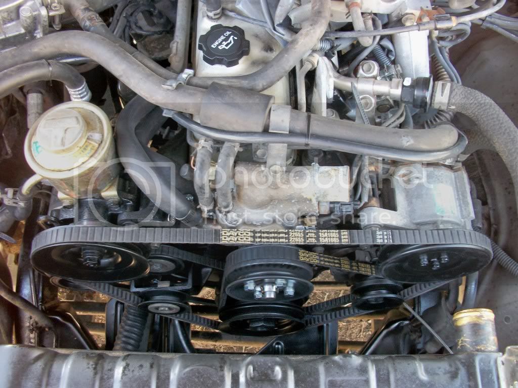

While I had the stock fan & shroud out, I decided to clean things up a bit. Started brushing the buildup of gunk off of the top of the water pump and noticed a small stream of anti-freeze pissing out.:crybaby: Aparently, the pump had corroded from the inside out and the gunk was the only thing holding it together.
So a week later, a new water pump, belts, hoses, and some paint...I have e-fans in the 62.
Here's some pics:
After the new pump, belts, hoses and paint
The fans all wired up and painted:
And installed:
They've worked great for the short time I've had them in. Based on other's results, I don't anticipate any problems.
