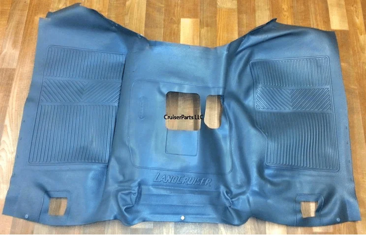

Is this the OEM vinyl floor?
Yeah, that is what I had up front of my FJ73. Looks pretty close, if not exact match.
Does that flooring have the jute padding on the bottom side?
I am still going to call Australia tonight to see if they can ship the molded vinyl at reasonable cost.
On the FJ73, I don't recall it having any of that padding on it but I never completely removed it either.
I do know I was not able to use the BH3 3D molded cup holder I got in a group buy because of the way the vinyl flooring went over the raised edge, it was rather thick.
Yes, that is OEM vinyl for a 75 series but works well enough for a 73/74... but you would need to come up with something for the 2nd row and cargo area. It does have padding on the bottom side. You can get it from your local dealer... 58510-90L01-03 (gray).
The FJ73 was vinyl all the way to the back. I do believe the rear portion was Colombian made to match the OEM vinyl front.
Japan factory vinyl was 3-piece (not including the wheel wells) and carpet was 2-piece for the 73/74.
