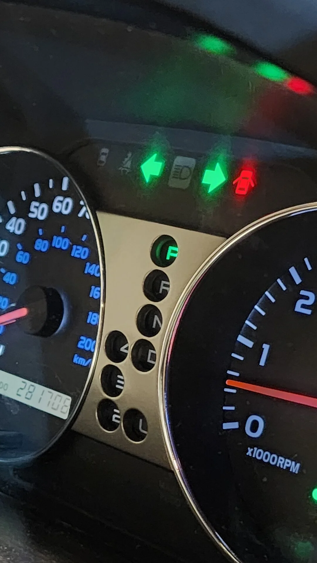

Every now and then, after a lot of rain or a car wash, my hazard lights will come on and won't turn off. When driving, the little red "SECURITY" light might be on, sometimes not. So I think water is getting at some connection having to do with the security system. I just don't know where to start looking. 😕
Look by the passenger floorboard kick panel to see if there is evidence of water.
Check the driver side floorboard kick panel for evidence of water.
Check your sunroof drains to ensure they are draining.
Your windshield could have a small leak allowing water to get into your a pillar and chase down to wiring harness connections.
