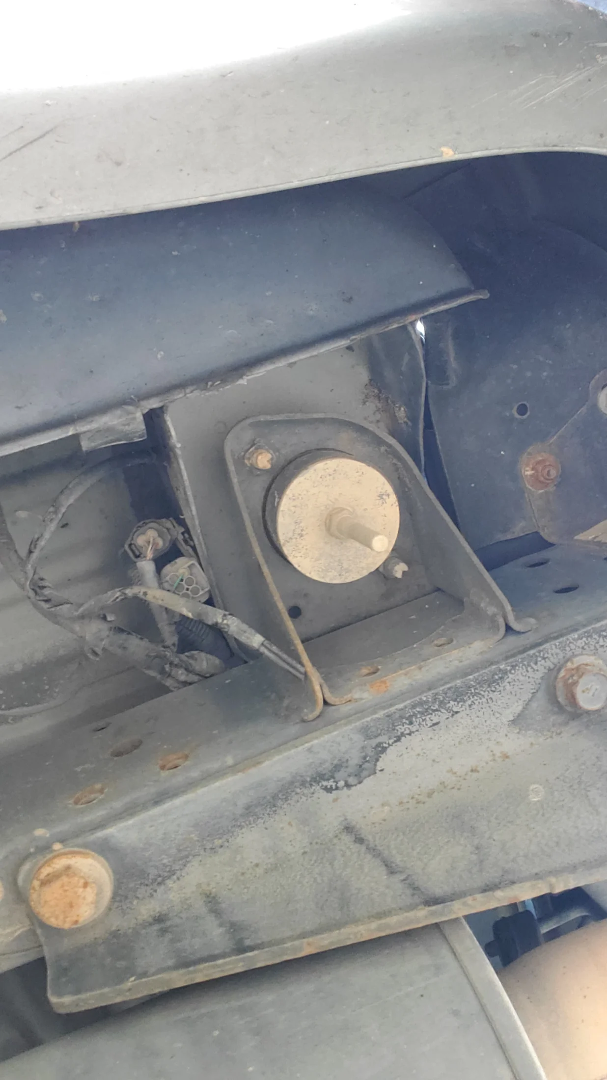

Check and clean your trailer wiring connector in the back.
Did this happen after the removal? Did you insulate it well? Both me and my cousin (owns a montero) experienced same crazy park/blinker issues. It was all at that trailer wiring.
Do you notice any water on the foot well? Any leaky sunroof on to the fuse box? Any new wiring you did?
I removed the trailer harness after searching to see if anyone else had this issue, a few had similar issues that were caused by it.

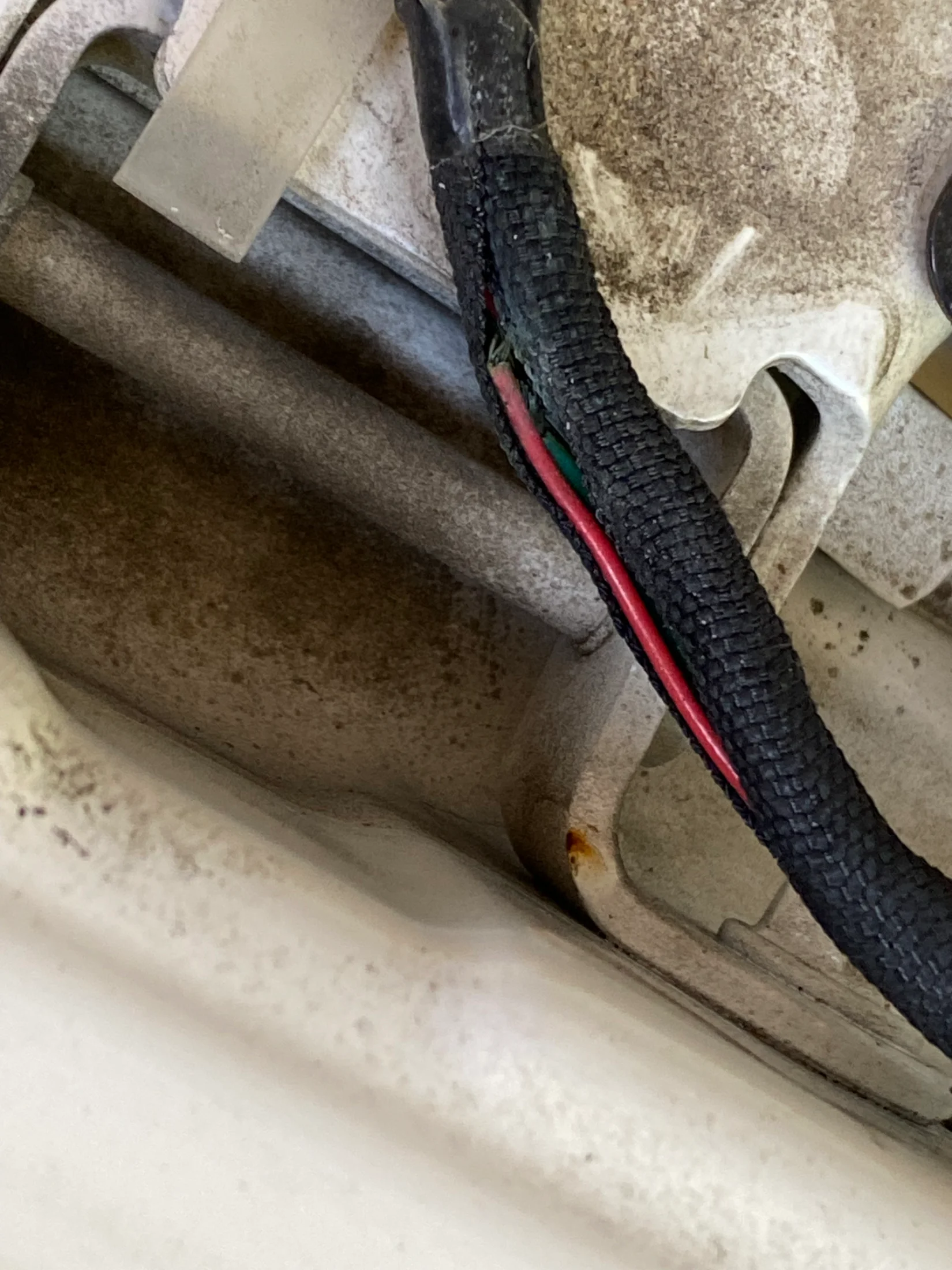

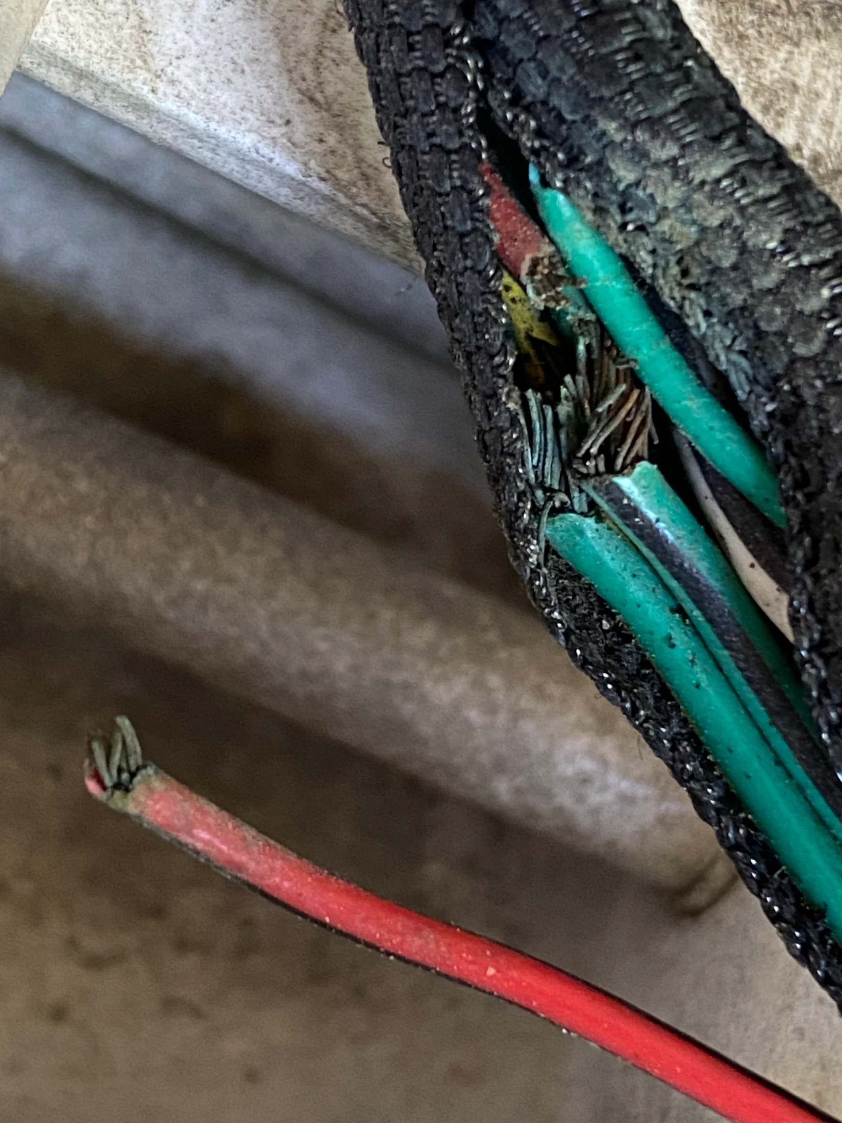

I did find this wire cut underneath at the rear of the car, not sure what it was for, but unless someone cut it while I was going 80 on the highway (when the problem first appeared) I'm skeptical it's the issue.
I'll check on that wire.
try removing both rear light housings wire plugs from the factory wire harness. Also remove the trailer wire connectors from the factory wire harness.
