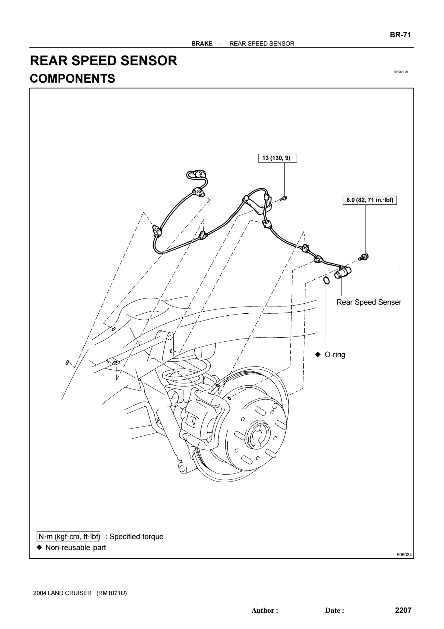

Thanks much for the info. Exactly which sensor is it that needs to be replace and where on the car is it located?? Thanks again.
