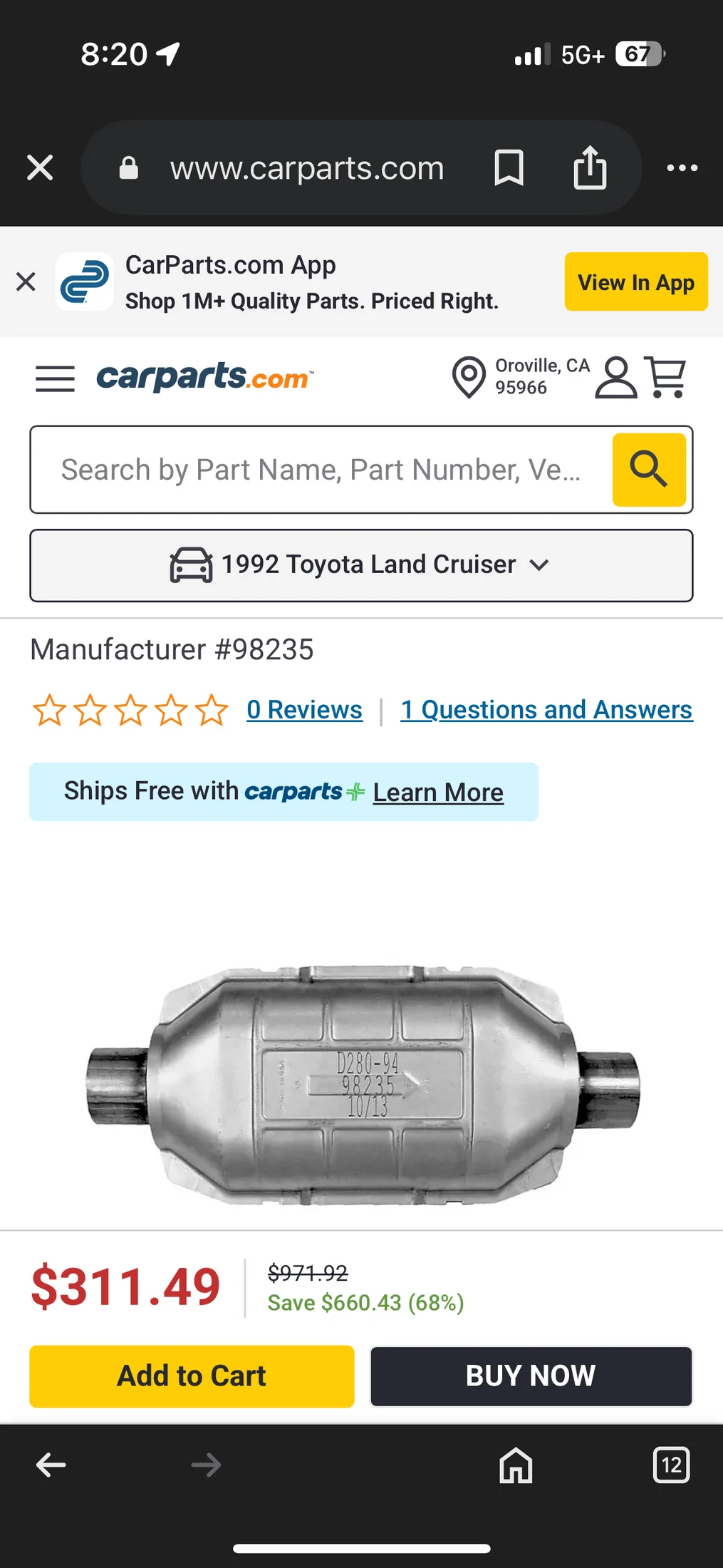

To update this post. I just ordered this one. Confirmed with muffler shop its compliant. Cheapest I could find by 100 bucks.
The 92 passed smog every year since Ive owned it but this year. Done all I can think of and barely will not pass. 134 ppm cO2 at idle (120 max). Smog guy and my mechanic told me it will be sigle digits with new CC. I’m tired of messing with it. Let you know how it goes.
Not bolt on.
