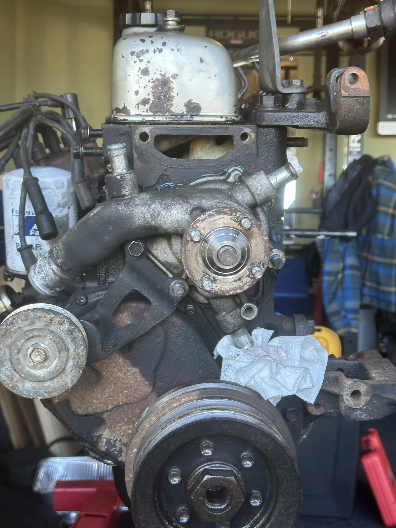

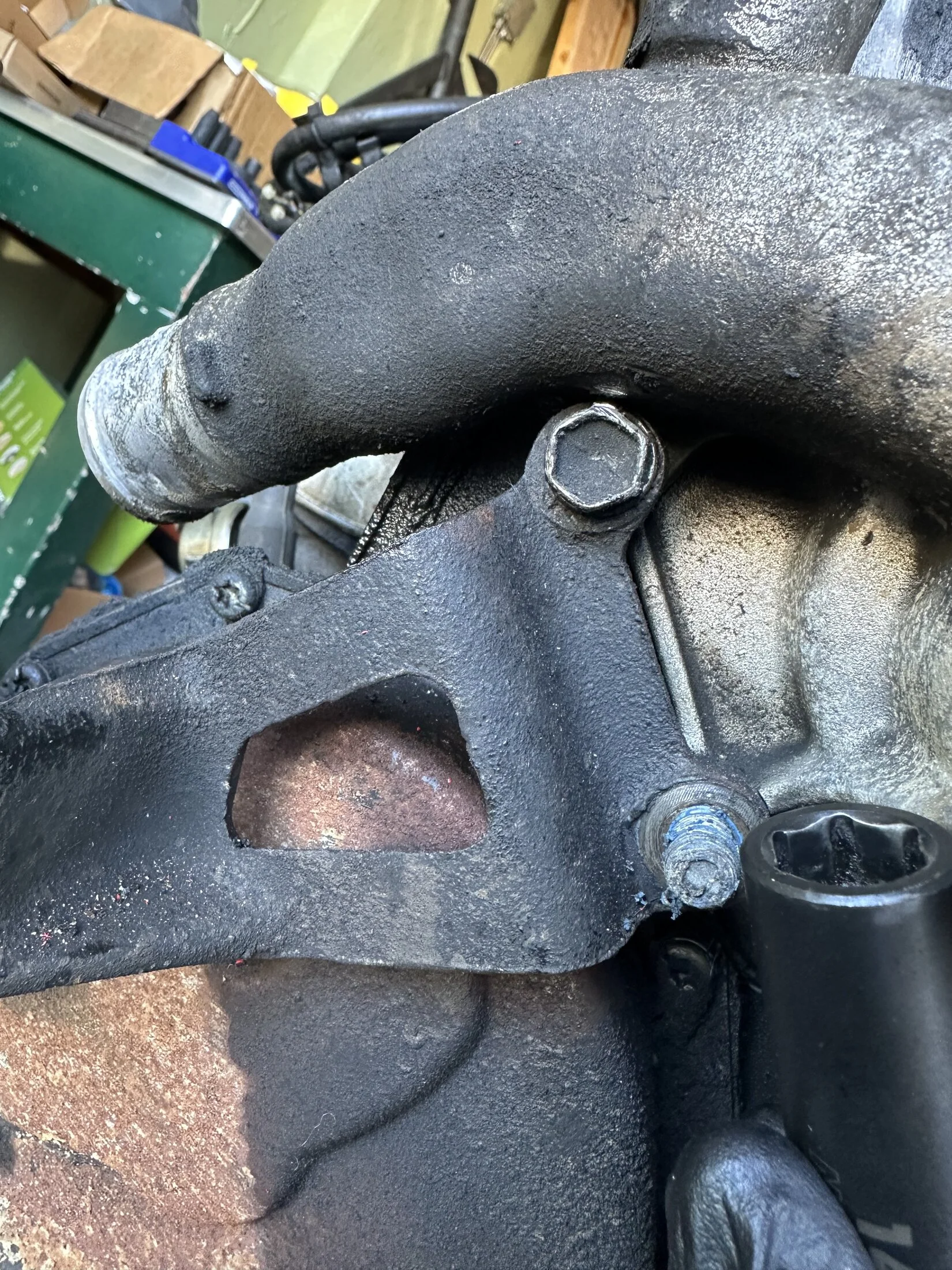

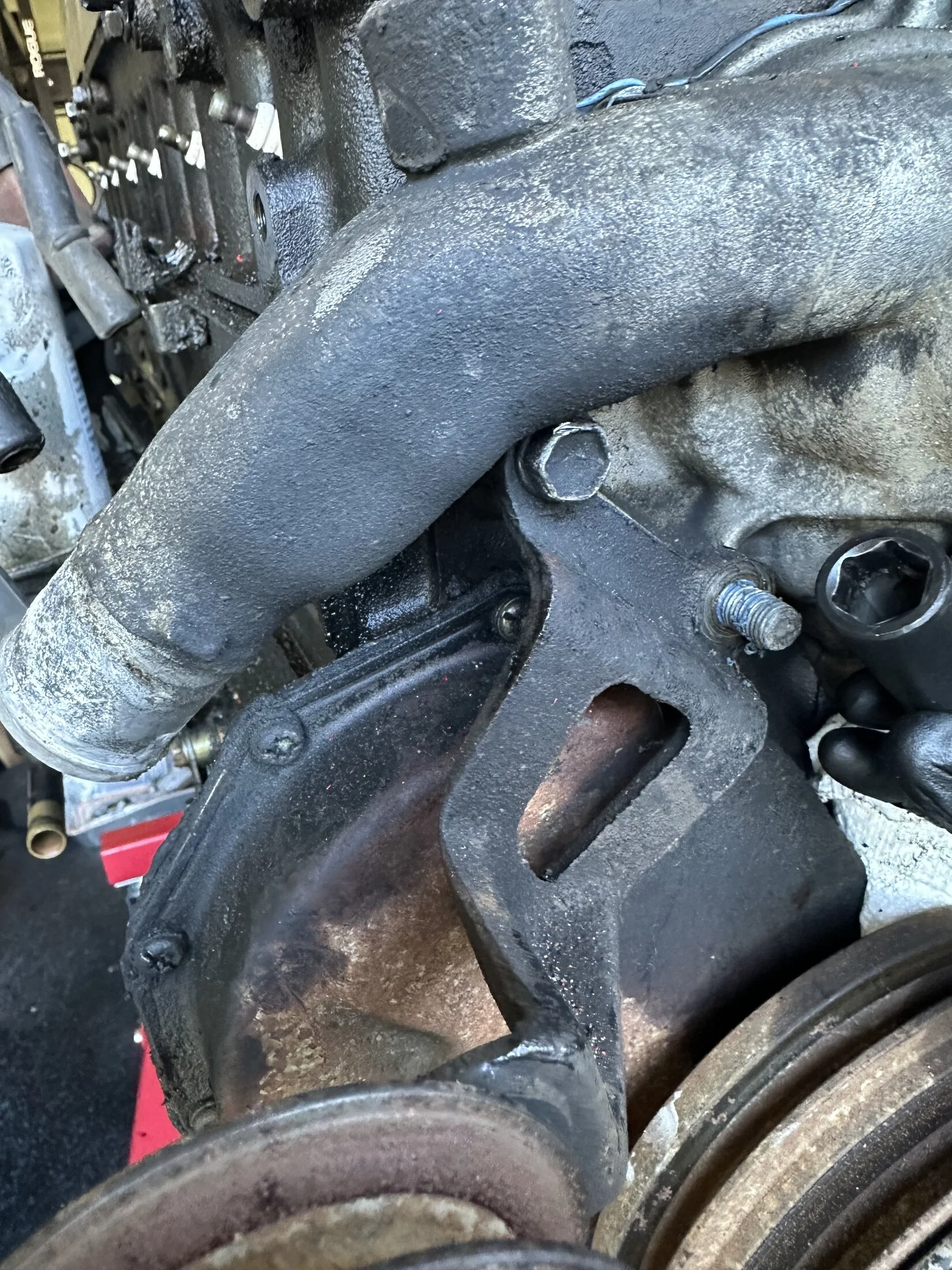

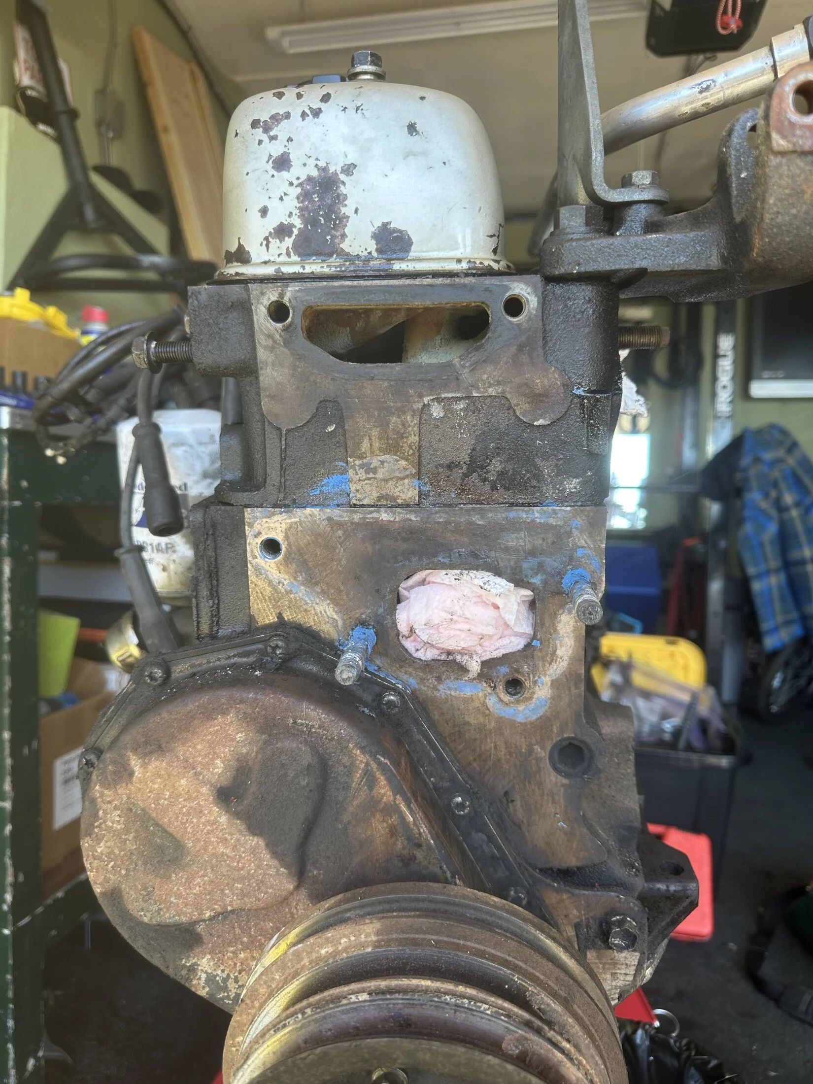

Hi everyone,

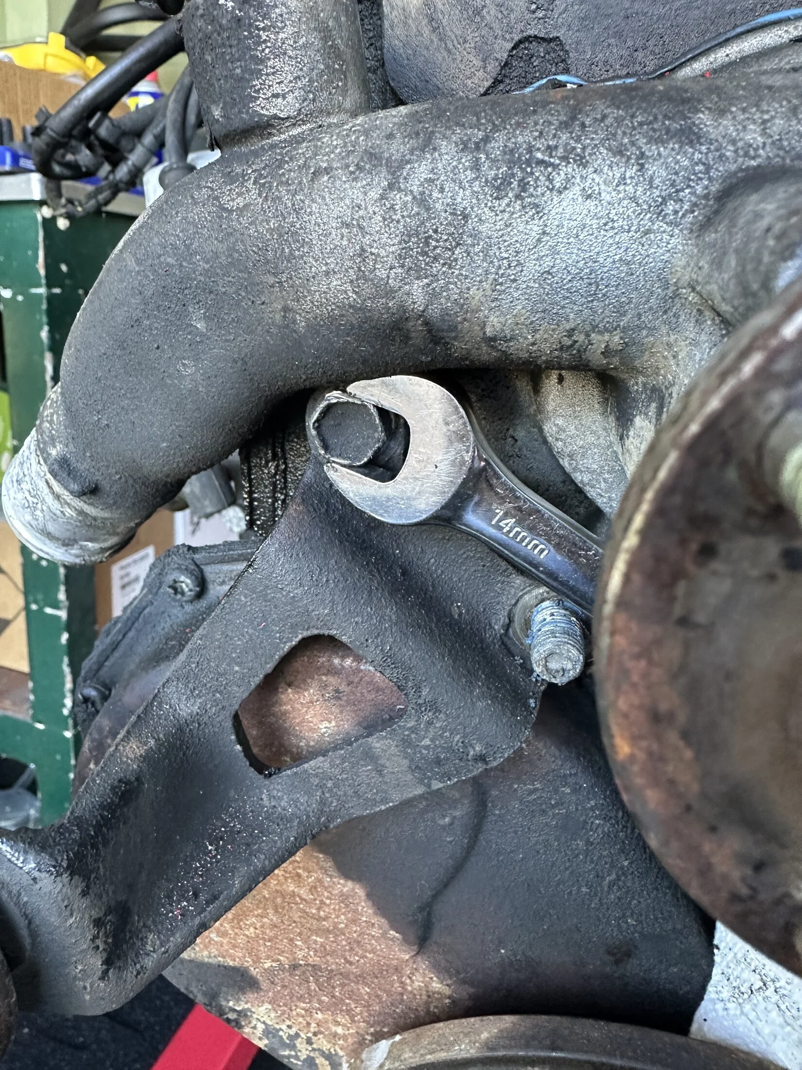

I feel a bit stupid asking this but I’m literally being beaten by a bolt on the water pump. How do I take this off? No clearance to get a crescent wrench, socket wrench, cat claw crescent wrench on the bolt to loosen it?

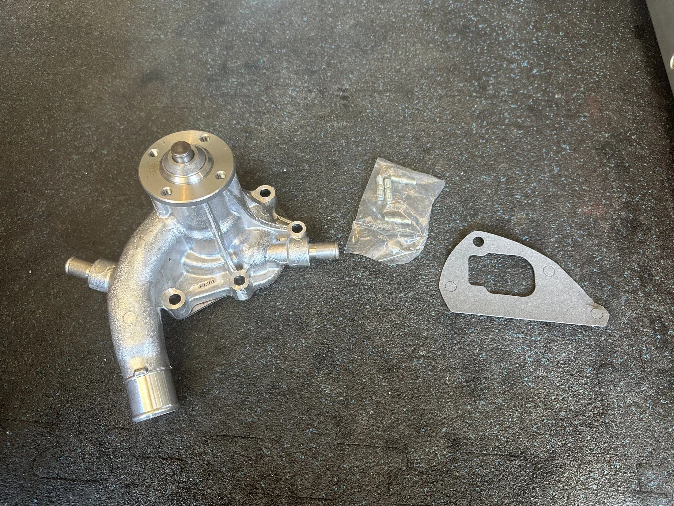

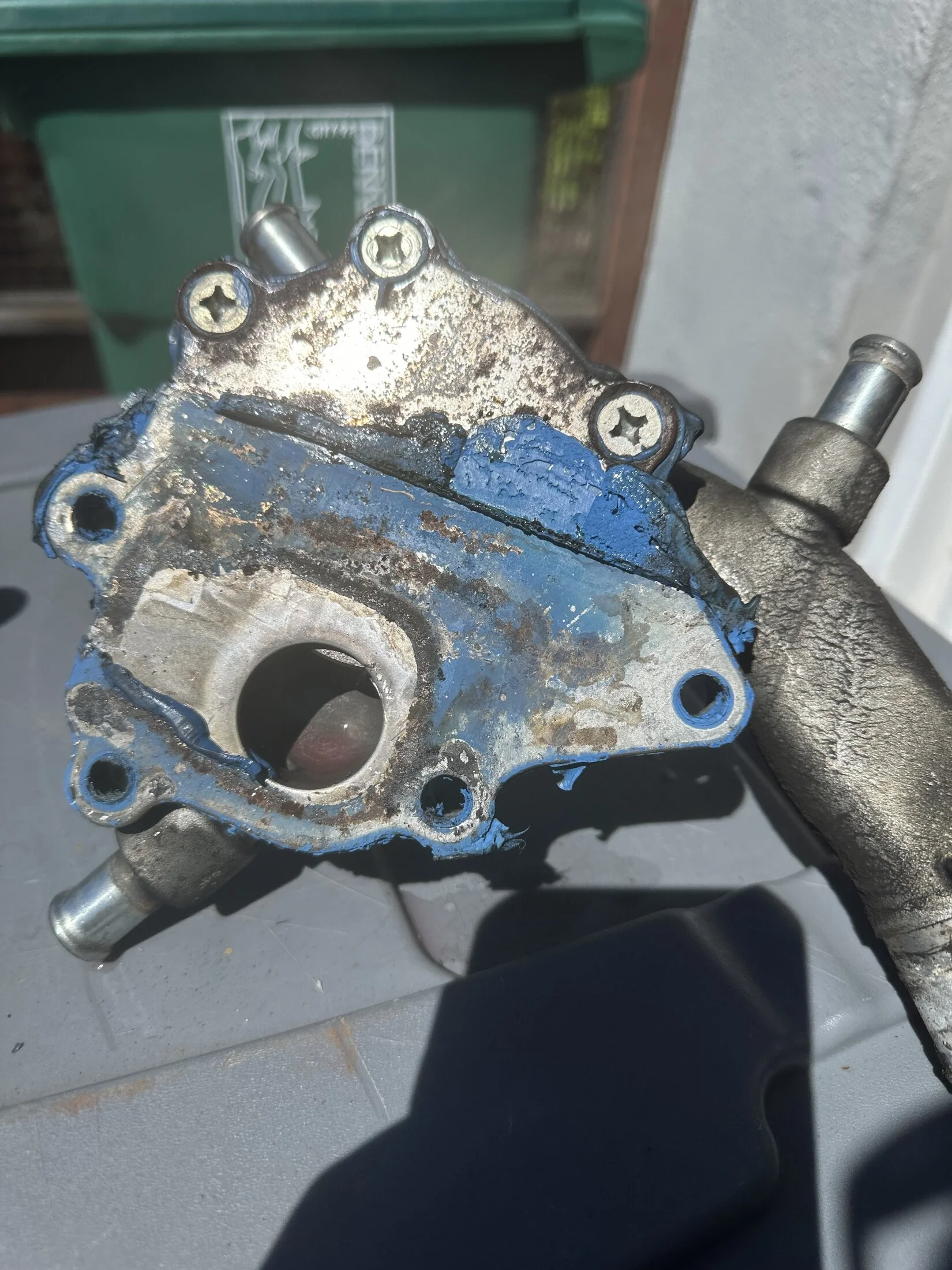

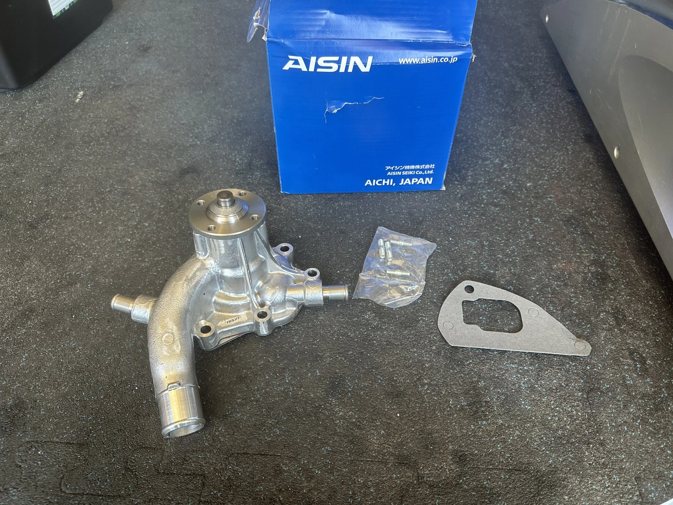

that should be a stud and not a bolt from factory. Also that doesn't look like a Aisin or OEM WP....

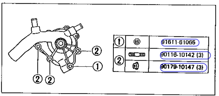

Correct. 3 studs, 1 bolt.

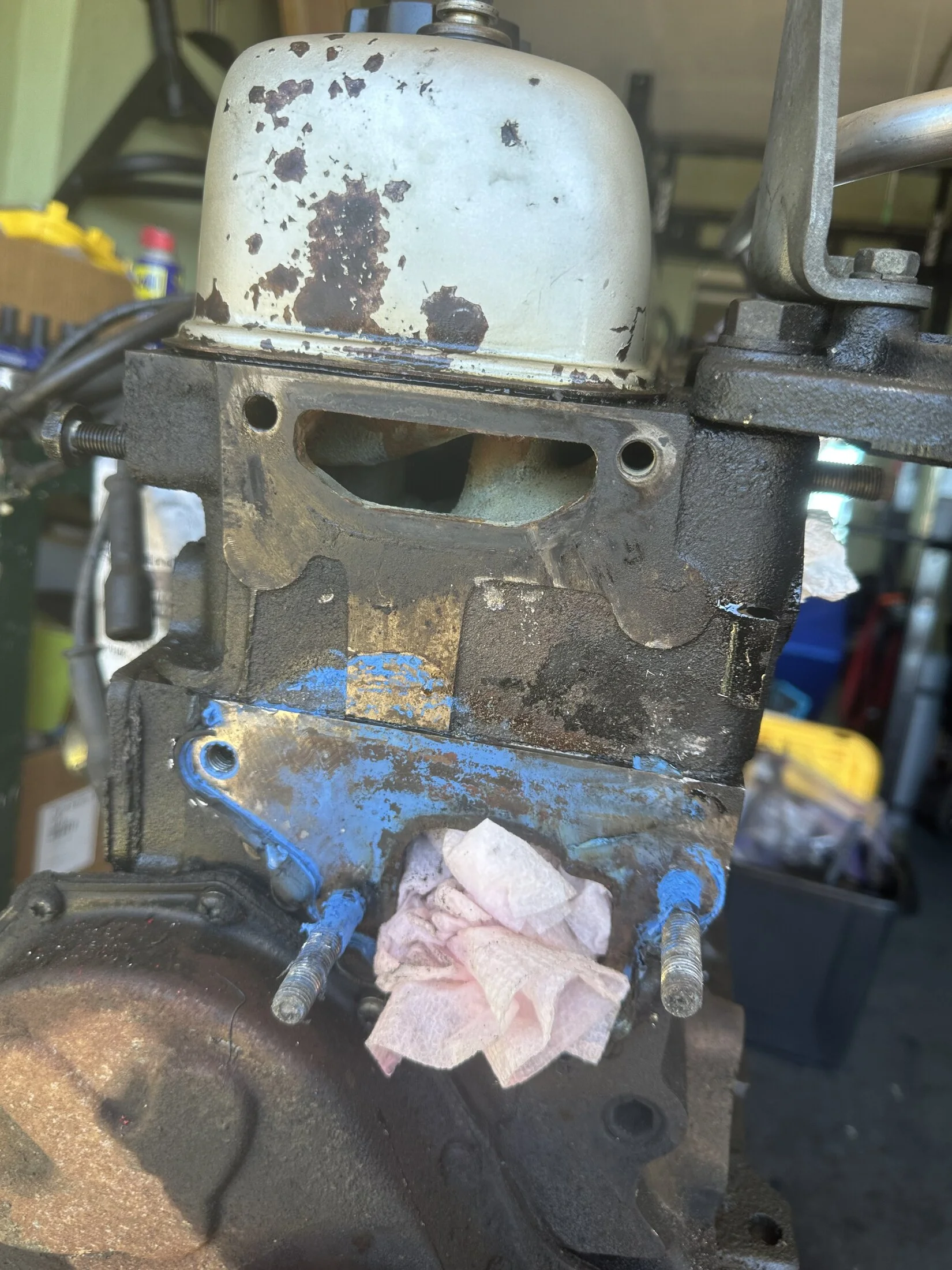

I also see a ton of blue FIPG holding that pump in place when it should only be a gasket (16124-61250). OEM pump comes with a gasket.
You could/should take a brass wire wheel or at least a wire brush and clean off the surface rust and old RTV on the block, same for the stud/bolt threads (or better, replace the bolt and studs with new OEM parts as the original plating will be mostly gone by now). If there's any pitting of the block after wire brushing you could treat it with a rust stop product. Consider also a thread sealant on the stud/bolt threads, just keep in mind to not overtorque the fasteners.
FWIW it would be easier to clean up the block mating surface if the studs were removed first.
Looks like the blue RTV may have been added due to leaks (caused by the rusted mating surface)?? If so you may need to use a gasket sealant just where the block and gasket go together if the corrosion is significant once it's all cleaned up.
Know of a good supplier or website to buy the new water pump studs, nuts, and bolt?
I used a razor blade to get the big stuff today. I will use a wire wheel tomorrow to get the rest of it and then I’ll be able to better assess the condition of the block and threads ect. Thanks for the tips!

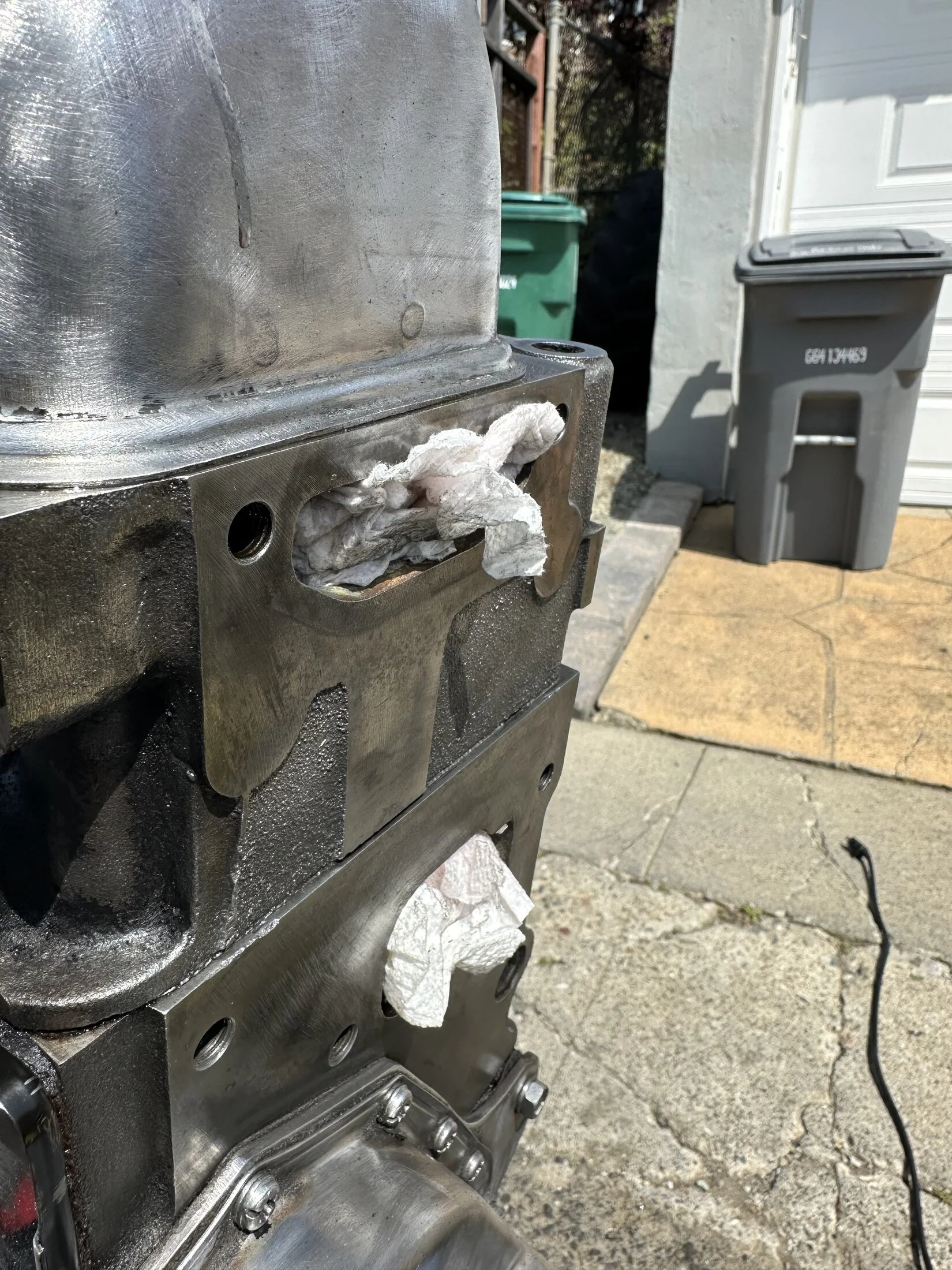

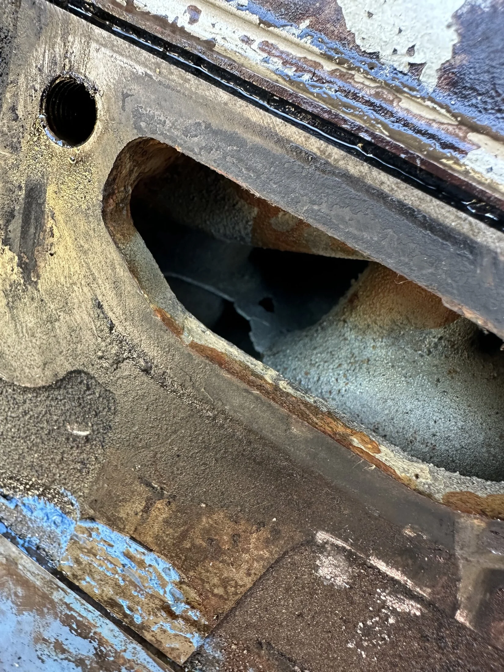

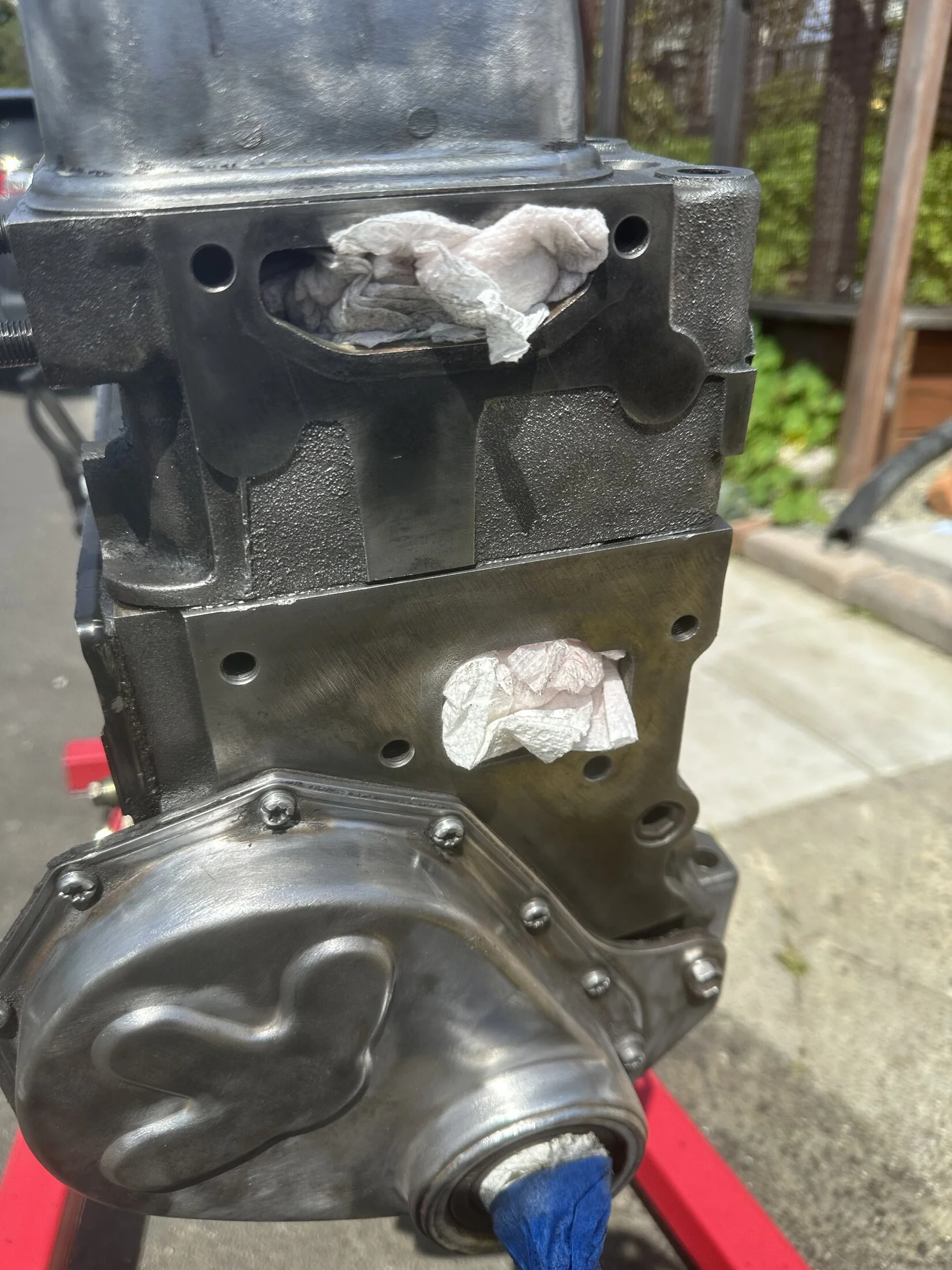

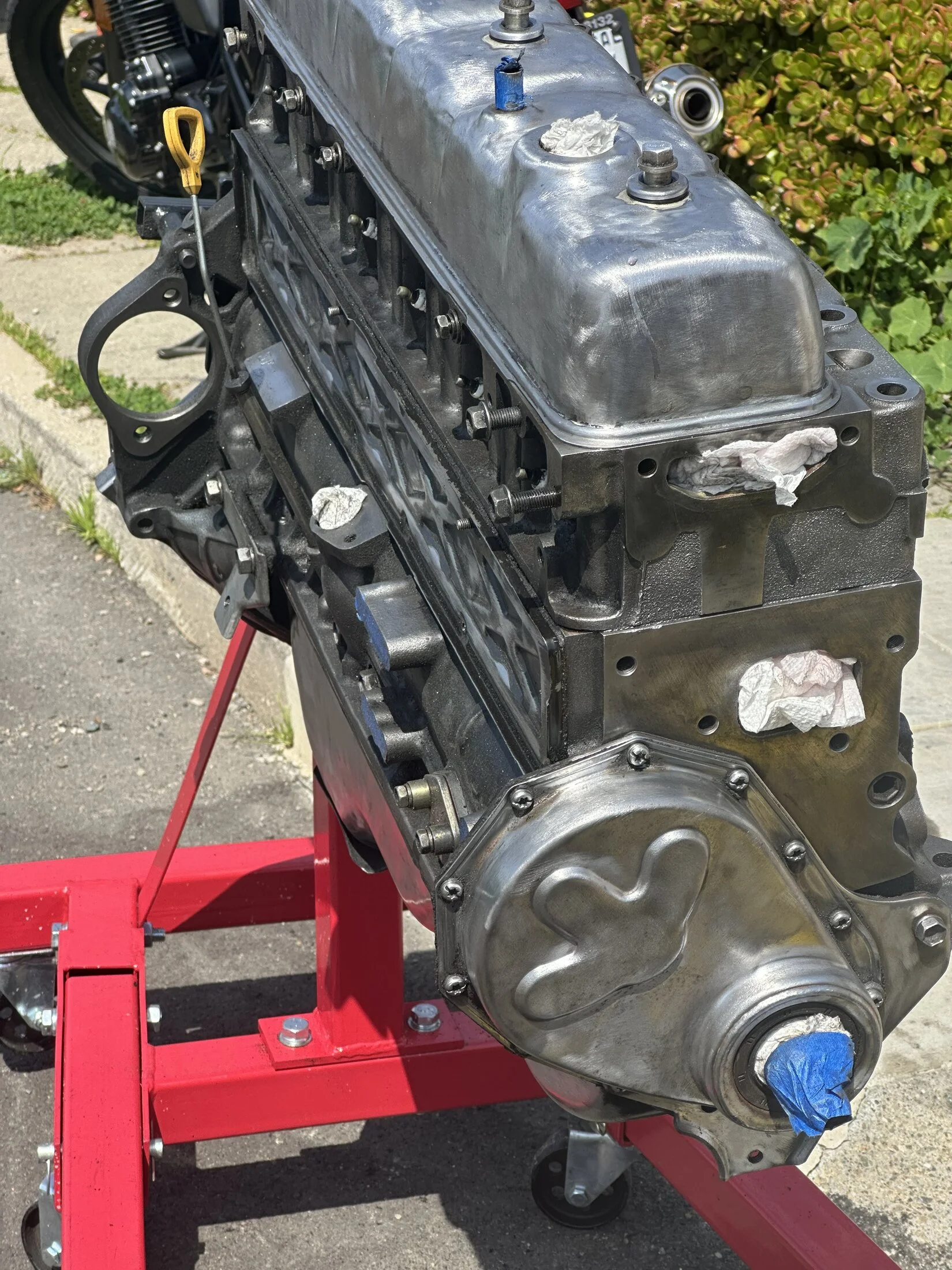

Can anyone tell me from the water way picture above if the head is blown? Looks corroded…. Not sure what it’s supposed to look like. I’m assuming not that?
I think mine looked worse than that.
Very rare to have a blown head gasket on the 3FE.
Sorry! I know my previous question was convoluted. I was asking specifically about the crack/hole inside the water passage in the head. I know my verbiage was confusing implying about the gasket rather than the corrosion inside the front of the head itself.
No, your head and head gasket is fine.
You are seeing casting flashing the may or may not have been removed during its original build.
You cannot see a head gasket from that view.
Corrosion happens inside a cast iron block when water based coolants are used.
It's fine.
When looking at sealants, use "The Right Stuff" by Permatex in black only (not gray). It comes in a Cheez-Wiz can and is expensive, but it's a FIPG , dries quickly, and dies not have cure time like the blue silicone stuff.
Reseal the back plate as mentioned and install the WP gasket DRY. (No caulk or anything else on it.)
"Know of a good supplier or website to buy the new water pump studs, nuts, and bolt?"
If the studs and bolt are still available you could order them from your local Toyota dealer or from half a dozen online Toyota Dealerships that have internet stores.
IME one place to find part numbers, especially for small parts like nuts, bolts, studs, screws, is Partsouq dot com. Go to their website, type in your VIN
then search for that system ie: engine cooling or the associated part itself ie: water pump
If you have set of stud pullers/removers and an impact wrench it only takes a few seconds to remove the old studs however the stud threads will get damaged if you use a puller so maybe buy new hardware first??
Here's one nice Koken stud puller set:
Koken also has some nice stud bolt setter "sockets"
Another set FWIW
FWIW that surface looks like it will clean up nice with a wire wheel, are you planning to rebuild the entire block or??
Here's another thread on this:

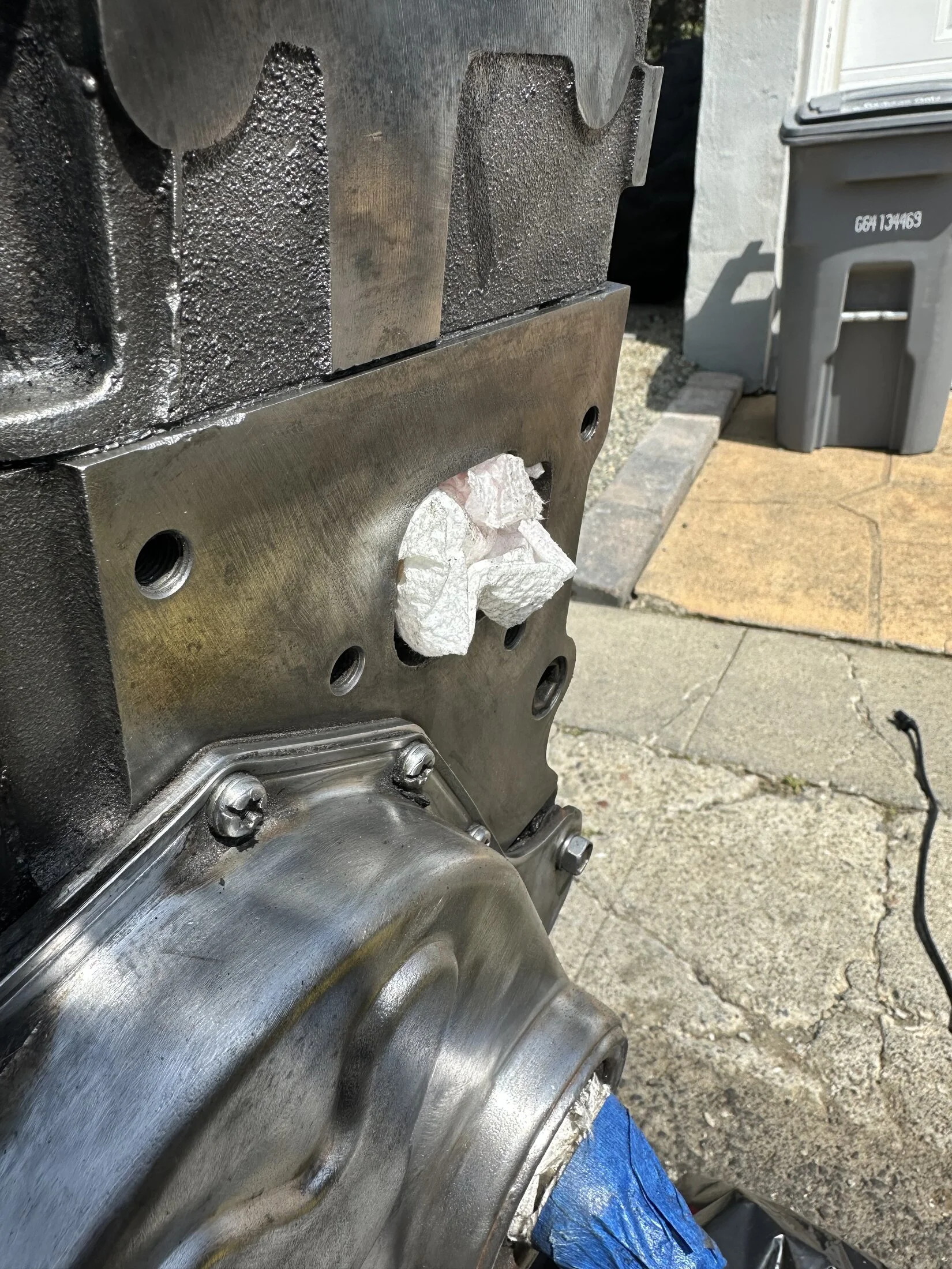

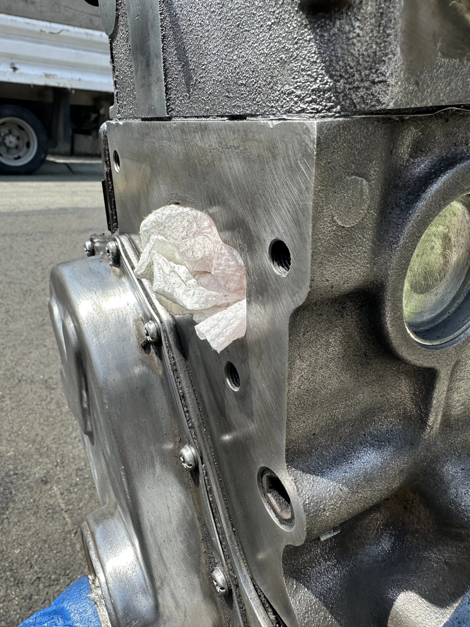

Wow. Looks like you got pretty aggressive with a wire wheel. Likely a gasket alone would do the trick for the water pump. I typically put a VERY light coating of grease on gaskets to keep them in place.
