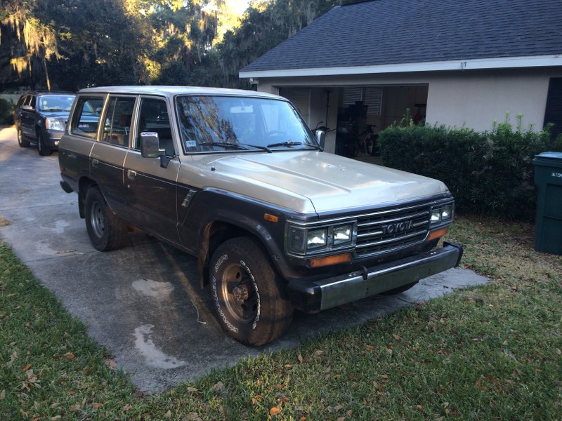

I recently became the owner of this 1988 FJ 62
The seller disclosed that the truck was having transmission problems. The truck will not shift past 2nd. It shifts at about 2,000 RPM from 1st to 2nd but would shift any more past that. Does anyone have any experience with this or general trouble shooting that I can do before major repairs / transmission swap begin?
Thanks
Brian
