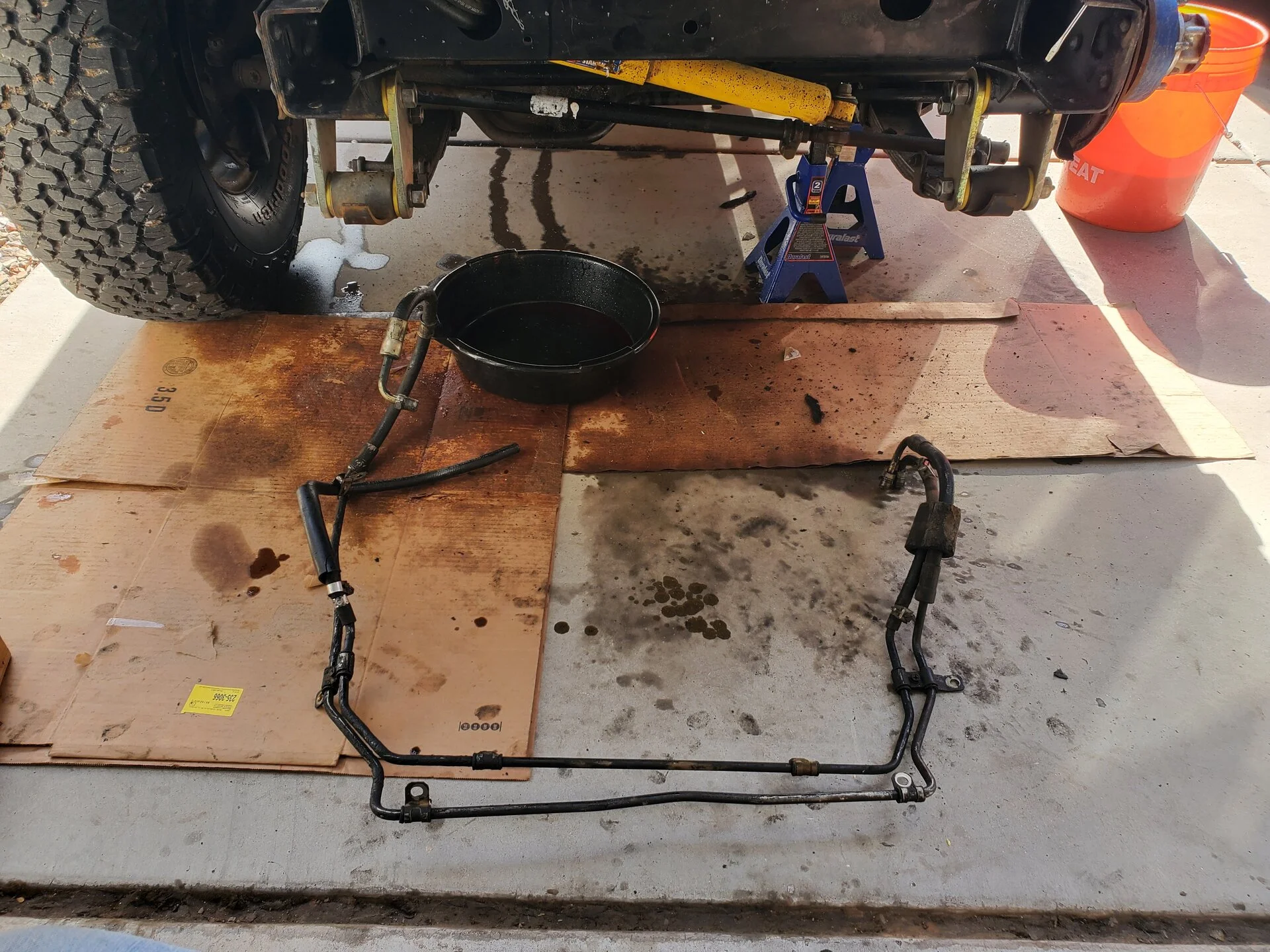

I got a 88jf62. Just got my steering box rebuilt and bought a new steering pump, so i figure I'd replace the steering lines. Got them out unscathed and they look to be in pretty decent shape still. I do already have a Gates high pressure line (from PO) that I could replace it with, and I could easily put new rubber on the return line.
My question is, since the original lines still look to be in good shape, should I take those somewhere to get the hp hose replaced or use the Gates hp line that I have on hand?

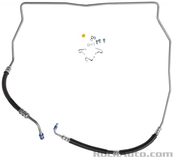

The hard line and hose should come as one piece and be replaced as a single unit. Image of a Gates ps high pressure hose:
Yes, That's the gates ps hp hose/line that I have, as a back up, but I wanted to know if I should keep and install the original hard line(that runs under the radiator) and take it to a hose speciality store that can replace the high-pressure hoses.

Umm, I've got a 60 2f. the cooler line is not connected to the HP hose and there is no hose on the cooler line. If it's not rusting out i'd just live with it. As far as taking the hp hose/line to a shop to have them crimp a new hose...seems overkill to me and those guys that build high pressure brake lines for race cars are going to charge you a ton. My advise is don't bother. BUT....if you are some kind of concourse correct nut job with a mint truck that is 100 percent original, by all means go for it.
Unless your talking about the cooler lines that run under the radiator?

I should've attached this in the initial post. No rust. Not bent out of normal. Took it out as careful as I could. Like I said, just wanna replace the rubber.
