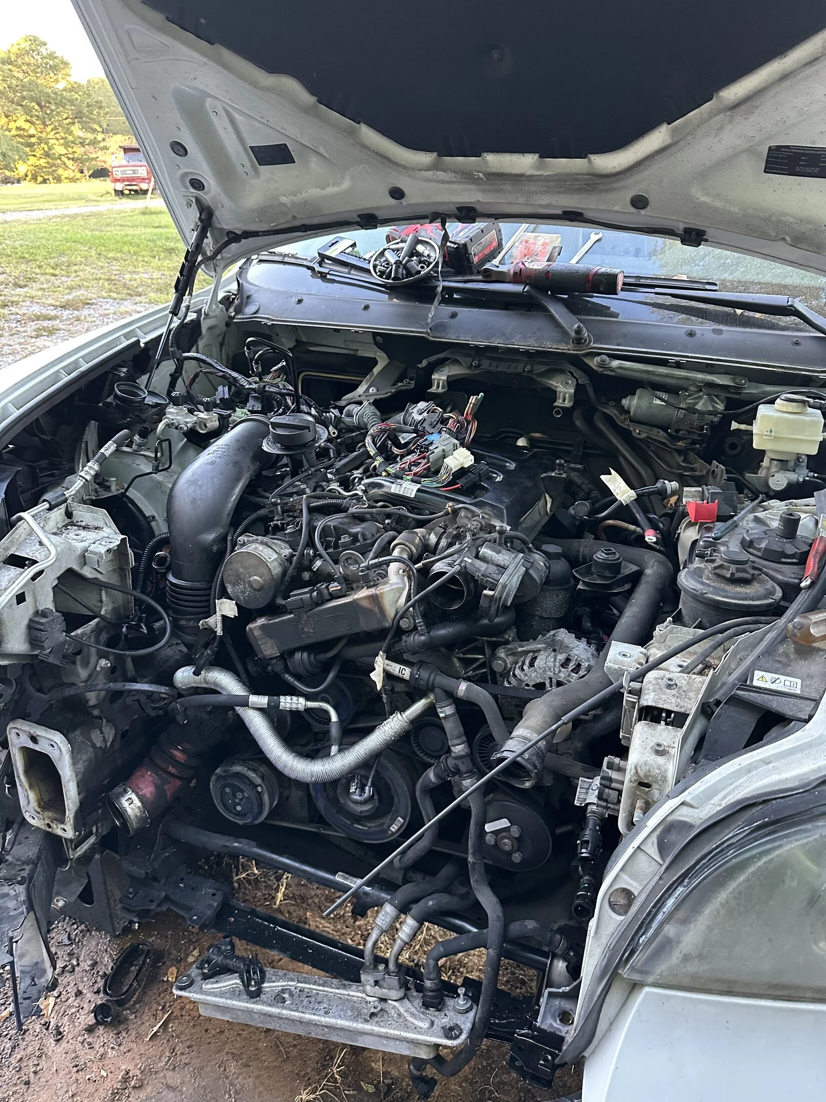

After letting it sit on jackstands in the shop for a few months contemplating what to do with it. I was eager to figure out what power plant to drop in it. Then one night a low mile 2012 BMW X35D popped up on Facebook marketplace and at that point I knew what needed to be done. M57 swap.
I reached out to the seller and within 24 hours I had the X5 in my possession from middle Tennessee. Checked the codes that it was throwing and it was all DPF and SCR emissions related. I knew I struck gold when it fired up with a fresh battery and was able to drive it on the trailer. I got it back home and began stripping it of parts to list on eBay to recoup some of the cost of the donor.

At this point, the original 3fe is out of the 62, the donor engine is out of the X5, and I’m waiting on the engine and transmission control units to get shipped back to me.
At the time of writing this post, I will begin maintenance on the donor powerplant this week and begin designing engine mounts for the 62 using 3D scans and cad.
