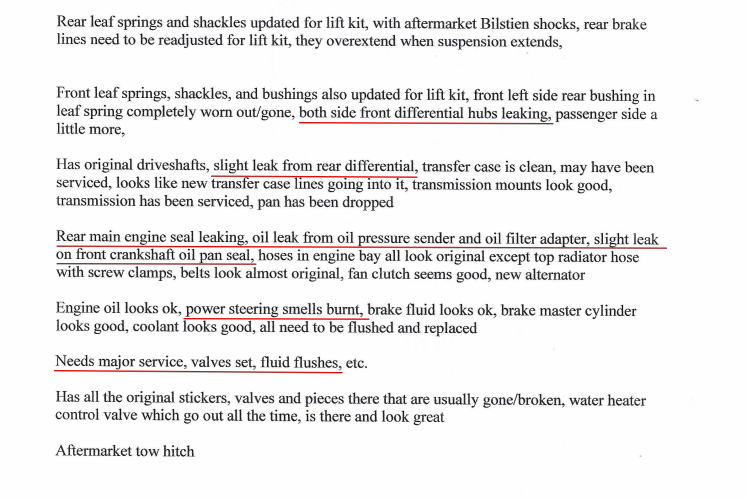

The seller gave me a list of inspection notes from their mechanic. Some of the things mentioned are:
With 190k on clock, I'm expecting it to need some work and I'm OK with that. Given this list, does anything stand out as a larger potential problem?

Differential hubs??? I guess the mechanic is unfamiliar with the knuckle set up on 60 series. Sounds like a new knuckle job is needed.
New transfer case lines going into it. The only line going to the transfer case is the speedometer cable, so not sure what lines the "mechanic" is seeing here.
Rear main seal leaking. Probably not. It could be a leak at the rear of the valve cover or more likely the oil pan gasket.

At that price it should be flawless...... The list of mechanicals you gave is more like a 20-30k car.
A new power steering pump and replace having shop do it is about $800. Front main seal timing cover is about $630 shop price. Valves adjusted and seal on valve cover is about $320 shop price. Just some prices for you. This is what I paid to have some of these things done. Front knuckle rebuild is done on the forum all the time. Some are not hard to do.
You really need to preface here that this is a 62 with an asking price of $70k. I saw your mechanic reports and was thinking "no big deal". But for $70k. F that.

Agree with the above. Overpriced. The oil leaks that baby has will be very costly to fix. Not too many mechanics want to work on these trucks, at least not for a bargain. I would look elsewhere.
