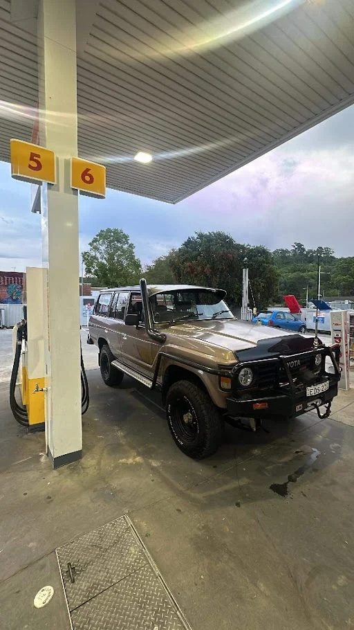

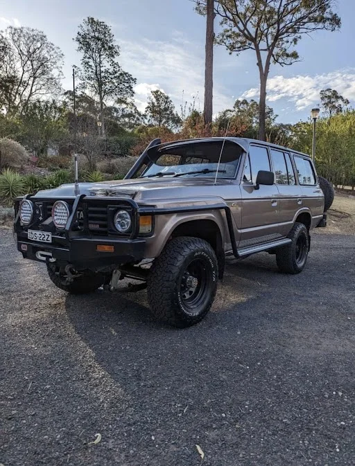

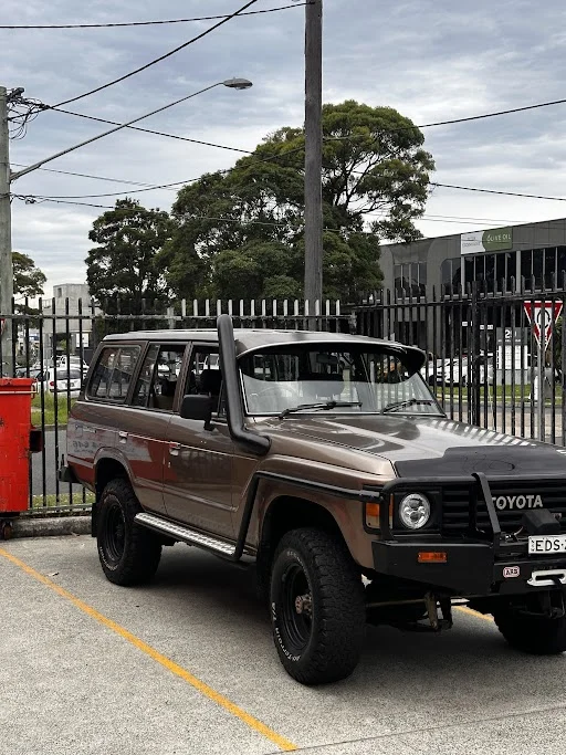

Oh, yeah, here's some photos of the old girl - taking name recommendations
