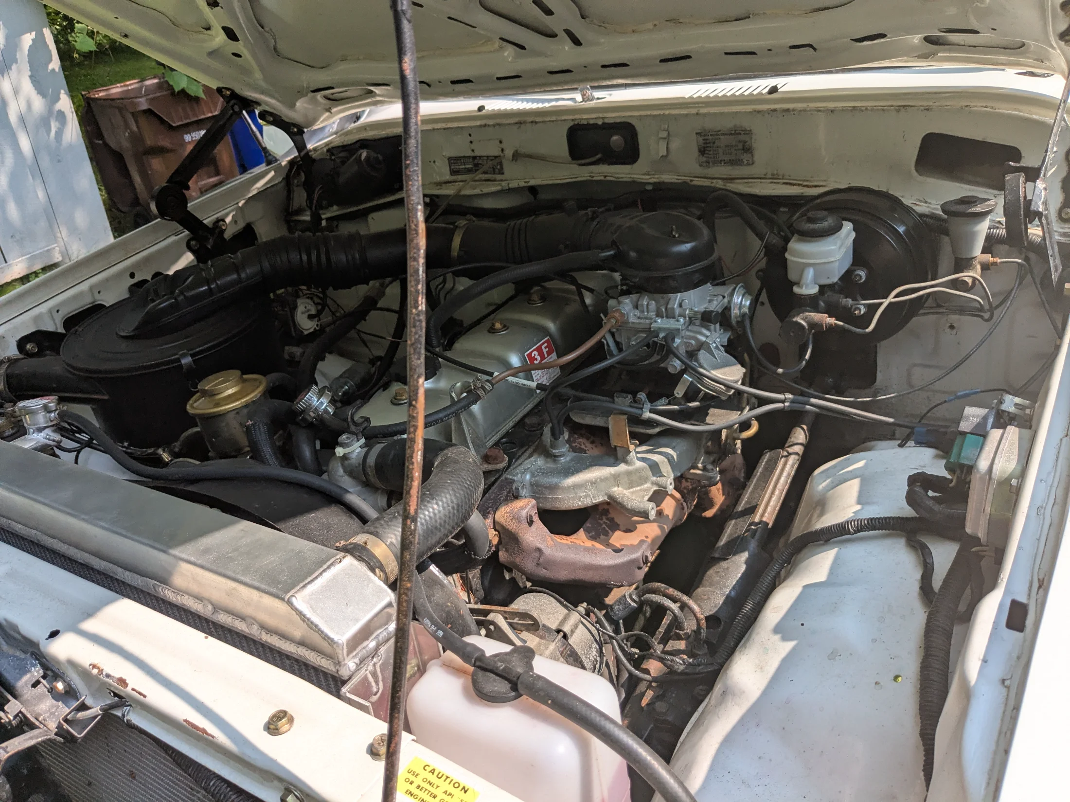

Needs a few things like power steering pump, a look into a pretty sloppy h55f and a few rattly dash pieces.
Pretty cool see 3f carbureted, with no secondary air inject or vacuum pump. It has electronic ignition and constant vacuum system leading to the carb.

first thing you need to fix is the fuel line feeding the carburetor. That NEEDs to be a metal tube. Anything else is a fire hazard. (Rubber hose with fuel pumping through it, pointing right at an exhaust manifold!)

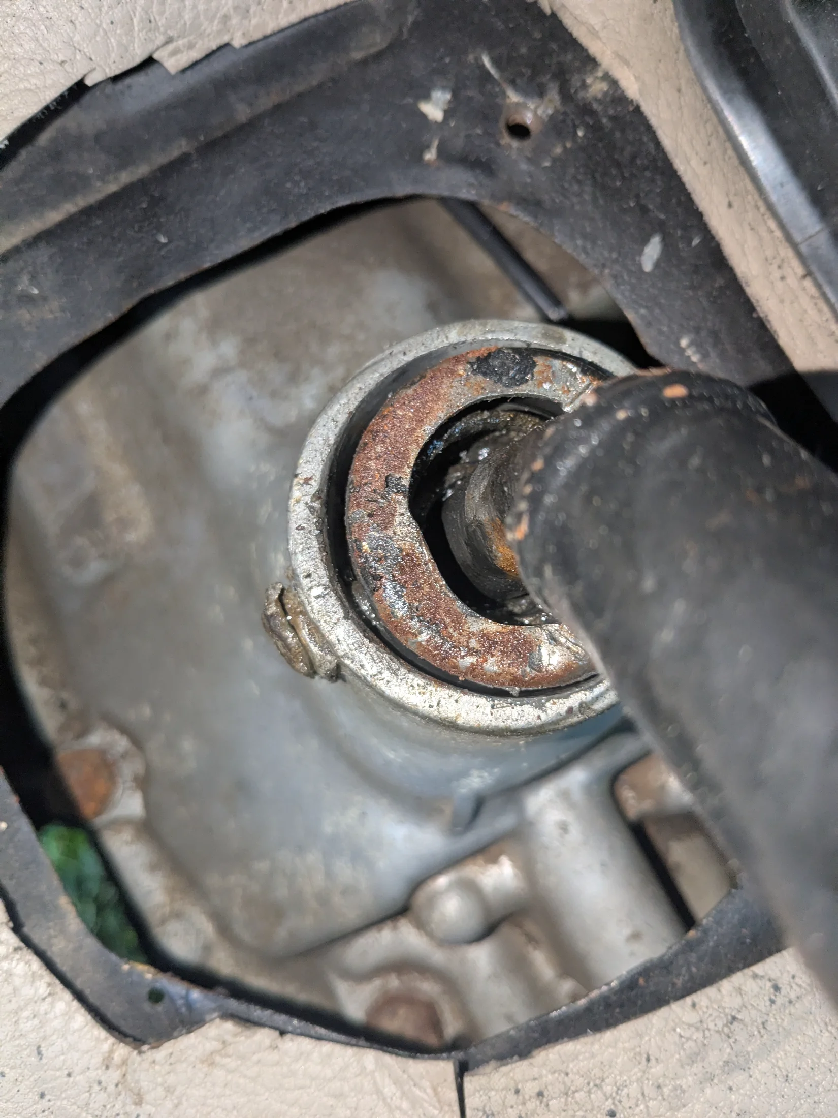

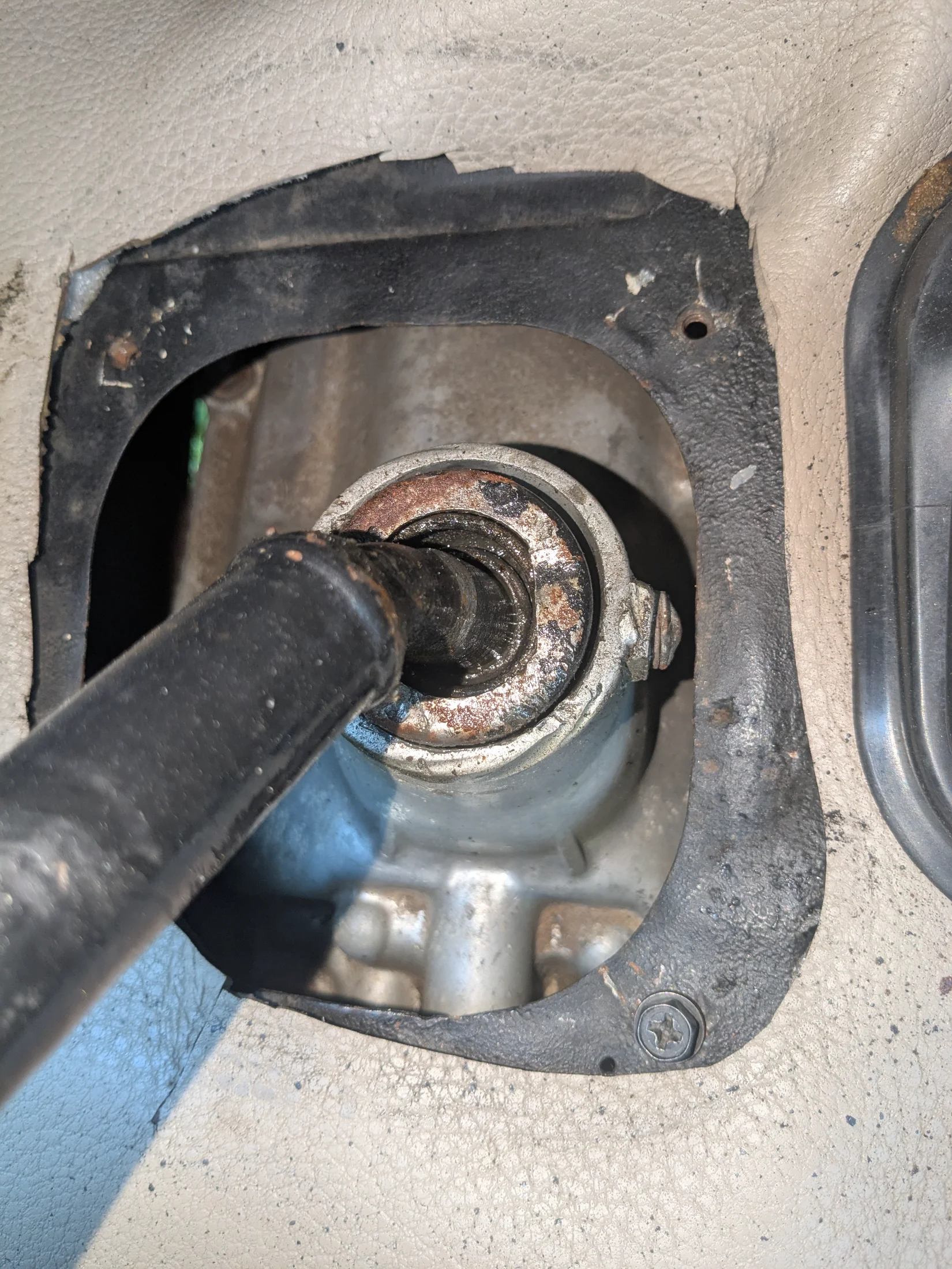

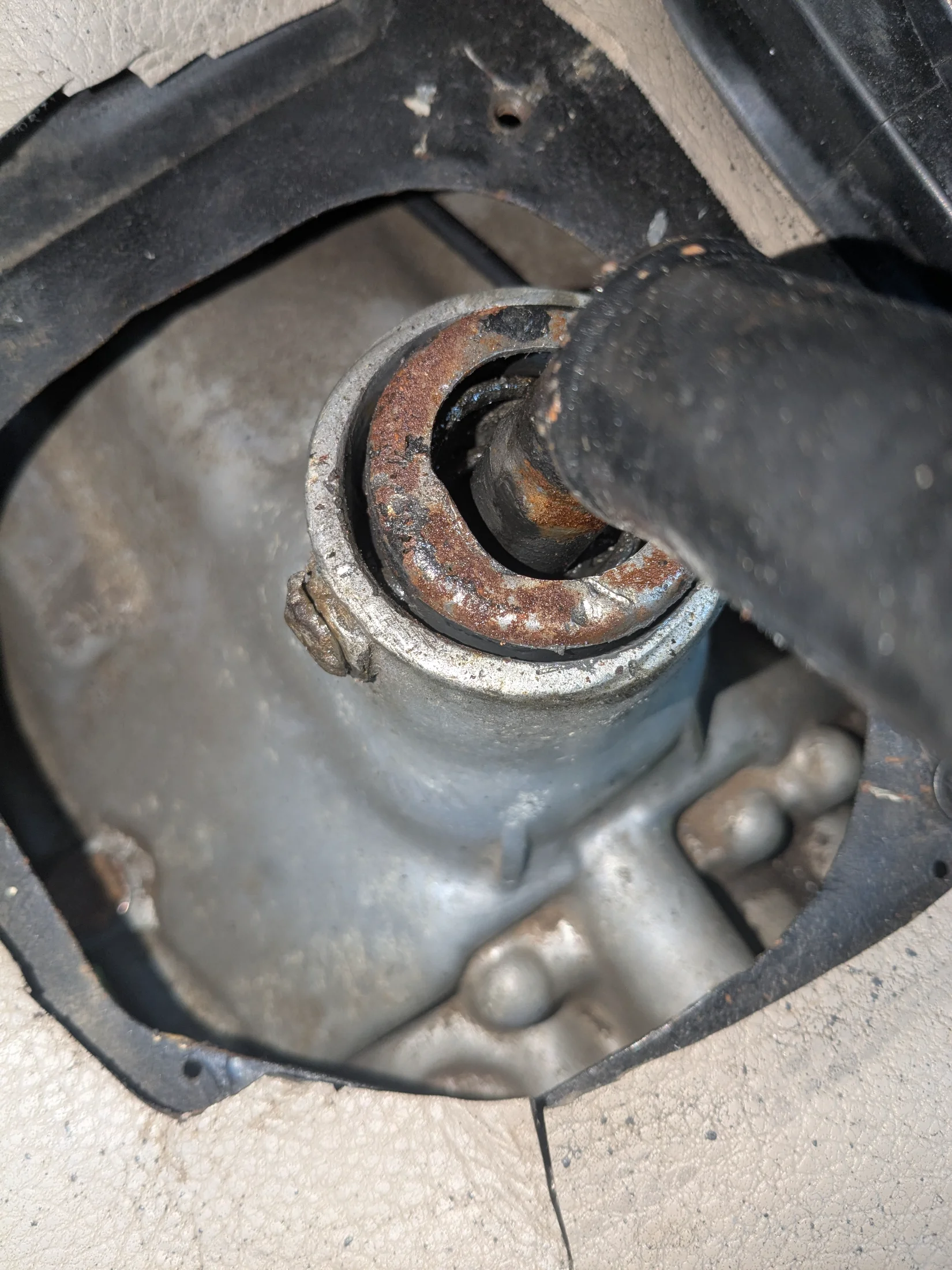

As far as h55f manual gear box? Any idea why the throws are sloppy? Linkages or bushings? Also noticed at speed 4th gear grinds, but at low speed doesn't. Syncros going out? Thanks a lot

For the shifting, the first place to look is the shifter handle bushings. There are two of them - easy to replace (I have both in stock). Remove shift boot, remove shift handle, and you'll be able to see them, or they might be disintegrated.

What you want to do is twist that cap off and you can pull the shifter handle out and see the bushings. It's possible you may need to replace the shifter handle too if things are too beat up. Fortuntaly they are readily available new too
Quick question I don't have the transmission cover plate. Since this is an fj62 with h55f, would fj60 one fit?

Are you asking about the rubber boot that should be over that? It is the same part.
Your vehicle most likely came from the facotry with the H55f. Just becuase it is an FJ62 doesn't mean it can't have a manual transmission, in fact most of the rest of the wrold got the H55f in FJ62. Now for buying parts in the US, +85 FJ60 would be the right "set" of parts. I should have pretty much all that stuff here as well

Thanks Matt, I meant the metal plate.

That would be the same part as on a USA FJ60. Yours is there, you can see the threaded holes for the shift boot

As Matt said, it's a dual rubber boot. The outer one should have a metal ring to secure it down.
