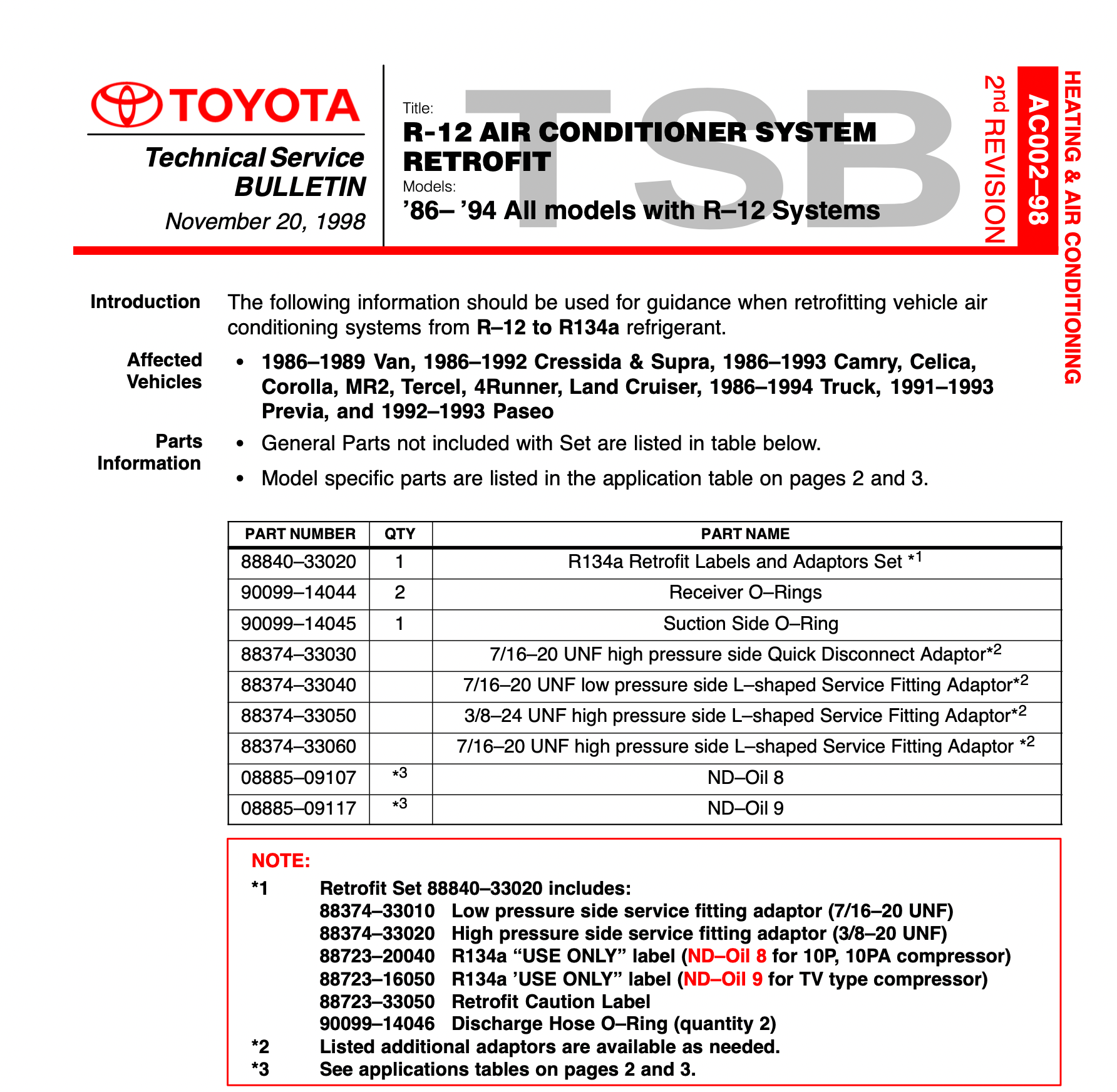

No change in compressor required, just drain the old oil and refill with new.
Reading this thread as I'm preparing on a conversion project before it turns to hell in SoCal. Can someone confirm that you have to get a new compressor in order to convert to r134a? I was going to just order off most of this parts list...
According to the TSB don’t. You can leave the compressor right in place. I added the recommended amount of PAG 46 oil (100ml) to the low side of the compressor while I had the hoses off. I replaced the evaporator and everything in the cooler box (pressure switch and expansion valve). I ponied up the bucks for the expansion valve from Toyota ($95). The evap and drier are Denso, pressure switch and o-rings are Four Seasons, all from RockAuto. Bought the retrofit valves and valve core remover (for the old valves) from Oreilly. Kept my condenser and compressor. Flushed the condenser and lines just to make sure they were clean. Very little debris came out of them.

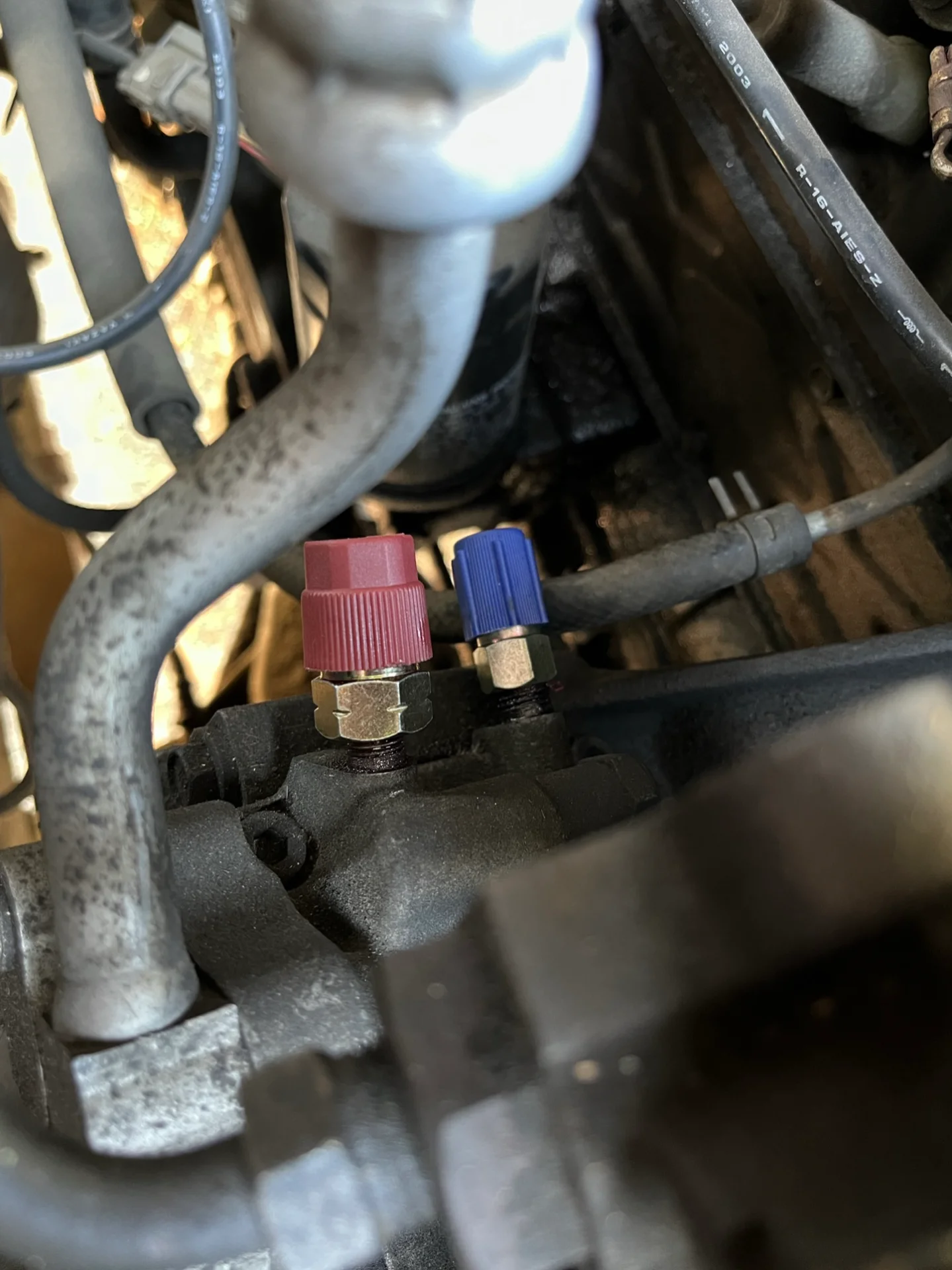

@dogcruiser Thanks for the recommendation on the adapters!! Just wanted to get month update and see how the AC is holding up since you converted. Also, noob question here, but I'm in the middle of my conversation this weekend and wanted to confirm if my adapters were on the correct positions and if they were supposed to screw al the way down. Here's how mine looks:

@vankho I hadn’t even noticed that before but mine looks similar. A couple of threads showing. Just make sure you remove the cores from the original valves before you screw the retrofit adapters on. And a couple drops of red Loctite to keep them secure.

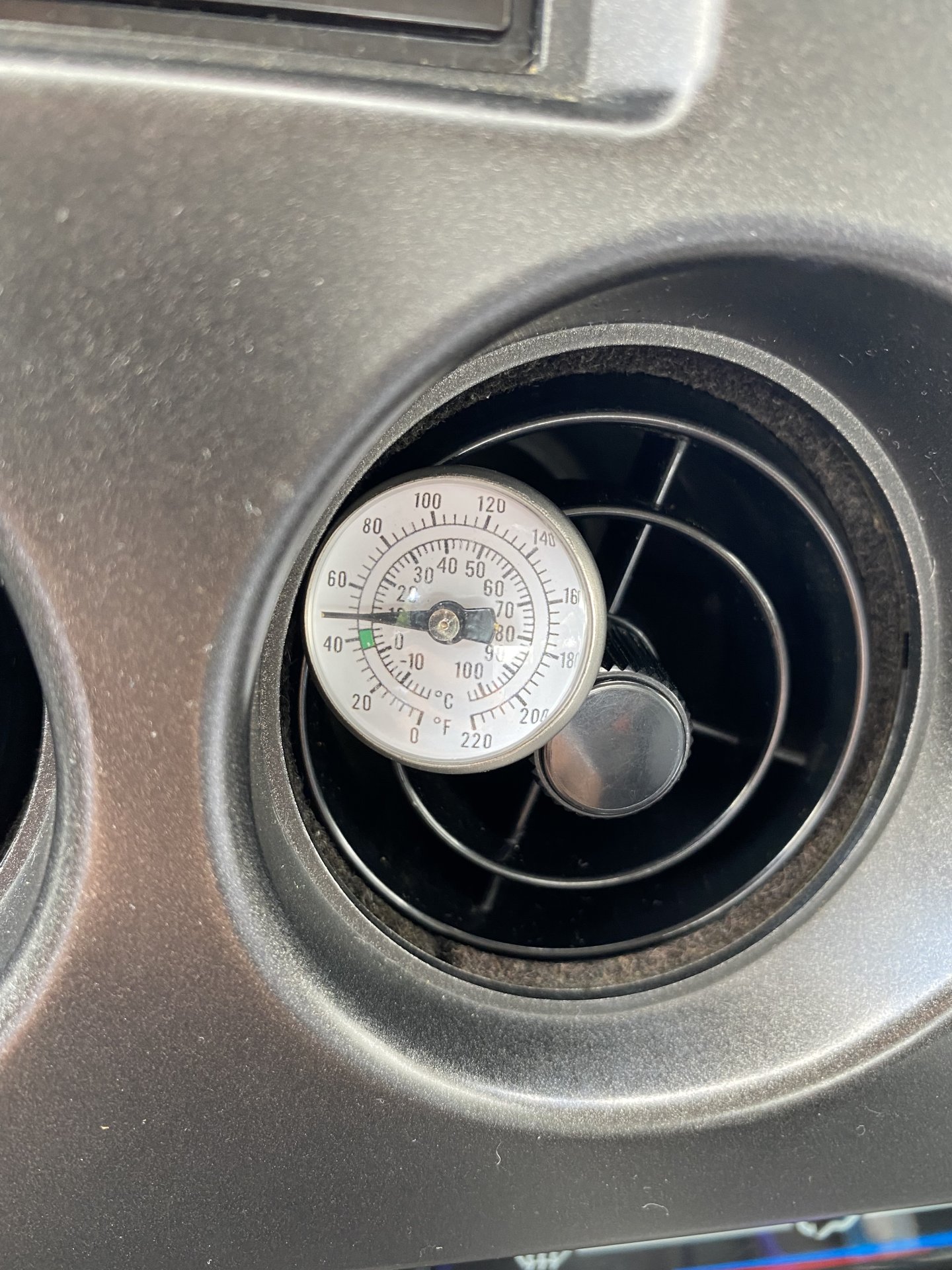

Overall the system has been working great. I probably only have 100 miles on it since doing the AC work but it blows colder than I expected sooner than I expect, even holding its own while sitting in traffic on a humid 95 degree day. I keep the thermometer in the vent and the vent temps are typically in the mid 50’s, or even colder. The photo below was taken at a stop light at 2pm last week. Of course on a hot day it might take a few extra minutes to get to the coldest temp but I have no complaints.

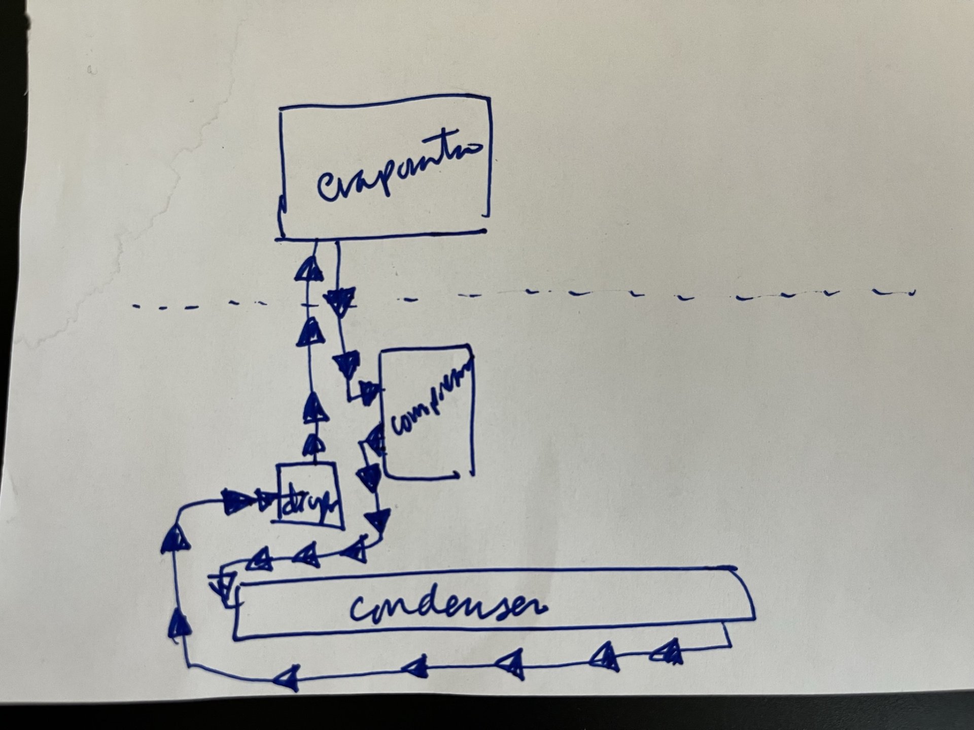

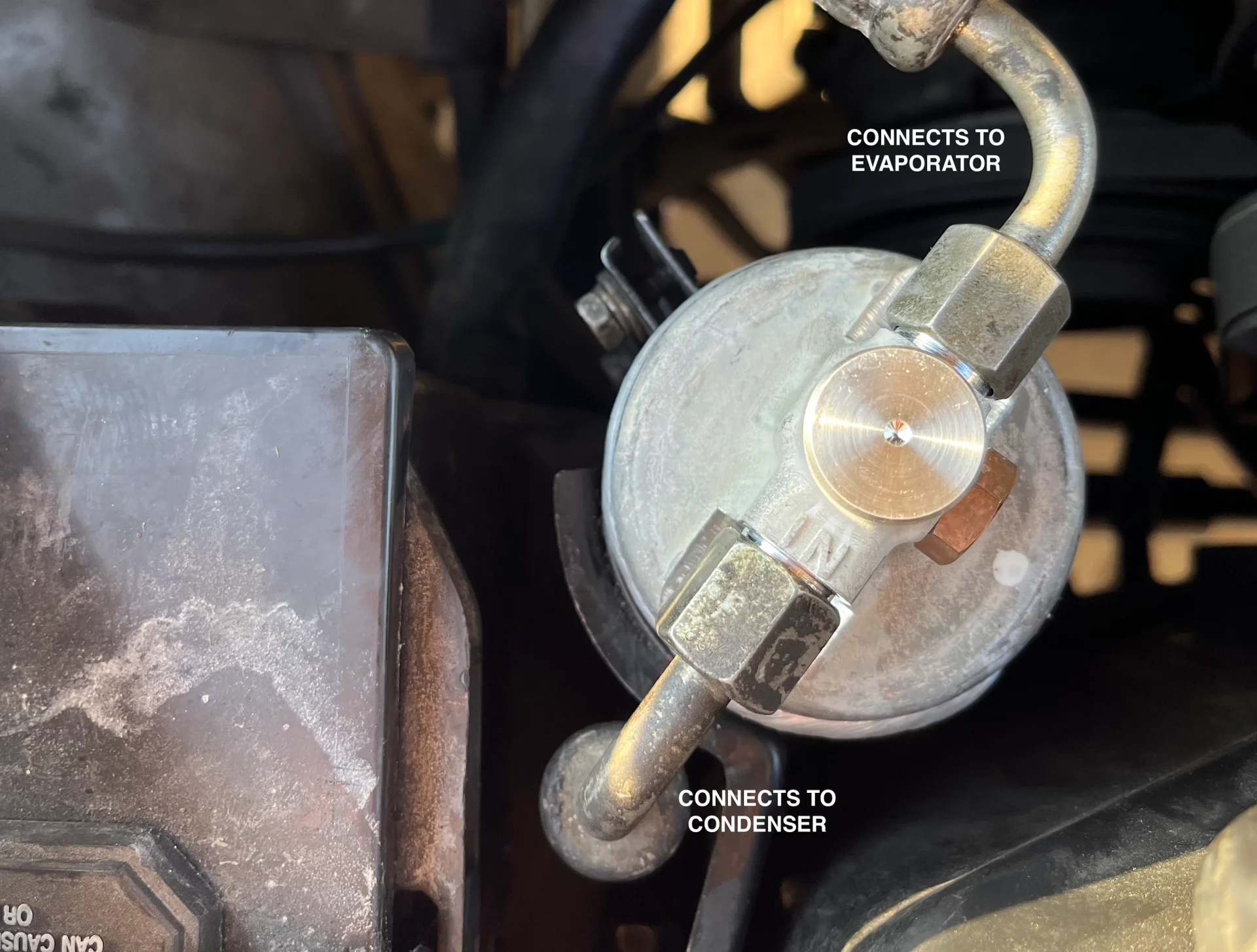

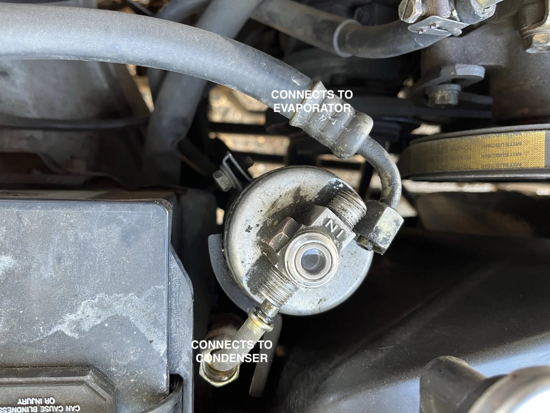

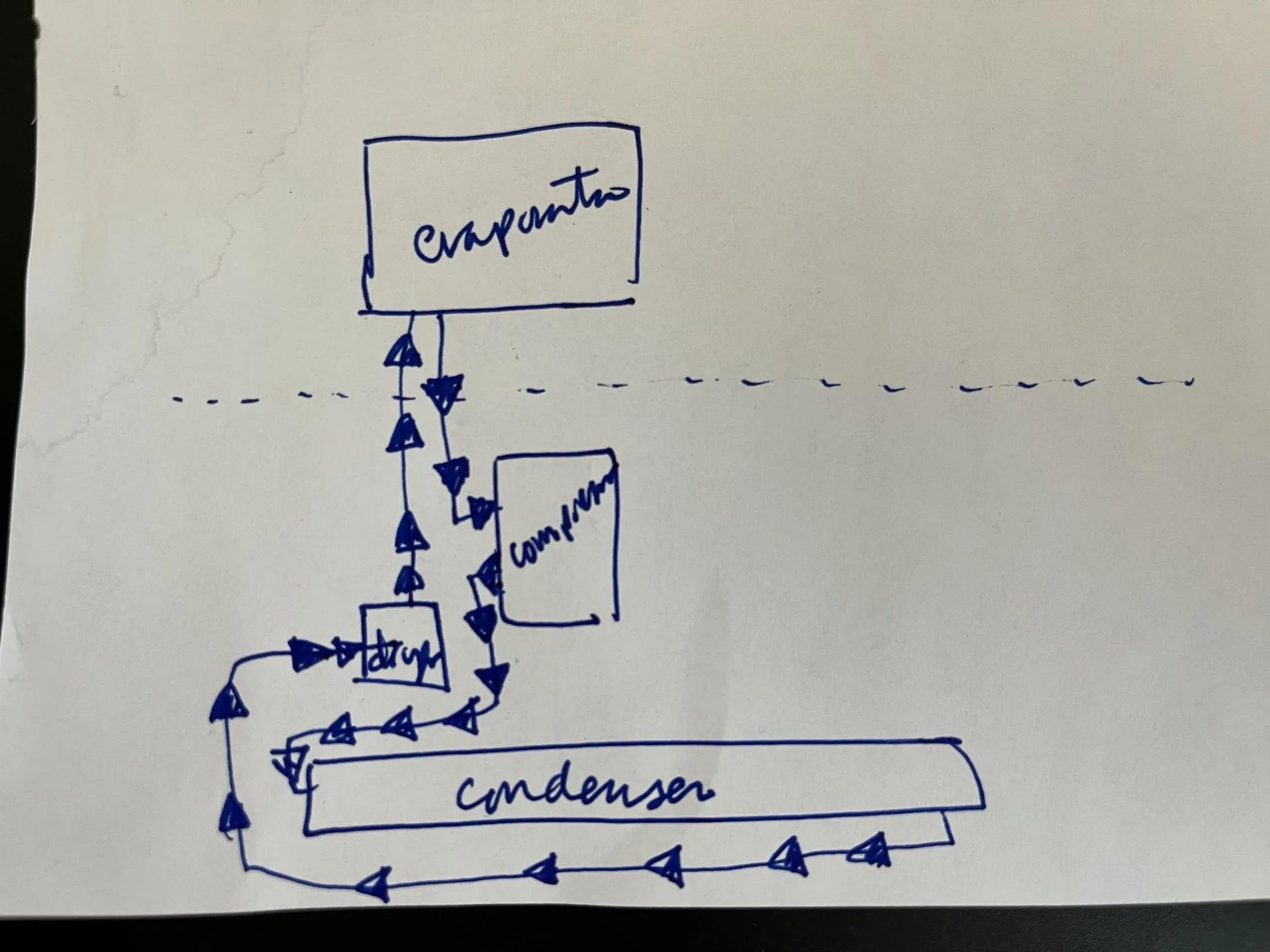

Had a brief moment of pause during my r134a conversion with the receiver/dryer. Can anyone confirm it's orientation? The old one (w/ sightglass) had the hose going to the evaporator connected to the "IN" value. Note that I have it flipped around in the new dryer. Based on the illustration in the FSM it's suppose to be the condenser? Just want to be 100% before pulling vacuum and getting the refrigerant in! Do I have the flowchart correct?
