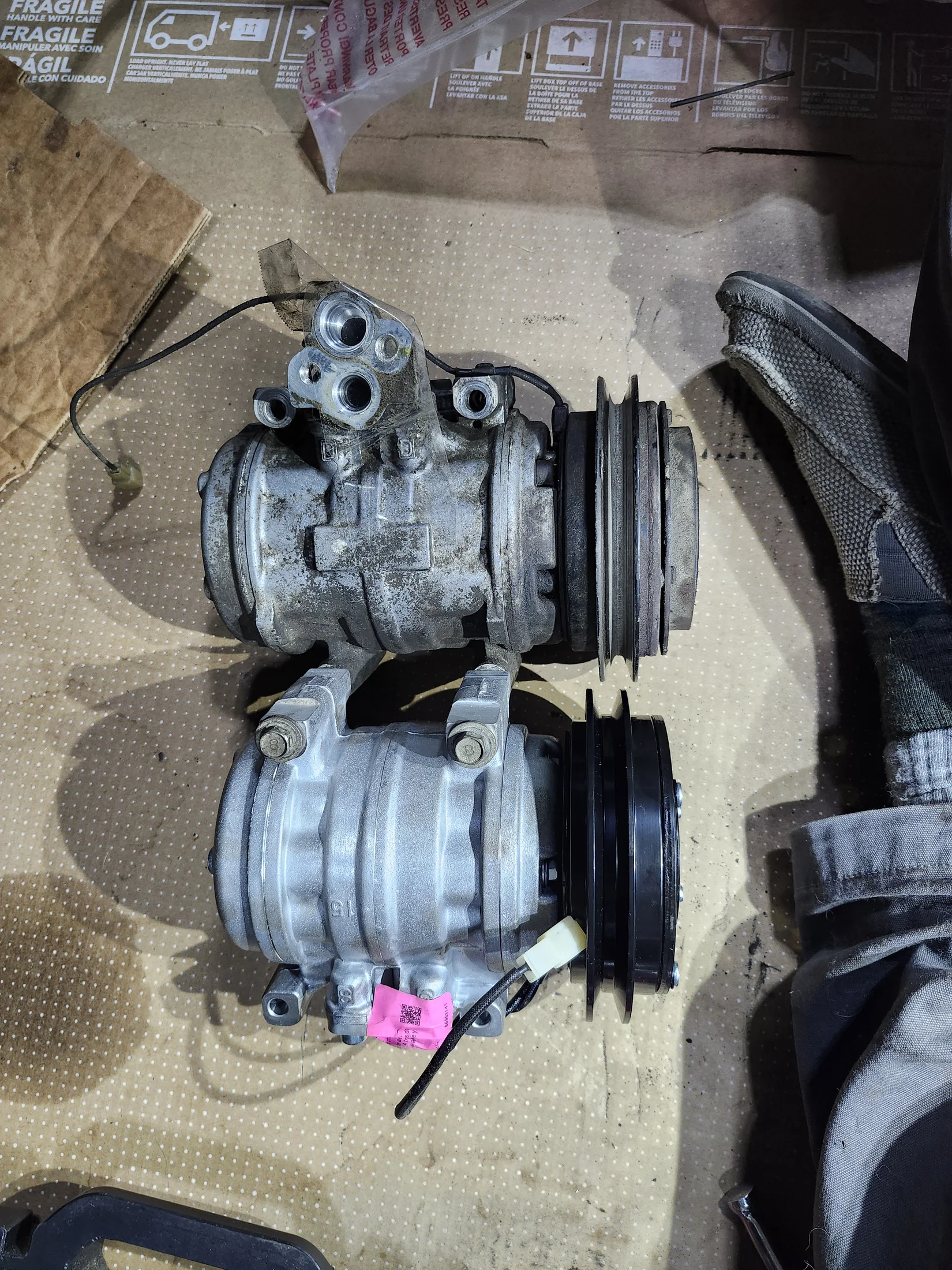

So I got a 68302 four seasons compressor like the original poster but definitely not the same pulley. Reason I'm replacing is because the clutch appears to be toast and it doesn't look like I can swap the clutch and pulleys. Am I missing something? Mounting points match up as does the face of the compressor housing, overall significantly shorter housing.

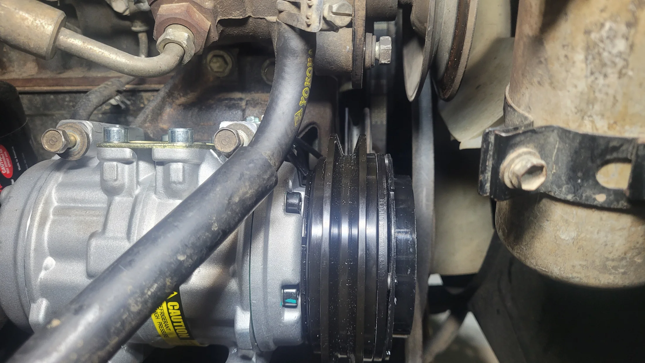

Got the new compressor from curiserparts.net and similar, albeit less,offset. Are the pulleys at all adjustable? I feel like I'm going crazy, its offset like 1/8-3/16 from where the idler sits, theyre on the same bracket so its not like i can adjust the bracket right? Am i missing something?
So I got a 68302 four seasons compressor like the original poster but definitely not the same pulley. Reason I'm replacing is because the clutch appears to be toast and it doesn't look like I can swap the clutch and pulleys. Am I missing something? Mounting points match up as does the face of the compressor housing, overall significantly shorter housing.View attachment 3966995
What model of compressor did you receive?
Also, what year is your FJ62?
My November 1989 built 3FE has a different compressor than the earlier years if I recall correctly
I've got an Oct 1987 fj62, the compressor I got from cruiserparts.net appears to be a remanufactured or very close copy at least of the housing.
It was labeled (471-O432-R) on the website but the part is marked ST2503UL
