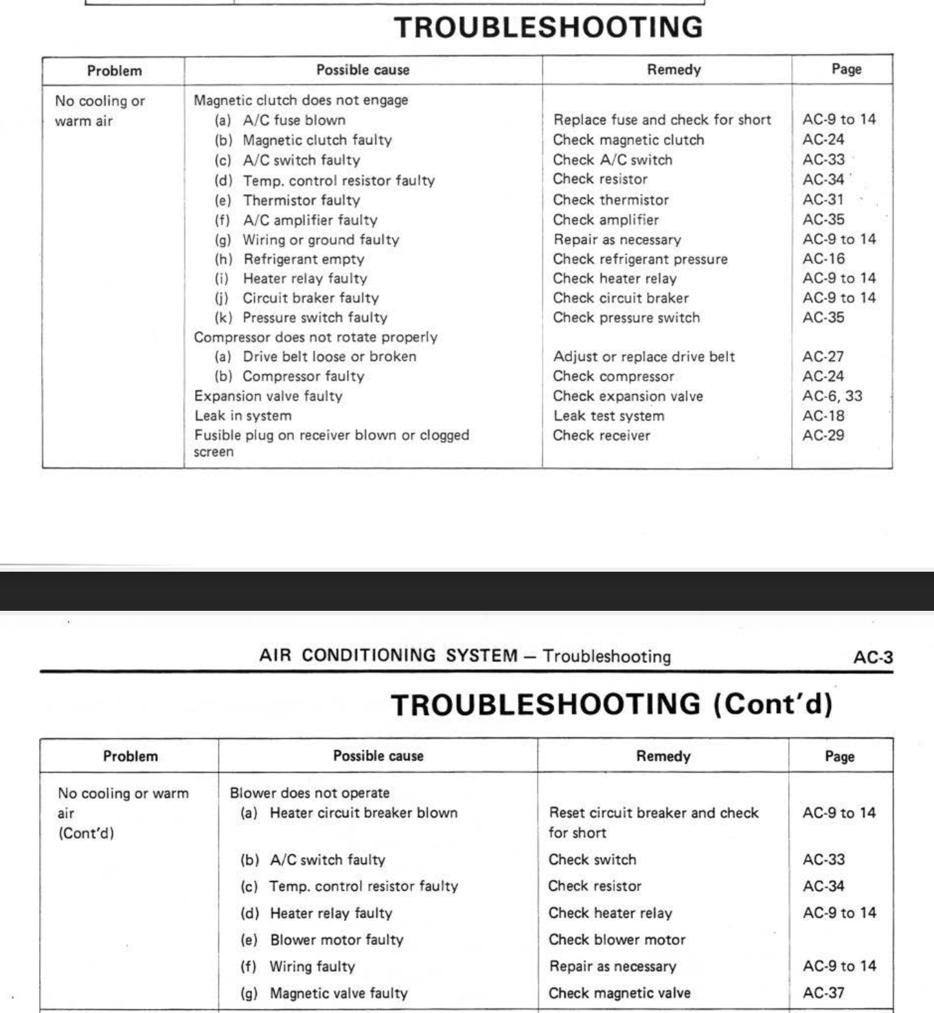

Small update, but the investigation continues:
I hooked up the AC compressor directly to battery and was happy to see that the clutch engages and spins accordingly. When engaged however, it still doesn't really blow cold air. I suspect I may not have enough refrigerant. I'm relieved that I may not need to get a new compressor? Need to get a multimeter and go through all the AC wires though. My hunch right now is that it's either the AC Switch (as the light doesn't come on) or the pressure switch itself, which I hope isn't it because I have to empty the system to replace it correct? Going to make my way through the FSM Troubleshoot list...
Yes, you’ll have to empty the refrigerant to replace the low pressure switch. Hoping that’s not it.
Definitely check all the plugs under the dash. I had the exact same issue (no AC light, no compressor) because I missed a plug or it was loose. I don’t remember now what the cause was but it was a simple plug related issue once I located it.

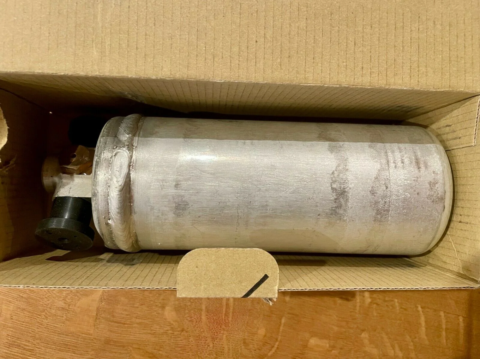

I know there’s talk about the R-134 drier not having the window on top but the Toyota TSB mentions that there is and to use a black marker on the window so you aren’t tempted to look at it and mistakenly think that cloudy is bad. I don’t believe there’s any difference in the guts of the drier, though I could be wrong.
that refers to the TOYOTA Genuine Part
not the $20 denso one ?

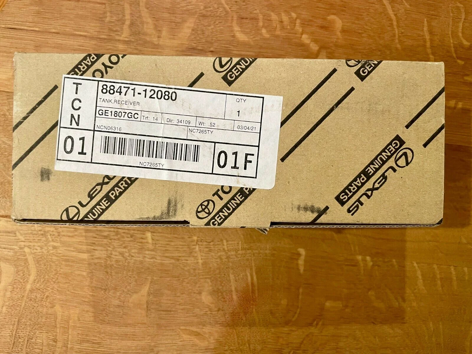

FWIW, I emailed Denso Technical about the stock R/D being used for r134a and the tech responded that the stock R/D will work with R134a, but didn't know what the desiccant was. I went with the one in the TSB recommended for r134. I asked for the Denso part # for the one in the TSB, but that was not supplied. Rex @1972FJ55 who is an HVAC pro, posted in an older long-forgotten thread, the stock R/D was no-Bueno with r134a and I believe him.
The R/D 88471-12080 (TSB) does not have a sight glass.
