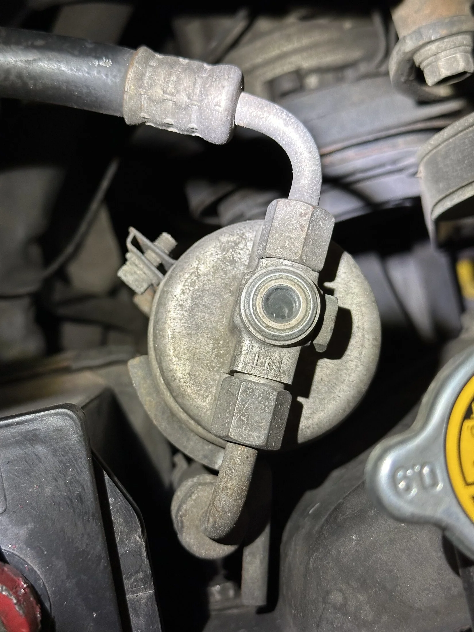

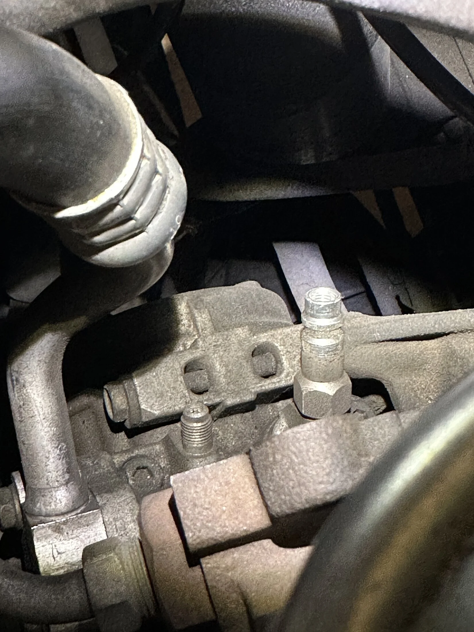

Evening,
1988 FJ62… based on the attached photos, is this R12 or has it been converted to R134? I’m guessing still R12… but what do the educated experts here say? Thank you in advance.
-Tom
Based on the OEM receiver/dryer, it looks like R12. The Toyota R134a retrofit includes a different receiver/dryer that lacks a sight glass. Same with a conversion that uses an aftermarket receiver/dryer.
How about those fittings though… is one of them R12 and one R134? 🤷🏻‍♂️ Thanks!
I've read that some conversions use the OEM receiver/dryer, which isn't correct per the Toyota documentation.
Not all of them, I have a R134a dryer that still has a sight glass. The easiest way to tell the two apart is their size, R12 driers are bigger in diameter than their R134a counterparts.
@DuxTom It looks like your truck has been converted to R134a since there is a conversion fitting on the low side of your A/C compressor.
…134a since there is a conversion fitting on the low side of your A/C compressor.
Thanks @yotadude520… kind of what I was thinking, but shouldn’t there also be a conversion fitting on the high side as well!? Isn’t the present threaded high fitting the OEM R12 fitting? Thanks to everyone for guidance here. Plan to run the truck by an old school AC shop in the next few days and hopefully clear things up. -Tom
I wouldn't say that's a 100% indicator... I just recharged my system with R12, and used an R134 quick disconnect on the low-side to fill it up with R12 because my vacuum pump/fill kit used the QDs. YMMV
I’d say you are correct. It is probably still R12. The “R12 compatible” refill cans come with that adapter on the low side only. If it was a proper R134 conversion, it would have the adapters on both the low and the high side. Just reading this thread while my system is hooked to a vacuum pump.
Correct, connectors are just connectors, they don't guarantee what you have in the system. it's all about the manifold gauge compatibility. it's what you connect to the other side of the manifold Gauge is what counts. R12 or R134.
Only the Low side was put on as the High side 3/8 -24 UNF converter is HARD to find. Also please note that the Bulletin quotes 3/8-20 UNF, which does not exist. Assuming this was an error in the bulletin.
bought this thing on Amazon... unfortunately both high and low were 7/16-20 UNF, but like the TSB stated, they need to be 7/16 and 3/8...
