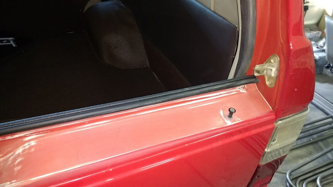

Well on this hose test I was able to get some water in around the top of the rear passenger door around the weather stripping. Do they still make the door seals?
