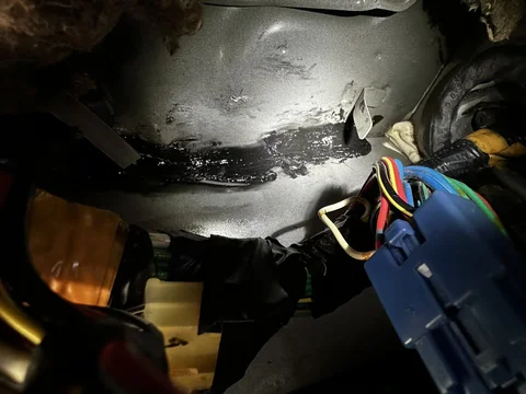

Well, I finally found the leak source this weekend, behind the drivers side kick panel.
The inner seam close to the cowl drain pipe was missing a sealant bead entirely, so much so that you could barely see daylight getting in. My guess is this is normally not a failure point, but given the collision evidence by the dented in cowl side, I think it likely was never repaired correctly in that repair effort. I had to remove one the of fuse panels, disconnect the pull handles, and peel back the NVH padding for the firewall to get to the spot. It's hard to exactly line up where this internal seam is for the outside, but my best guess is the bottom of the drain curve for the (now missing) hose pipe.
I did a duct tape job to test a leak fix for that location and it made a big difference, but didn't stop it entirely, plus leaving tape there would hold moisture to the body. It was nearly impossible to get the caulk gun to the exact spot, but I barely managed to get enough material there to smear into the crack with my finger. I used a silicone RTV sealant this time and we'll see if it passes the leak test after it cures.

The fix: inner cabin seam, estimated to be around the lower drain hose curve fitment.

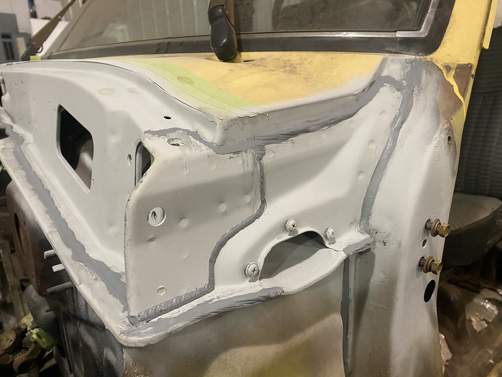

I guess I did have a fenderless image in this thread after all. It's been ages and I forgot. If you ignore the arrows in this picture, it shows the crushed in section where the firewall joins the cabin.
Looking a this again knowing what I do now, I think the leak is the underside of that outward crease, close to where the left most arrow is pointing to.
I don't think you can mess this up when reinstalling a fender to answer your question, but rather the issue here is a fender was likely replaced over bodywork that still needed to be done.

Aaand here we are. I had plenty of H2O intrusion here.
It became a block of ice at the inner side of the A-pillar, flooding the footwell, I removed the drain plug underneath the carpet and now that we are in summer it is time to reseal. Backstory is that I bought this FJ62 to be a parts rig, now I’m thinking it may be a good runner/grocerygetter/backup to Red60.

I think the repair there, in the case it is the point, is chiseling out the original roof seam sealer, and relaying the bead.
