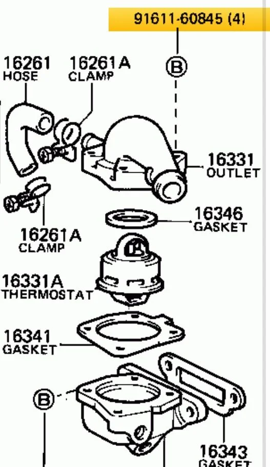

.... but the best bolts to use from a corrosion standpoint in the t-stat housing are new cadmium plated Toyota bolts.
PN: 91611-60845

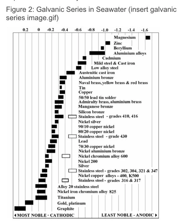

The corrosion potential between cadmium and aluminum is much lower than between stainless steel and aluminum....although antisieze may save your bacon.
If you want to use stainless steel, I'd follow @Spike Strip s advice and use studs, so you never have to deal with this again.
The reason your old bolts seized wasn't because of rusted steel, it was from galling caused by the corroded aluminum. Stainless steel will not protect you from that, and will actually accelerate it.
Damn, that's good info there. Thankyou.
Output offers good and wise advice, don't use SS in contact with aluminum. Especially with liquids and heat.
x4 billion. Or, you will need to use lots of Nickel-based anti-seize, not the cheap copper-alum stuff.
FWIW, you can get reg cad metric bolts that will work, most places, they'll just have 13mm heads instead of the JIS 12mm. Lots of antiseize under flat washer helps, too.
