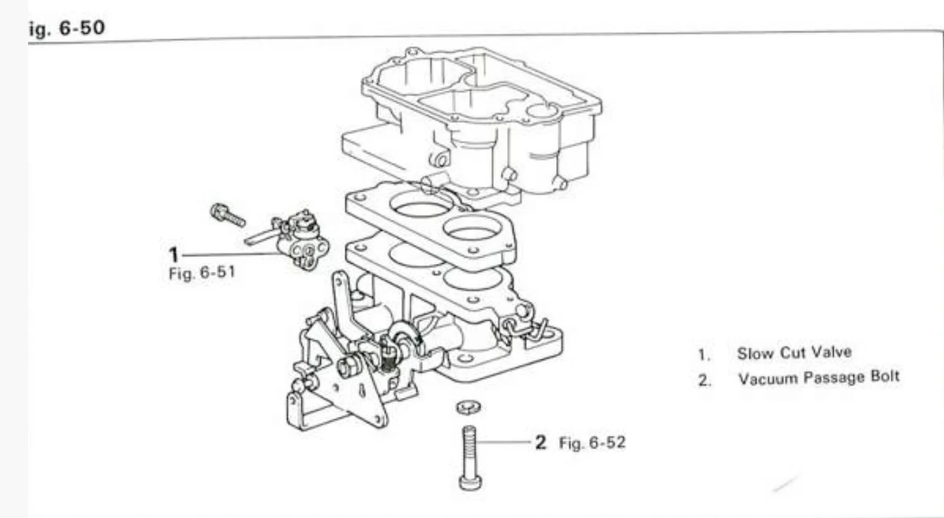

Already disassembled it is the issue.... Had fewer :banana:'s for sure a year and a half ago when i pulled the thing apart!
I'm missing the needle valve spring and pin, and a few of the small components. I couldn't find a comprehensive kit anywhere that had this stuff, any recommendations on that? @cruiseroutfit do you sell a FULL kit with these small parts and the throttle body gasket that goes right in the middle of the carb?(see photo for the area im talking about)
Also, I thought guys sent to the carb GURUS partly because they "desmog" them....
Dan
Post up in the Classifieds section of MUD.
Post 9 from @OGBeno is what I suggest if you need parts. Post up in Classifieds. You need a parts carburetor. Get a complete carb & between it & the one you currently have you s/b able to rebuild what you have & get on the road.
