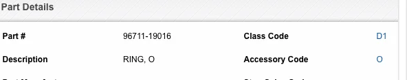

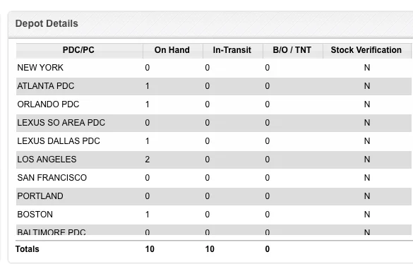

I hate to be that guy but you might want to tell your parts professionals that if they did even a simple Parts Information inquiry they would see this.... Definitely not discontinued.
You get your parts out of LA anyway.... 2 there. :)
Remind your guys that "D1" Class Code doesn't mean DISCONTINUED.
