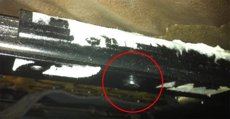

Is there some simple way to adjust the drivers seat on an FJ60 so it can be moved back as far as the passengers seat? There appears to be a small piece of metal on the drivers slide underneath that I don't see on the passengers seat. But, there is no obvious adjustment that can be made on it. Just need a little more leg room and there is about 2 - 3 more inches of rail there.

I'm going to take a few photos so I can study it up close. Weird angle to view it. I think I can remove the "stop" but I'd hate to exit out the back of the mount into the backseat when I pop the clutch.

remove the seat and have a look underneath.
4 bolts hold the seat on.

I took a shot of the alleged stop pin. It seems to only be on the outer side of the seat tracks, not the inner side. So, that pin (theoretically) is what pushes up through the railing and stops the slide backward.
