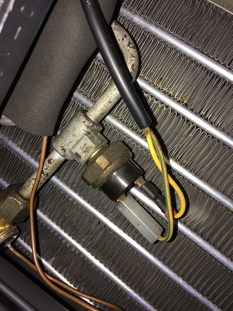

I need a little help finding my AC Pressure Switch. FSM see it’s suppose to be interior side of the evaporator unit. I look there - nothin?? Can someone take a look at your later model 60 (85 to 87 ) and verify where the switch is located? Thanks
Ok I’ll take the glove box off
You shouldn't have to take the glove box out to touch it. If it is similar to my '62, remove the fan motor, reach up and toward the driver side. Your hand will touch the coil and the switch should be right there.
Yup! What this person said . Definitely don’t take the glove box out.
I did this recently. Photo taken with my phone through the hole where the motor usually sits:
Man the pic (and the fan removal tip) did the trick - Thanks
