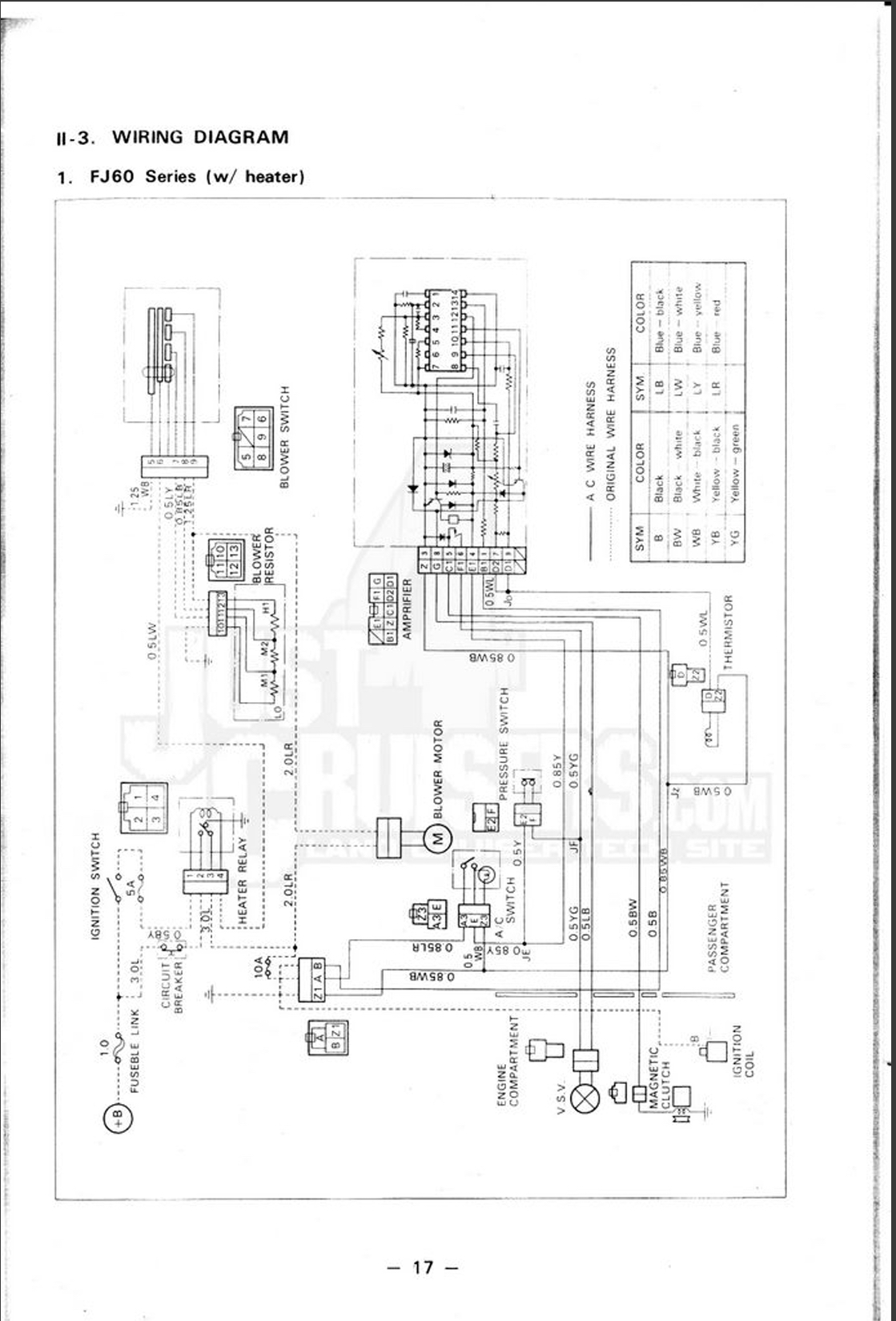

I am going through trouble shooting my inoperative AC in my '87 FJ60.
My AC amplifier is not triggering my compressor. The compressor engages when the AC amp is bypassed.
I am wondering if the wires you referred to might have been hooked up wrong from by a previous owner or their mechanic.
Could you got into more detail about # 10 in your post above?
A picture can be worth a thousand words. If able, could you post up some photos of the connections you were referring to?
