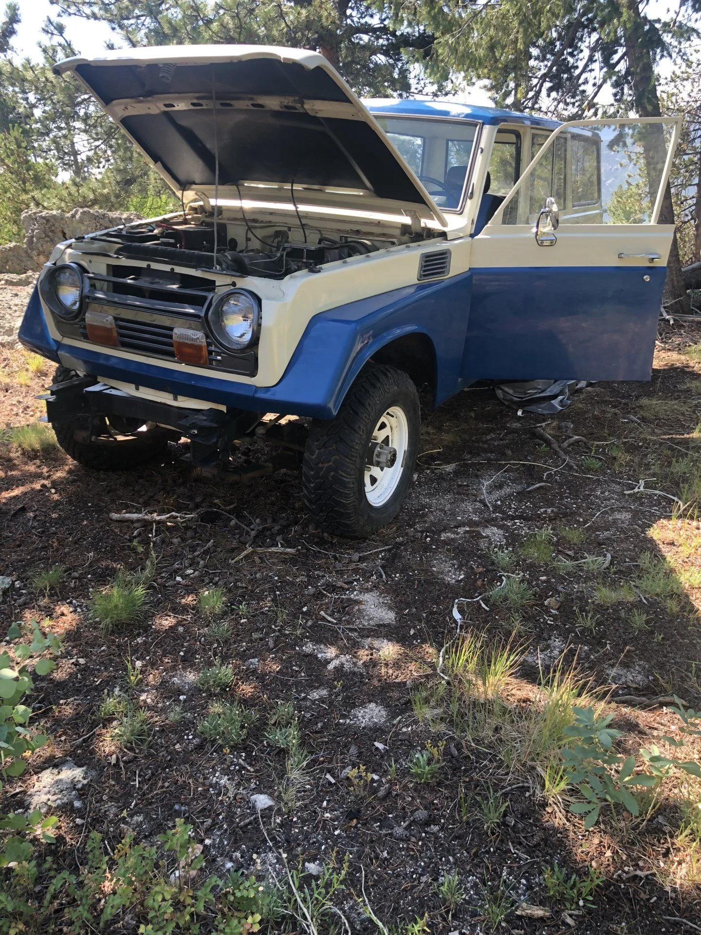

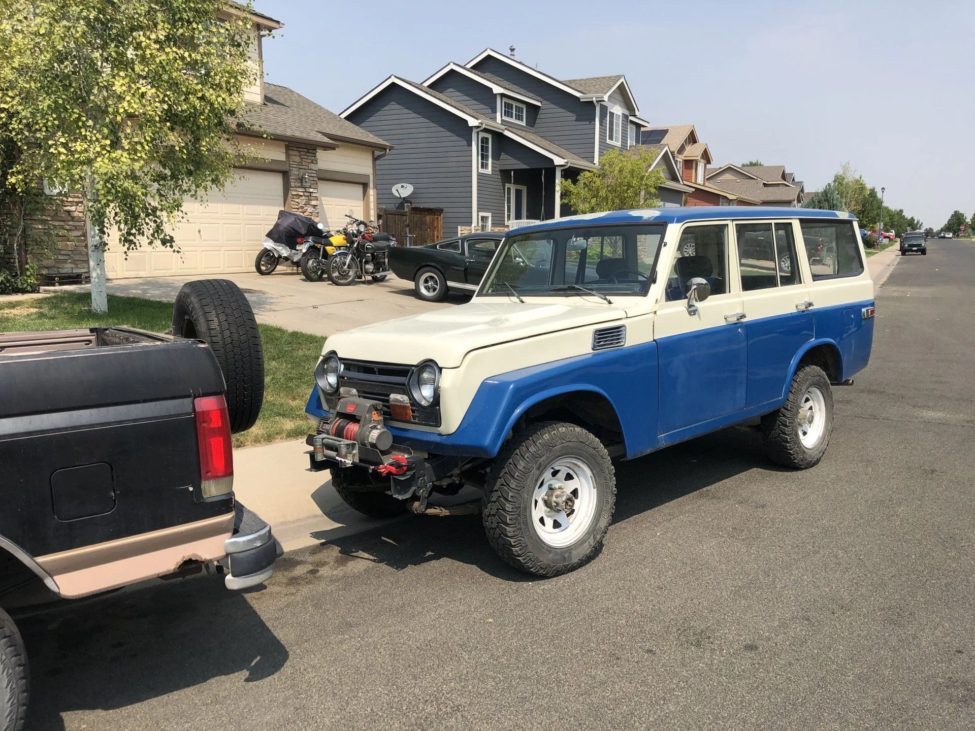

It’s been 12 years since I restored it. 8 years since I’ve seen it. Couple weeks ago I went up Storm Mountain to get it running again. This week it’s back with me for some maintenance.
Its held up pretty well considering it’s been 12 years, and the last 8 years it’s been stuck on the side of a mountain.

It was fast. I’ve never liked the white spojes myself, but overall, great rig.
It got a nice tune up today, running great again, it’s a 2F, not sure if those are also “too stupid to die”, but after 8 years of sitting?
