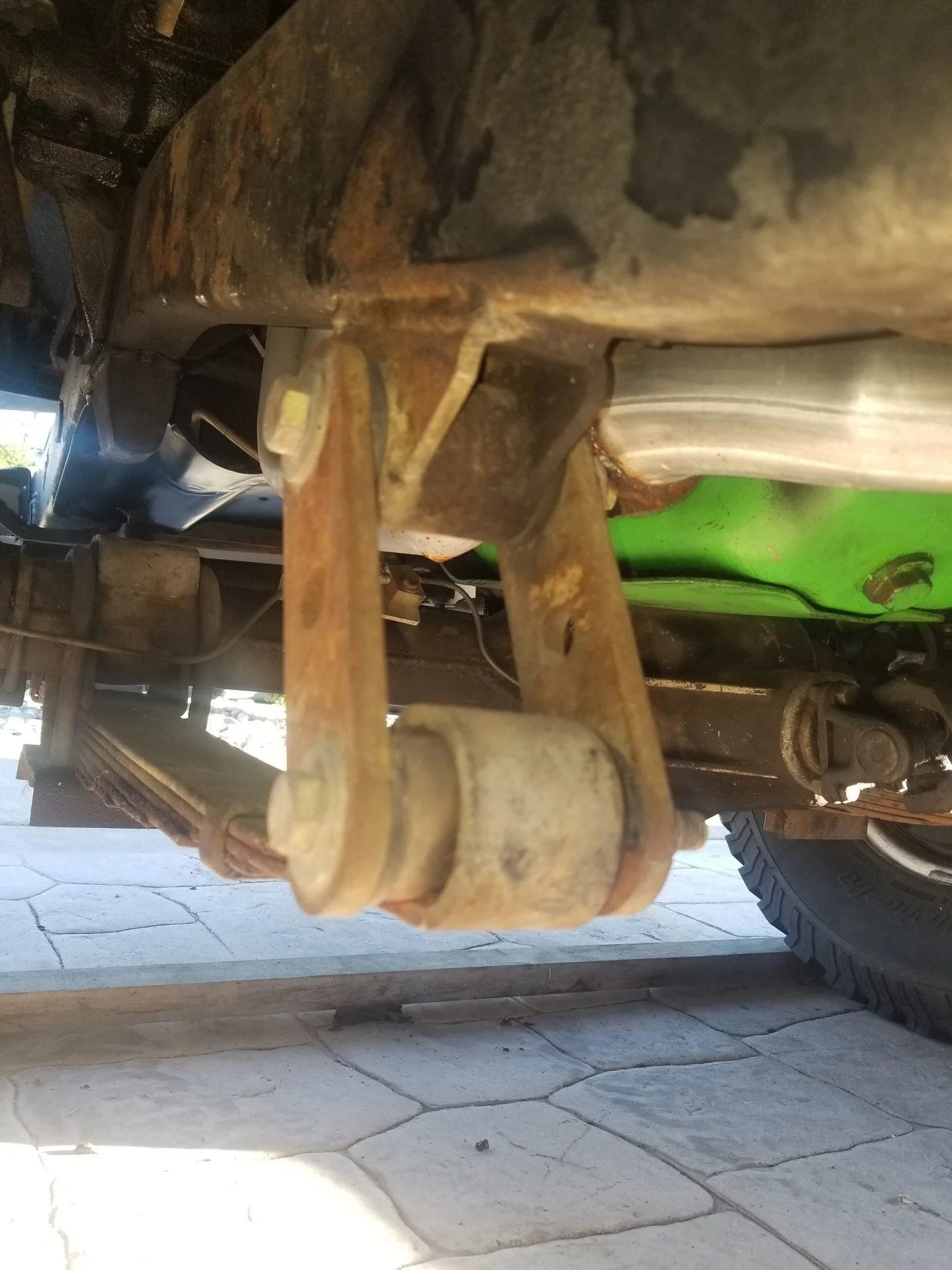

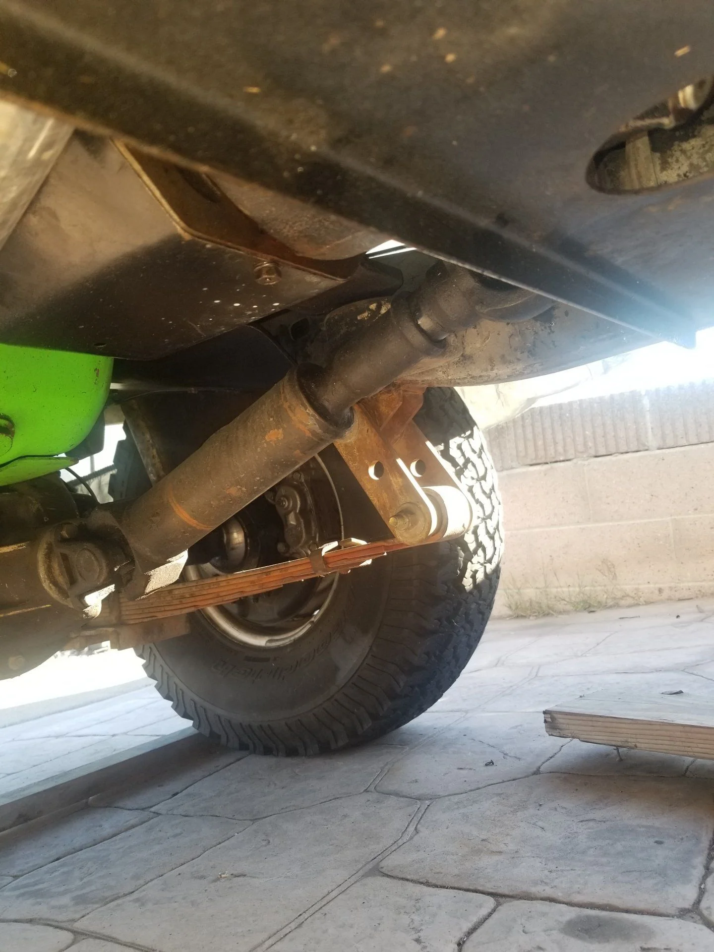

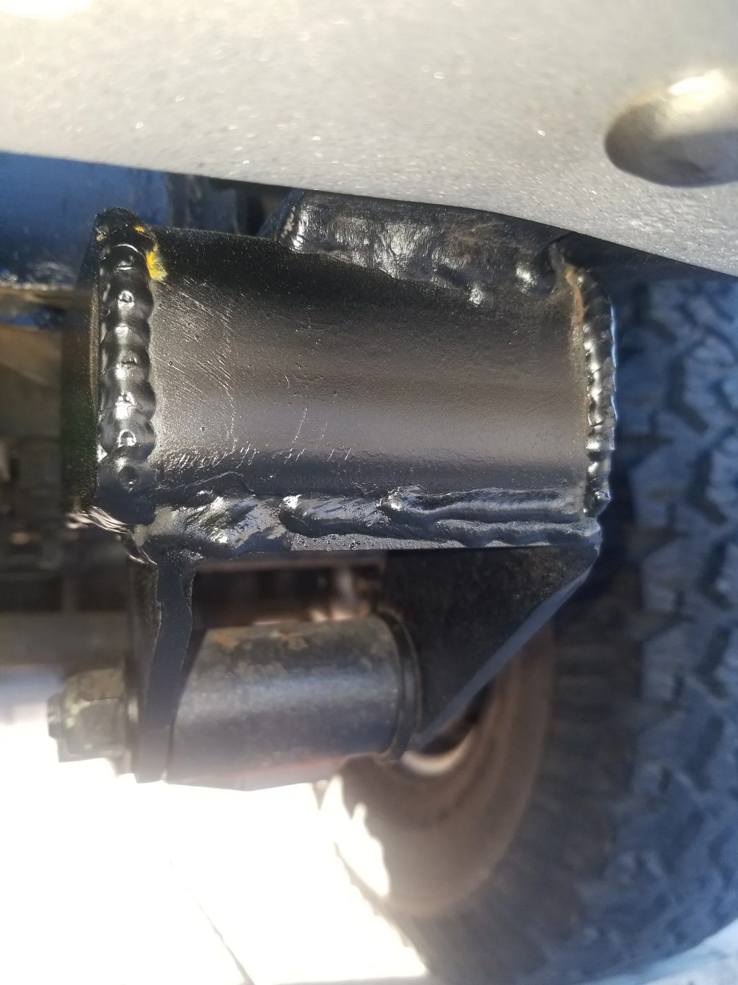

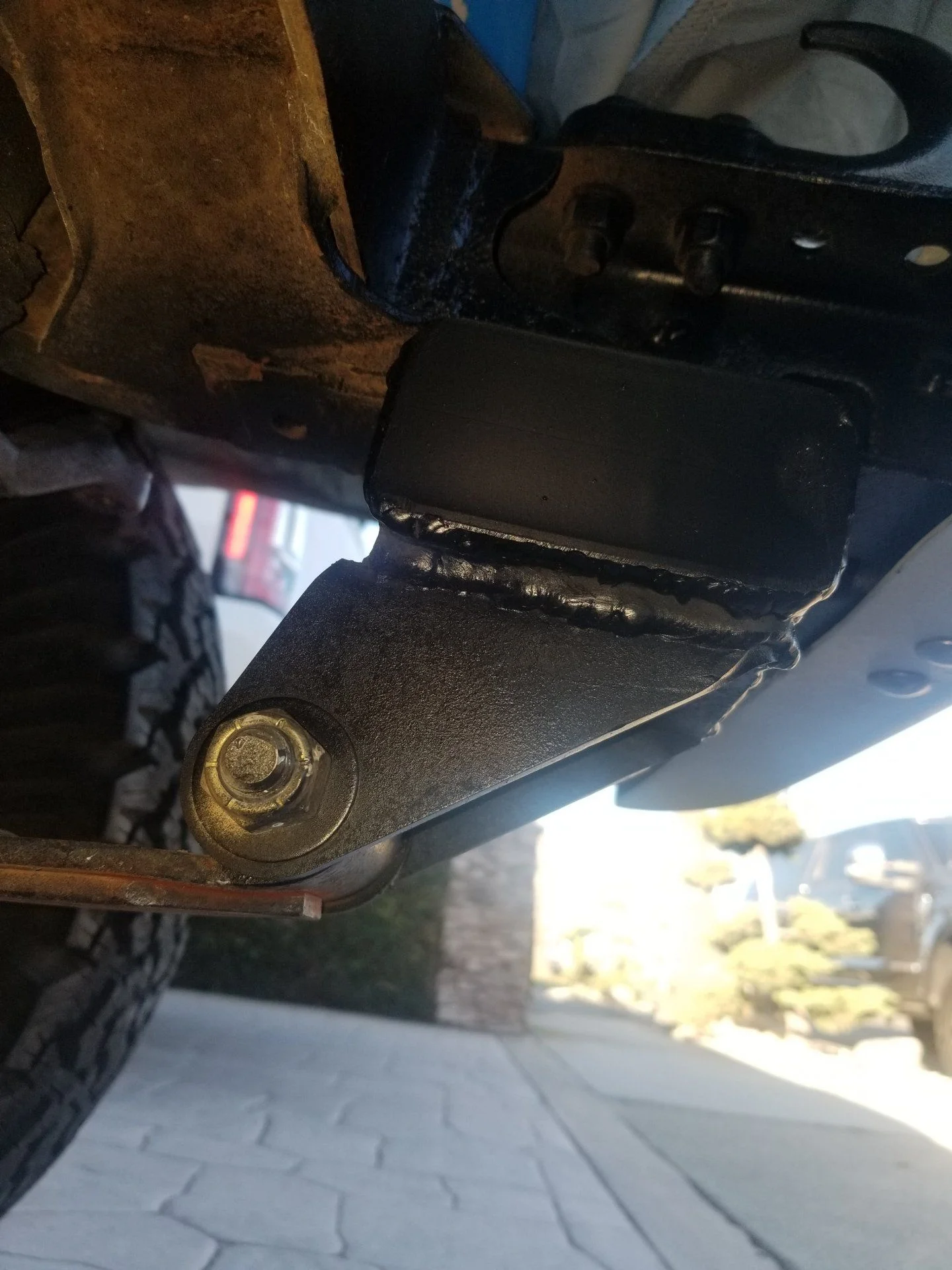

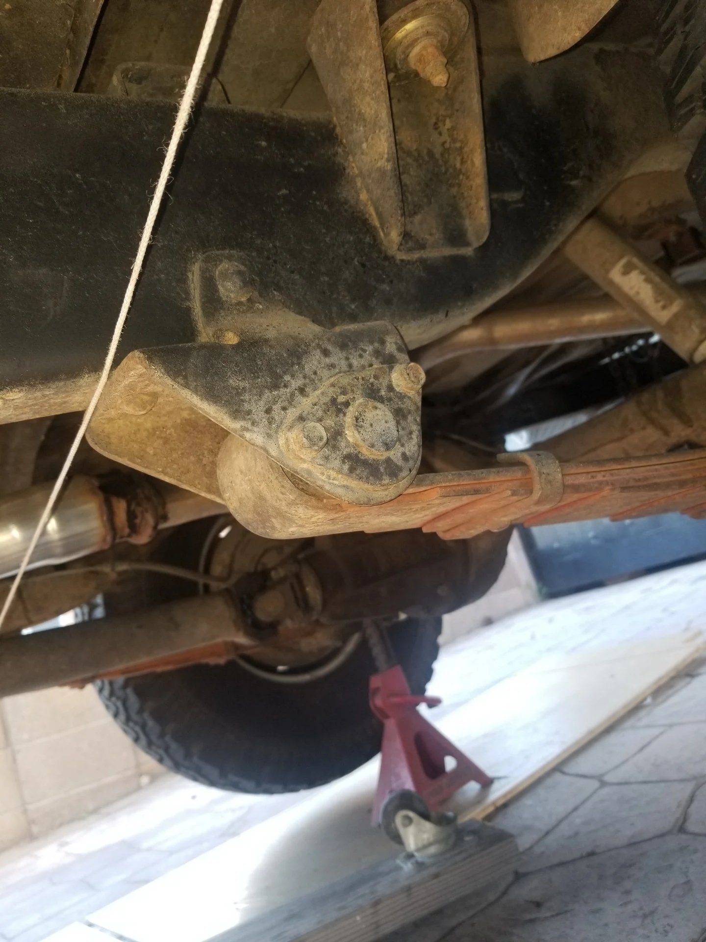

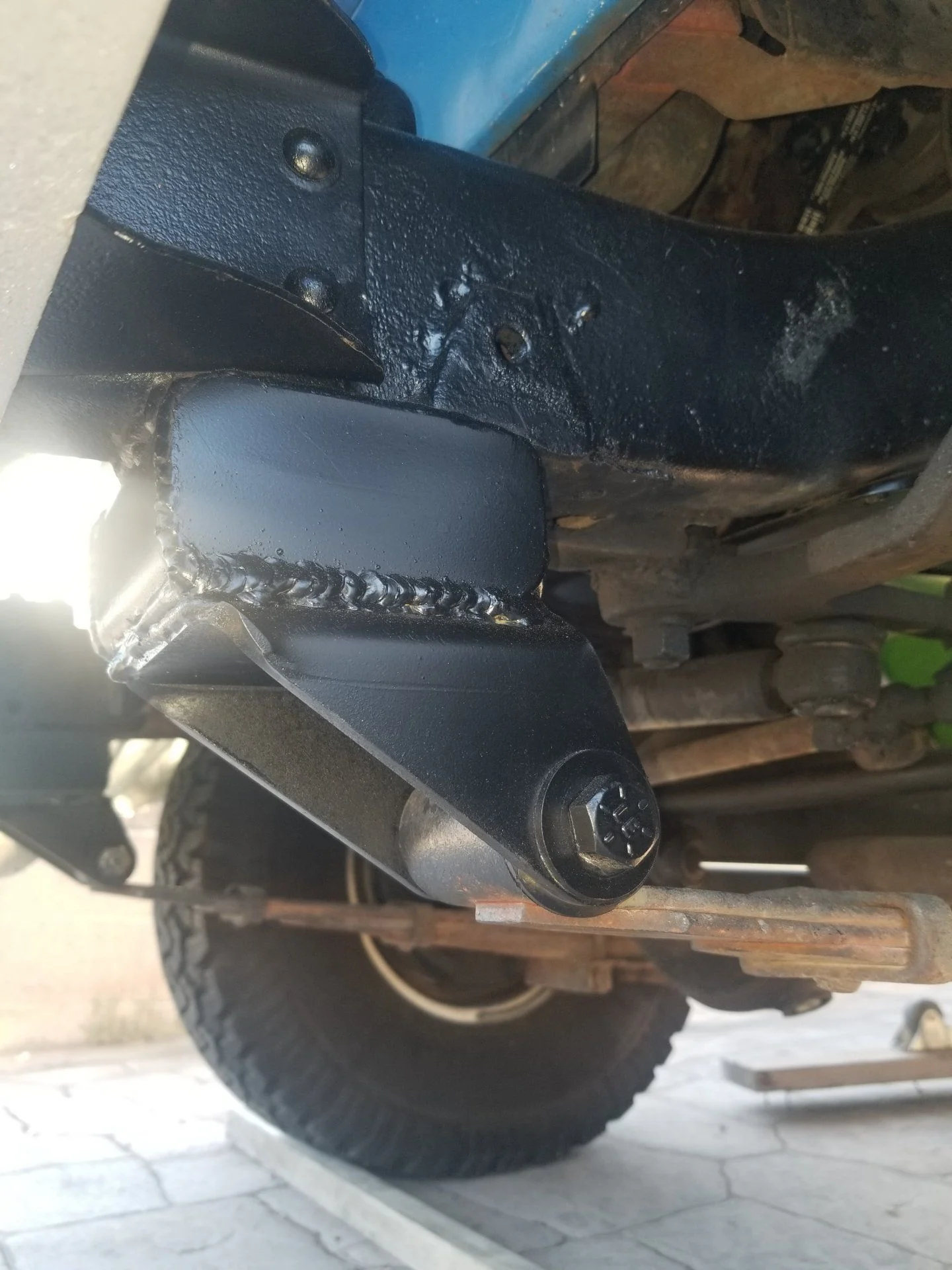

I have a FJ55 that the axles were converted to FJ60 axles. work was completed by previous owner. question? is this possible to work? I know the fj60 has a front and rear sway bar and my Fj55 does not. also i have fj55 top leaf spring mounts and fj60 low shackle mounts sooo, top mounts and bushings are smaller then the larger fj60 bushings on the bottom of the shackel. . looking for help and also if i should put the sway bars on and need direction where to get the parts. thanks for your help.

yes thats correct. the top bushings are fj55 and the lower are the 60s it was a fj60 swap with leaf springs as well. its a mess i have to get out of. looks like i need the entire set up. four upper leaf spring mounts from as 60 as well as front and rear sway bars and all the mounts. any idea where i can get that.
So I don't know that you will need to change anything on the upper mounts. The 55 bushing's are 16mm (ID) from the factory and the 60 bushings are 18mm (ID). That being said, it is easy to get 18mm ID bushings for the 55 mounts, I just bought a set for my truck @cruiseroutfit It honestly sounds like your truck is setup pretty good.

but because the 55 is smaller then the 60 bushings it looks like its eating the lower bushings up. i could be wrong who knows how long it was done. so maybe just replace all the busihings and keep and eye on it. thanks for the help.
plus i think that the upper fj55 mount would need to go over a little since its a little off and not centered with the fj60 leaf springs
If it were mine, I would replace all the bushings and probably the shackles with 60 shackles. Then, like you said, monitor the wear.

You will have to see if the FJ60 spring eyes will accept the FJ55 bushings. I want to say that should work but I’m not positive. You could then use FJ55 shackles. If the spring eye diameters are different, then you’ll have to make some custom shackles with different bolt hole diameters for the lower FJ60 spring eye bolt and the upper FJ55 shackle mount bolts.

I just finished installing, but haven't run my 60 series axles, there are a number of pics in my build - my set up is outboarded perches in the front (had to in order to get the leaf to sit outside the diff), j70 leafs, rear shackle moved back, lots of fussing with OME bushings to get it all together. I also used the stock rear sway bar (per the advice of everybody here), have, but didn't install the front. The rear required welding a mount on the diff and the DS mount being raised a few inches to match.
Are the perches on the front axle moved in to match the width of the 55 frame? If not then I would get all new frame mounts, outboard them to match the 60 axle mount width and then run all the same size bushings. It is the solution that requires the most work but will be the best long term in my opinion.
