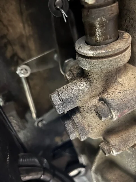

Thanx snow day today will try again and try to post pics

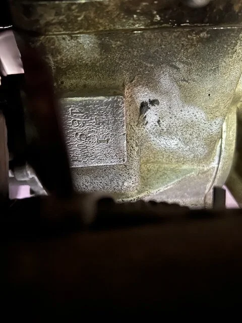

0k, I did some more research and it has what looks like ASCO on top of transfer case with 4 I 1690 stamped on small pad. Looking at other posts I assume it is 1974 September # 1690 produced. That being said it is hooked to advanced adapter to sm465. I disconnected linkage and moved again manually thru 2h 4h and 4 low. Releasing clutch it only moves in 2h and 4h the strange thing is 4 low front drive shaft appears engaged but no movement when clutch released. If anyone has any further suggestions, I would appreciate it or where would i research rebuild kits? Thank for input so far.

2H-4H is the linkage to the nosecone on the front of the transfer case
4H-N-4L is the rod fulcrum linkage to the top of the transfer case
are you removing the last rod to the top of the case and manually moving the lever on top of the case thru the 3 positions?

thanx for the posts. The PO had fabricated a rod from the 4 low that wouldn't allow it to go thru 3 positions only 2 and was stuck in what I assume neutral ..stting for 15 plus years. Looks like a discontinued item, will have to have fabricated thanks again for the input.
