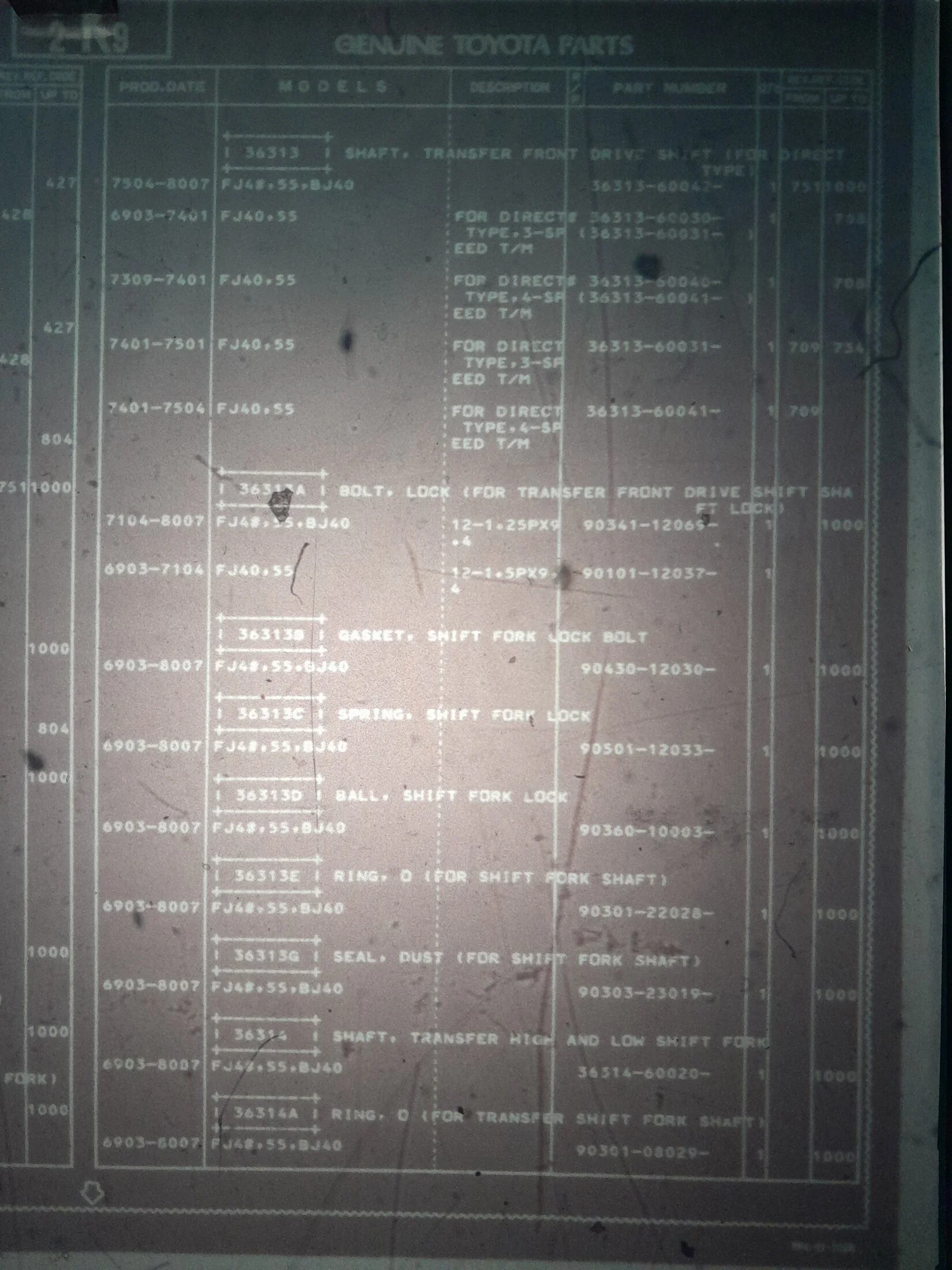

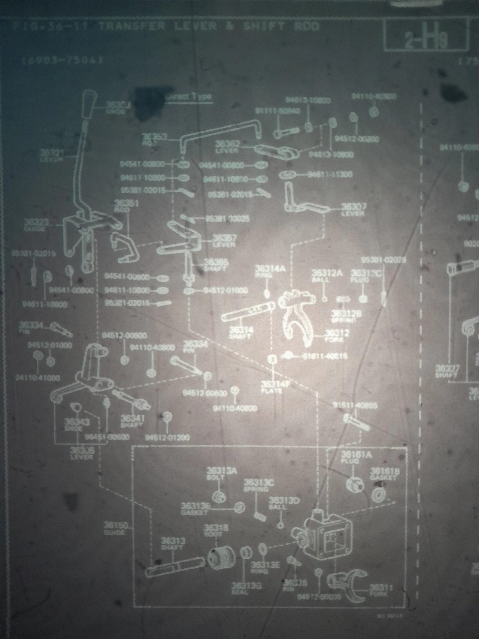

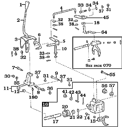

I have a leak from the transfer case boot shown in photo below. Ive found the parts schematic also below, but cant for the life of me source the part numbers of the gaskets. Does anyone have a lead on part #21 / #22. Any advice on repair / install would be greatly appreciated!
21 is a dust shield part number 90303-23019, NLA. 22 is an O ring part number 90301-22028, also NLA. This is going by the style of the high low shifter linkage which ended 4/75. O ring is where it's leaking. Once the dust shield was saturated with oil it leaked into the boot. If the housing worn a new O ring is only a temporary solution.
