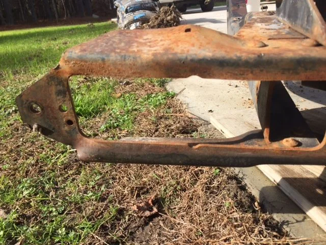

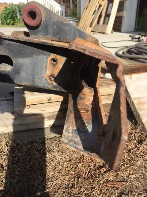

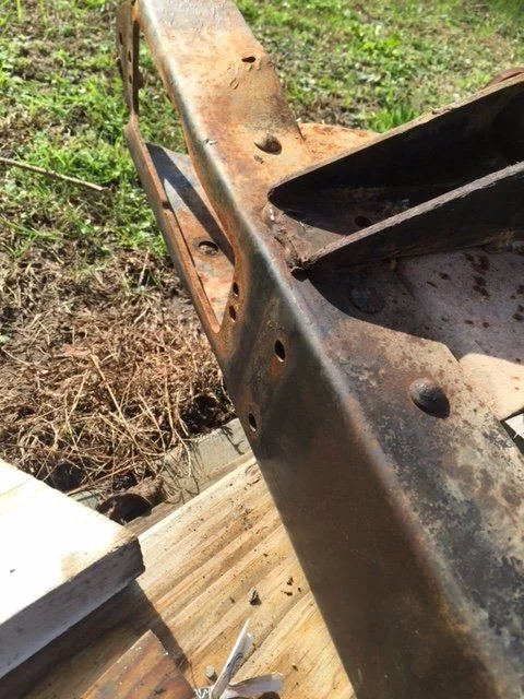

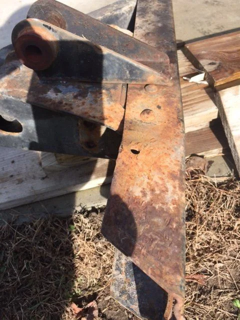

My 1977 FJ40 has a slight bend in the right rear corner. Do you think this can be straightened out? If so, what would be the best way to go about it? The frame is completely stripped at this point.
Jeff
It probably wouldn't hurt to have a clamped chunk of steel pulling on the affected areas while you're beating, unheated first, then heated if need be. The tension while beating will help straighten out the crimped areas.
