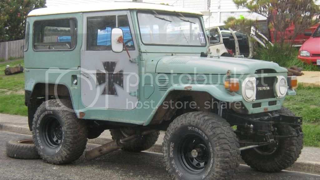

Seeing your iron cross makes me think of the couple of air brushes I have here. I've been wanting to test my skills (or lack thereof) in that department but so far I haven't had the courage..

Yea,its been "character building" doing all the work outside for so long...
The way my backyard was modelled by a previous owner,and large slope makes it makes it impossible to build a decent shed,and be able to drive a car to it..
Buuut,that being said,I do the majority of work on my front lawn..bodywork,paint prep,and most other stuff i dont need flat ground for..to be honest its good workin on the shorty out there,its so high up,and theres plenty of space :)

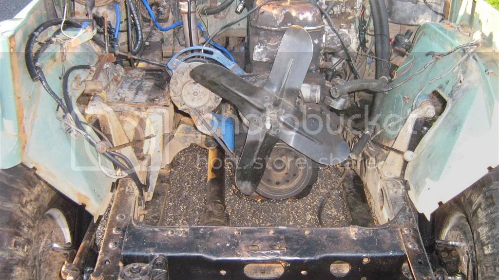

Well,plenty of progress made today..trans hump,fuel tank and interior all put back in,all drivetrain hooked back up,intake manifold and most bolt ons done,just gotta do exhaust,radiator,and hook all the wiring and plumbing back up,bleed clutch etc...all the fiddly stuff..
Annnd,before anyone points out the dirty engine and bay,tomorrow after exhaust manifold goes on ill pressure wash it :P

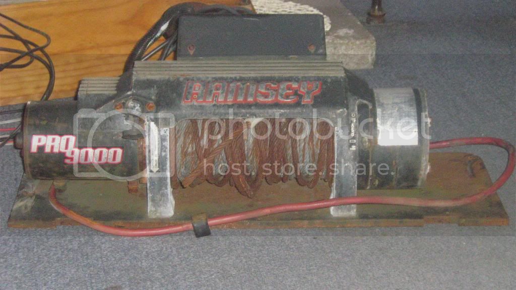

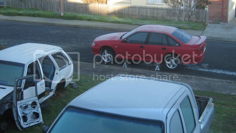

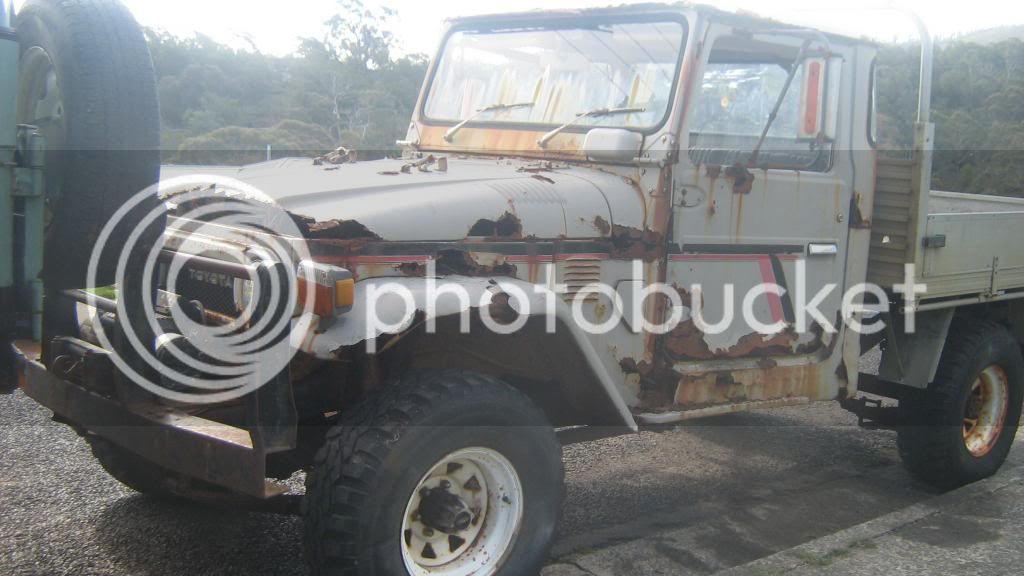

Well,after my cooling down period,I done some asking around,found out about a rusty 1978 FJ45 ute a bloke was gunna start wrecking out..I drop down,have a chat...and buy the whole bloody ute :)...good 2F,4 speed,decent seats,UHF radio,ramsey electric winch,good alloy tray etc...so ive been stripping it the last couple of days :)..
Pics...
That's got to be a fisherman's truck!
And it's now contributing to the iron ore reserves in your street while you extract the goodies...

Well,another productive day...ripped the tray off old rusty,finished guttin it inside,and pulled the gearbox...
Clutch fork and pivot ball are different :( ...so,as im underneath my shorty swearing,I spotted my long lost clutch pivot ball,hidden near the bottom of my transfer shifter :) :) .
