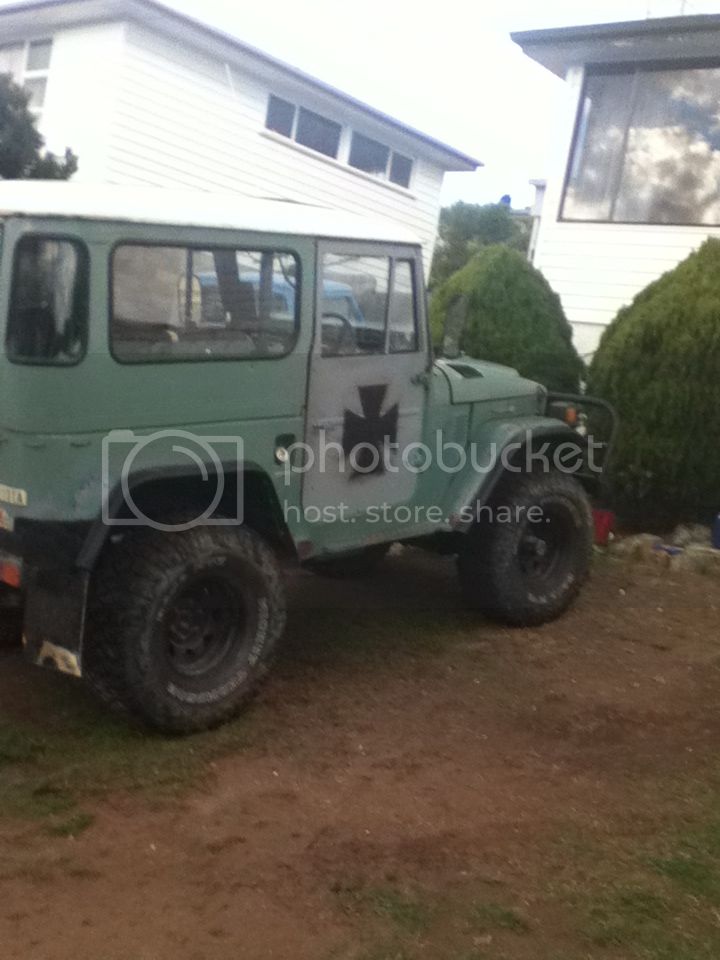

Well,going by tradition with my 40...things didnt quite go as planned :(
Day 1
within 3 minutes of starting work on it,i sliced my finger open..it was an omen of what was to come.
Put it all back together,wound it over..tried to fire,but didnt...moved dizzy,got it to run rough..had to move the dizzy over 1 tooth to get it running.and was running like s***.kept it running for 30 mins to bed in the new cam.tried different coil,played with carb..run out of daylight,so gave up.
Day 2
Woke up fresh,and had a think about things overnight,and decided it was cam timing.Nosecone off,radiator out,winch off harmonic balancer again :) ,remove timing cover,sure enough,it was 1 tooth out on the cam gear...so,i moved cam,put dizzy in,and thought ...hmmm...should propaply try to start it...so I did.
it started,ran,then keyway flew out of crank :( After about an hour searching my front lawn for the keyway,I found it,set timing up again,put it all back together...it ran,but only on 5 cylinders :(...by this stage im swearing,so I had a smoke,had a coffee...and pulled plugs out,done compression test...number 3 cylinder no compression...enter swearing,smoke and coffee break again.
Get motivated enough to pull rocker cover off...hold on,whats this?1 pushrod has bent like a banana...i go through my spare parts pile,dig out a good pushrod,replace it,put it back together...and....Success :) ...runs sweet,cam gives a bit of a lumpy idle,and pulls well right through the rev range...didnt get to fit my extractors yet as i need to heatproof wrap them due to them sitting close to the battery...ill try to get that done on my next day off work :)
Pic is halfway through day 1
