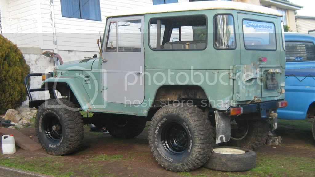

Well,didnt do much after work this arvo on it,just installed the top half of an old commodore fan shroud to cover the exposed fan blades for inspection,and finally ordered my double arm and tie rod end kit from superior engineering :)
Been trying to utilise as many parts i got laying around home from previous wrecked cruisers and falcons,but when it comes to brakes and steering,I always buy new :)

I have an odd shock absorber on the front,and its limiting suspension travel,but ill adress that after it gets regoed.

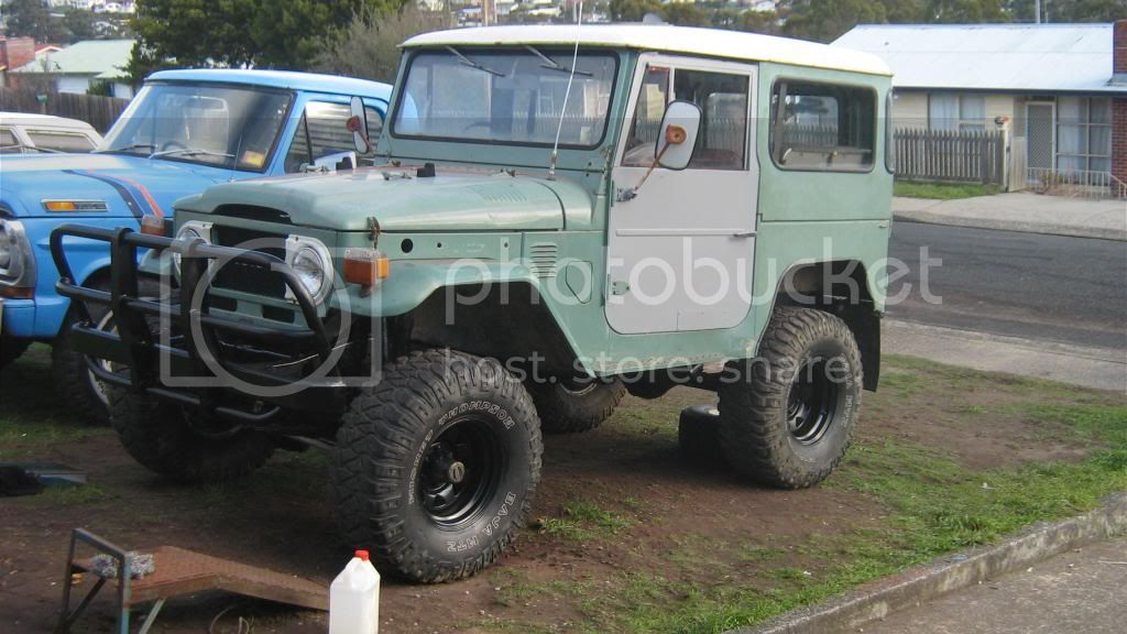

The big arse bodylift is out :),looks heaps better now...body is just sitting on the frame at the moment..got tomorrow off work,so ill bolt the body on then :)
Put both doors in grey primer,a mate of mine is good with a airbrush,so hes painting a large maltese iron cross on each door,paint the wheels black,repaint the bullbar black,then leave the rest....I like the old survivor look,and I already have 1 nice,shiny car to keep clean...dont want 2 shiny cars lol

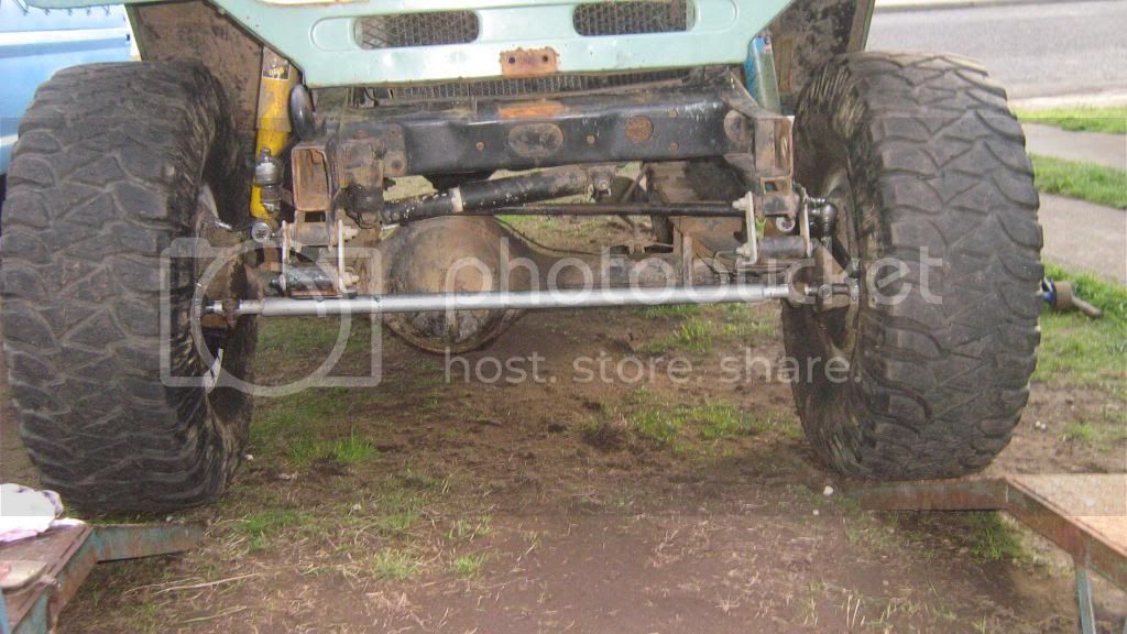

Well,got some more done...my steering parts arrived from superior engineering,crossover steering arm,all tie rod ends etc,installed everything today...no pics yet as it got dark as i finished....I have also turned it into a 7 seater..scored a pair of double jump seats locally.Just need to round up 4 lap belts :D
Well,havnt updated for a bit,but been busy the past coupla weeks..
new tie rod ends and double steer arm.

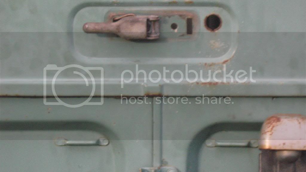

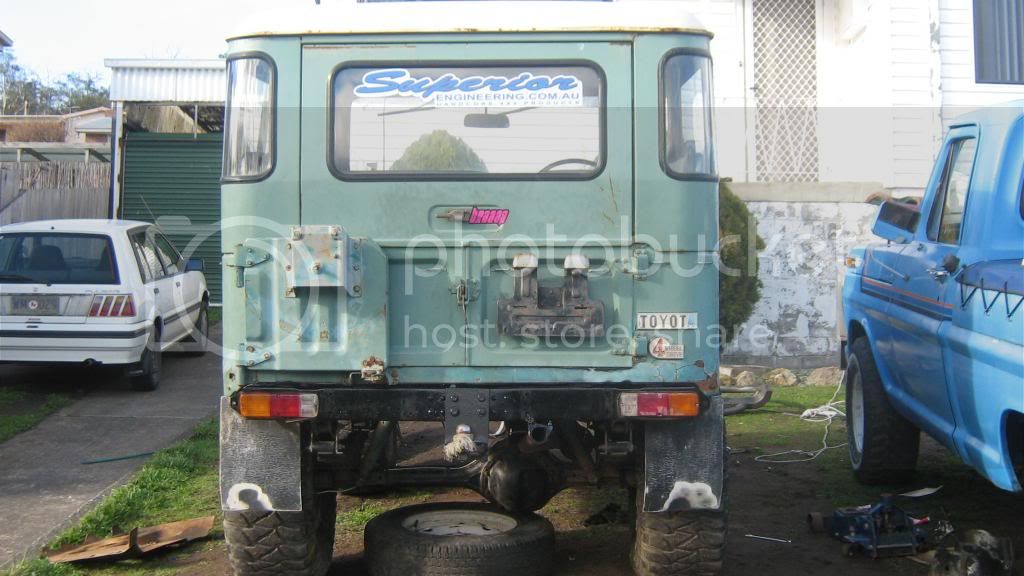

Keeping with the "extreme budget build" theme,rather than pay 100$ for a rear doorhandle,i done a macgyver with a fj45 roof clip,and made a working doorhandle

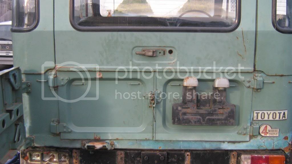

New tailight lense :P ,exhaust cobbled together from a few different exhausts layin around the yard,anda well placed sticker to cover the holes in tailgate near handle

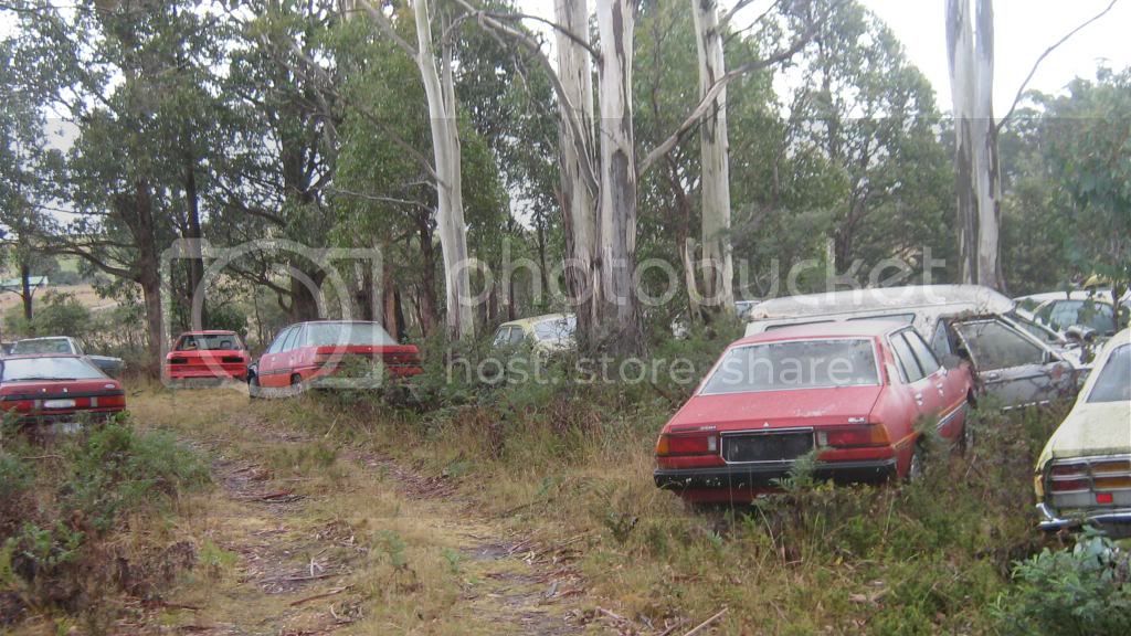

A trip out to our personal "car graveyard" to get some lap seatbelts for the rear

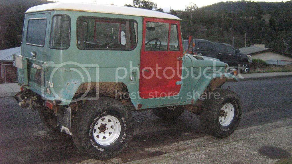

Roo bar all painted up and fitted :)

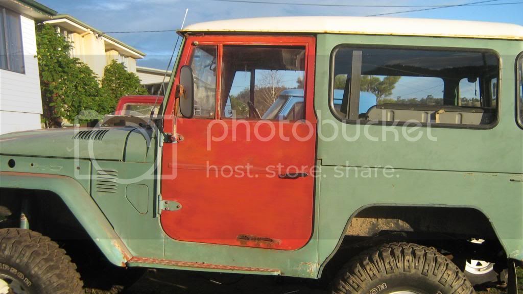

rusthole in the door...

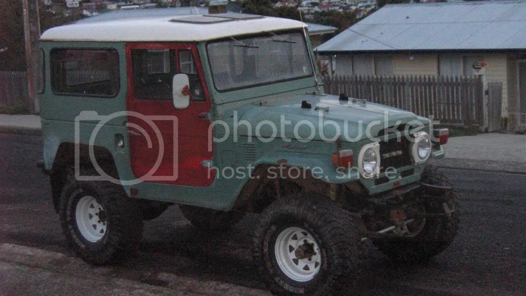

fixed with a tin patch and pop rivets :P ...doors have been finished in gleaming grey primer,and the wheels copped the best in rattle can black :)
Hoping to get it in this week for a roadworthy inspection/rego :)

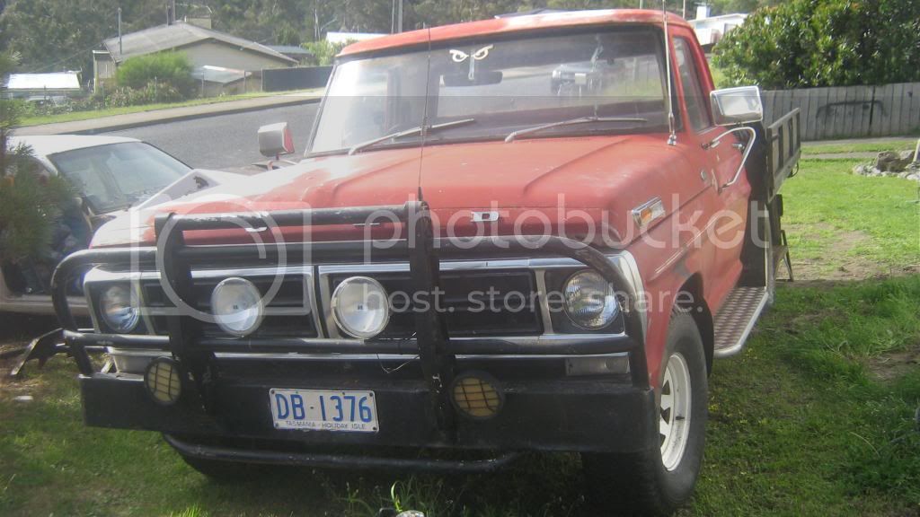

The red one (1971) is my uncles old F100...he passed away a few years back...this one is going to undergo a transformation soon :)..it still has the US 250 engine and 4 speed box..runs and drives,but needs brakes and other stuff.
1 of them will get a V8...undecided which one yet...pulled a good clevo V8/auto combo out of the rusty intercepter thing pictured..

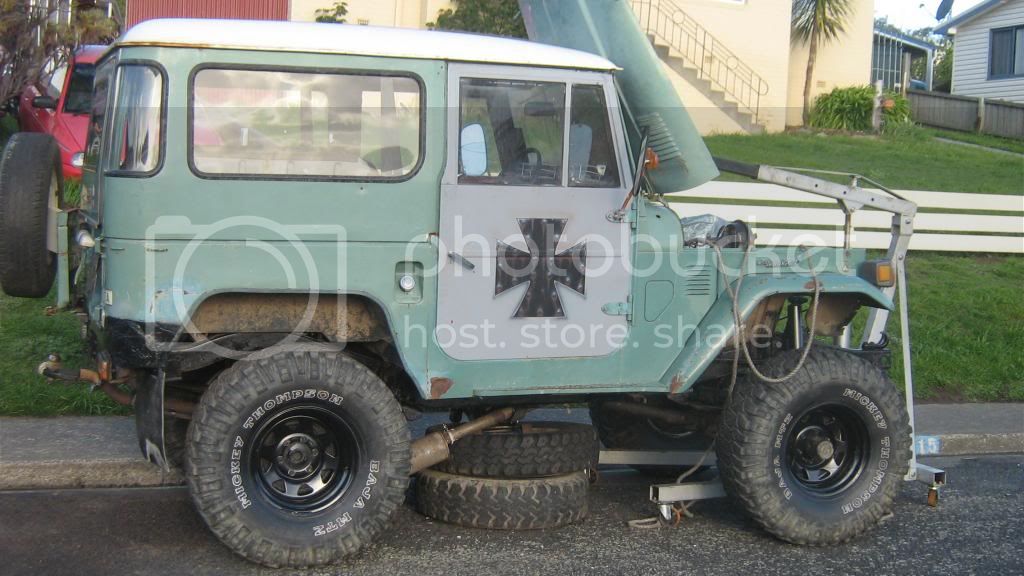

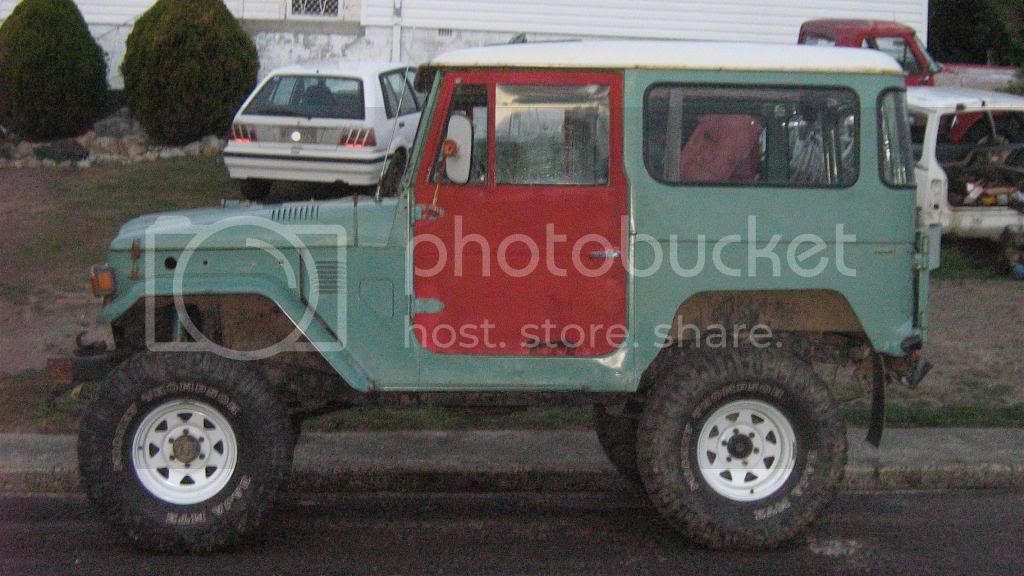

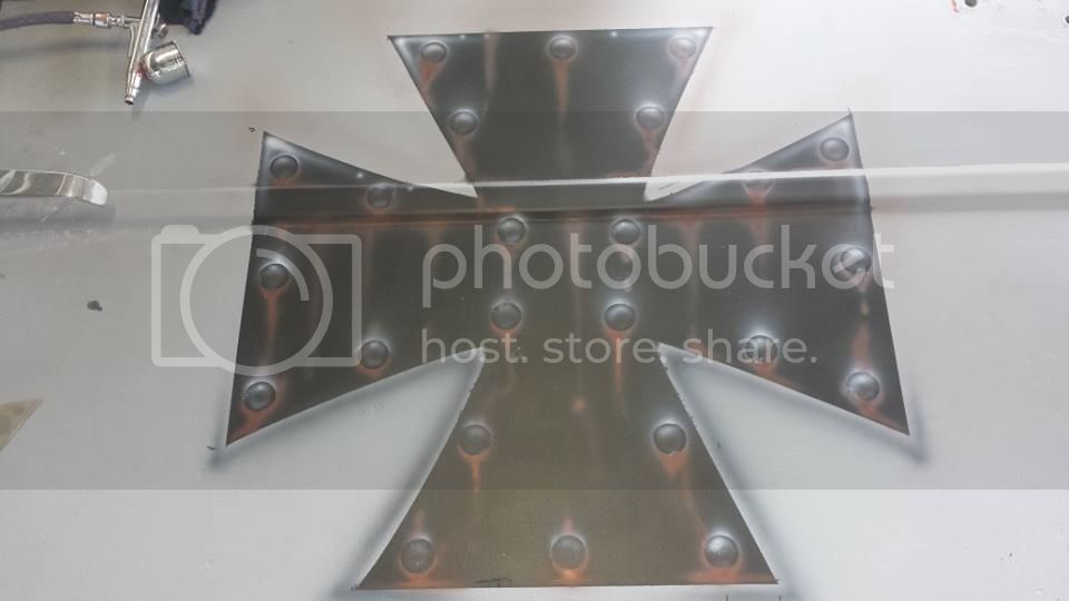

buut,tomorrow I get my doors back from the painter..well,painter is a insult really..hes more of an artist :)
pic taken before he shot the clear..
But now im going to have to find more doors for "bush missions"...i dont wanna ruin the crosses in the scrub :P

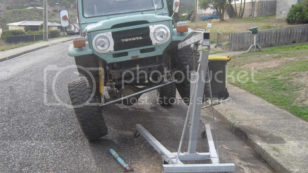

Well,got a bit done today...
After battling to get the engine and gearbox mated together underneath the fourby for 2 afternoons,I bit the bullet :( .
I removed my seats...again
I removed my fuel tank...again
I unbolted tailshafts...again.
Yea,you get the idea.
Well,once gearbox was out of the cruiser,it slotted onto the back of the engine fairly easily.
So,the engine and gearbox are bolted back into place,after some wrestling and lots of swearing..
Tomorrow,to put all the stuff back on that i pulled off today :/
