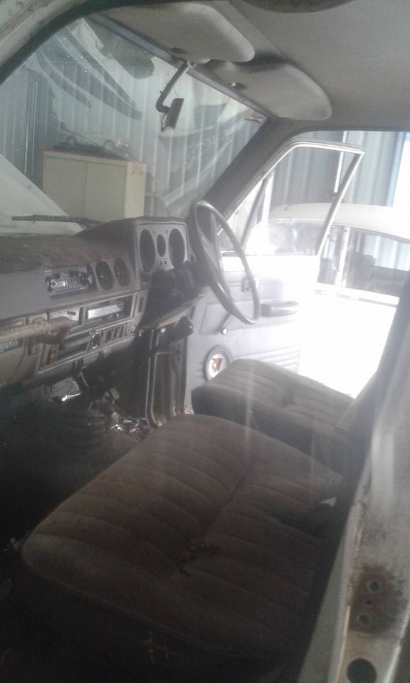

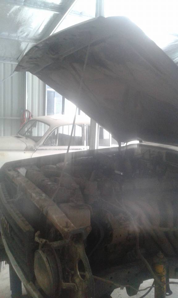

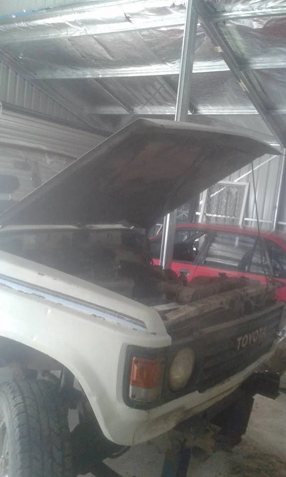

And today I just scored a HJ60 wagon..2H,5 speed,power steer,disc front...now I can build it the way I wanted it....stay tuned :)

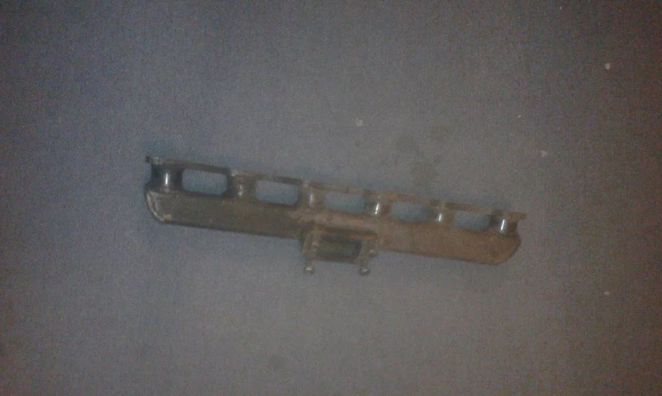

Theres the big 2H 60..1st month 1985 build..engine sounds sweet,and got a homebrew high mount turbo manifold too....its ugly,but it works.It has a T3 flange,So im planning fitting a Hitachi HT18 from a jap spec R33 gts-t skyline.its around a T28 size,with .60 A/R compressor and .50 A/R turbine so theoretically it should work pretty good.stock boost is 7 psi,i might run around 10psi and it should stay happy
Cheap and easy to source in australia.
