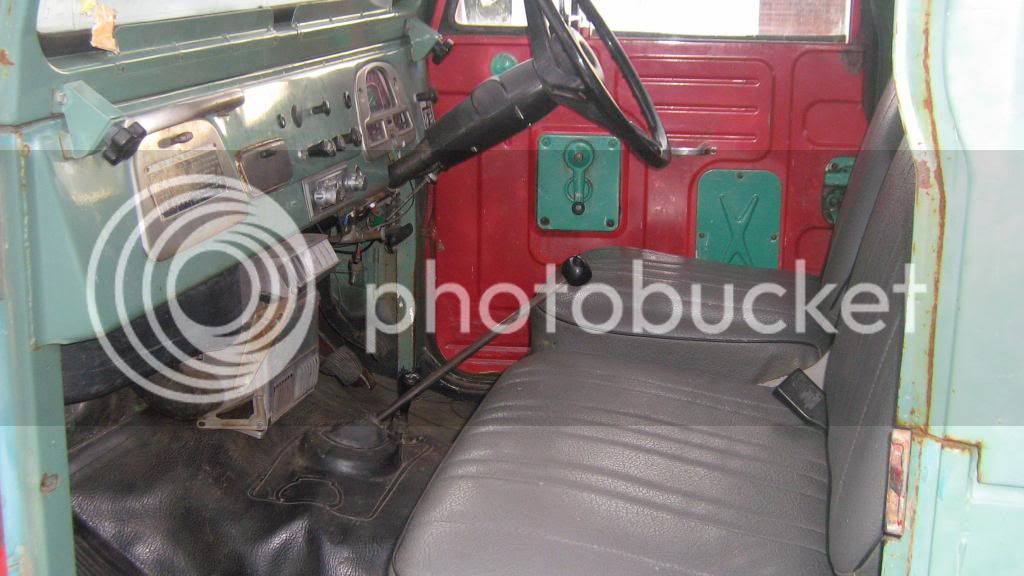

Had a very good pair of 45 series front seats to replace my torn,waterlogged 40 seats...simple enough?Wrong.
First issue was the seat frames mounted differently to the floorpan...after a think over a smoke and coffee,I decided the best plan of attack would be to take the seat covering and foams off the 45 frames,and just simply pop them on my 40 series frames...simple enough?wrong again :( .
The 45 has coil springs mounted to the seat baseplate which is spot welded to the frame,and a thin layer of foam on top...the 40 had the more conventional setup of longer,horizontal springs with a thick foam layer...so in the end I cut up an old foam mteress,re foamed the 40 bases with that,and fitted the 45 series covers...
Nothing is ever simple...few pics of the results :)

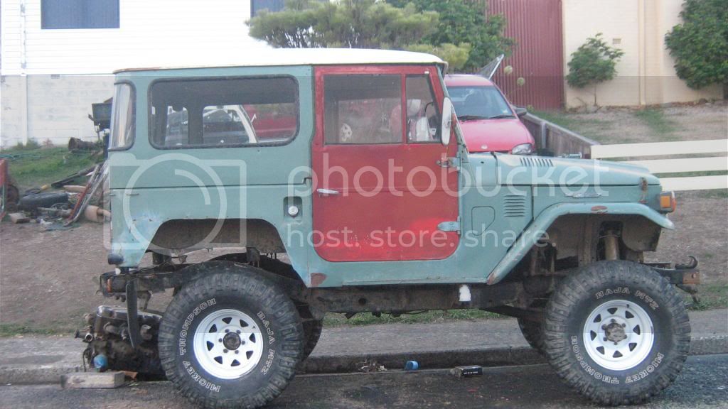

a coupla pics taken this arvo...not much has changed outside yet...
Hey mate looking good, I wish my 68' that was originally from Rupert Murdock's newspaper firm in Tassie was that good in the body.
The mercury had 40s?They drive corolla wagons mainly now...looks like their vehicle choice has followed their lacklustre journalistic skills...downhill :)
