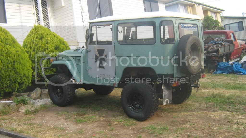

Cleaned it all out tonight,finished off the underbonnet stuff,and started fitting some of my "period accesories"

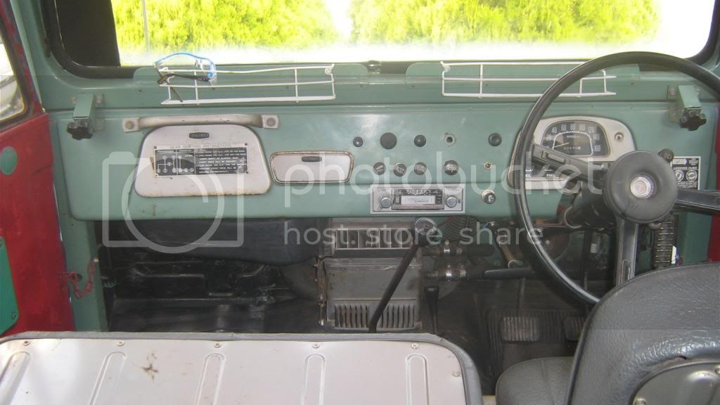

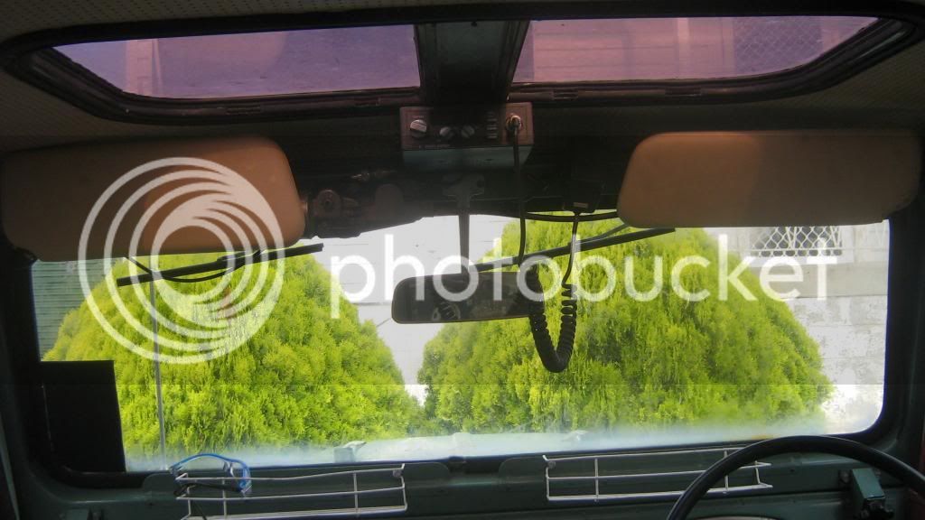

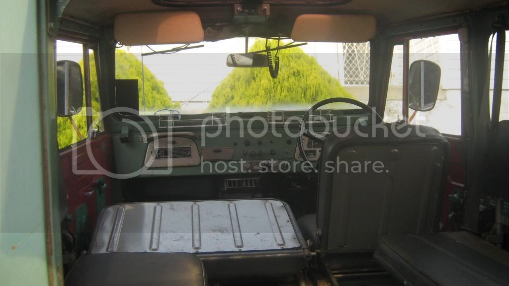

got the old school pierce simpson leopard 3 CB radio mounted,ive just regreased the gearbox in my old ramsey pro 9000 winch and wire wheeled the outside contacts..ill pull the motor out of it tomorrow to clean and check everything,and bolt it on :)...im trying to keep everything "old school" well used stuff,but I might have to bite the bullet with the audio system :( ...The cassette player isnt gunna cut it..my clubsport has an aftermarket USB head unit,and thats up there with the greatest inventions ever!! :)...might "stealth mount" one under the dash,and leave the cassette player in the dash :)

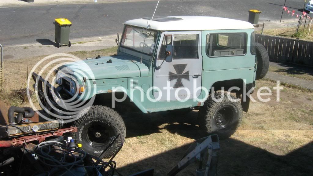

Well,done the timing,hooked up vac advance,played around with the weber to get it running smooth..took it for a run around the block....and bam...coppers with pretty lights filled my mirrors just as i pulled into my street...sooo...I kept driving to my place and launched her up on the lawn :P .
$400 fine...ahh well,thats the risk we take doin mechanical work on jalopies at home :)..a run around the block is needed to check if the carb is set properly,or if the dizzy advance is right..

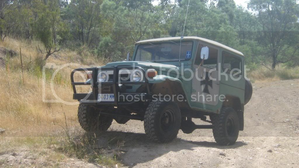

Bullbar modified to suit fairlead,and bolted back on :)
Cruiser radiator has replaced the falcon radiator I had in it,but the inlet/outlet were on oppisite sides...sooo,I got inventive with some copper pipe and different hoses :P...not pretty,but effective and increases coolant capacity :)

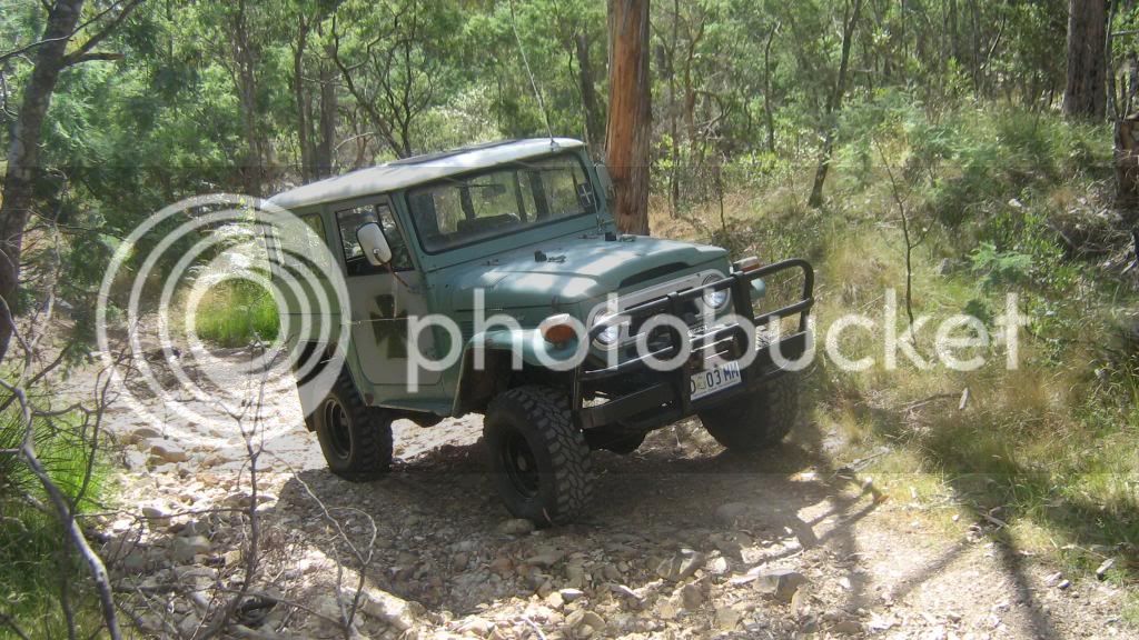

Ive enjoyed it off road,its been used to recover a dirty datsun,35" MTZs bolted back on,the ford 250 crossflow engine is reasonably light,powerful and fuel efficient..

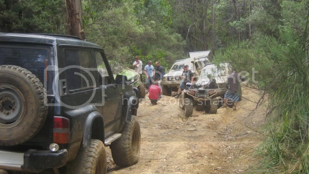

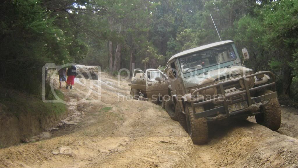

heresa coupla pics of a few of us playing in the scrub :)
I see from the pics you posted--all your trials have not been in vain. You have a truck that is IN FRONT of all those other (things) You gotta be proud!

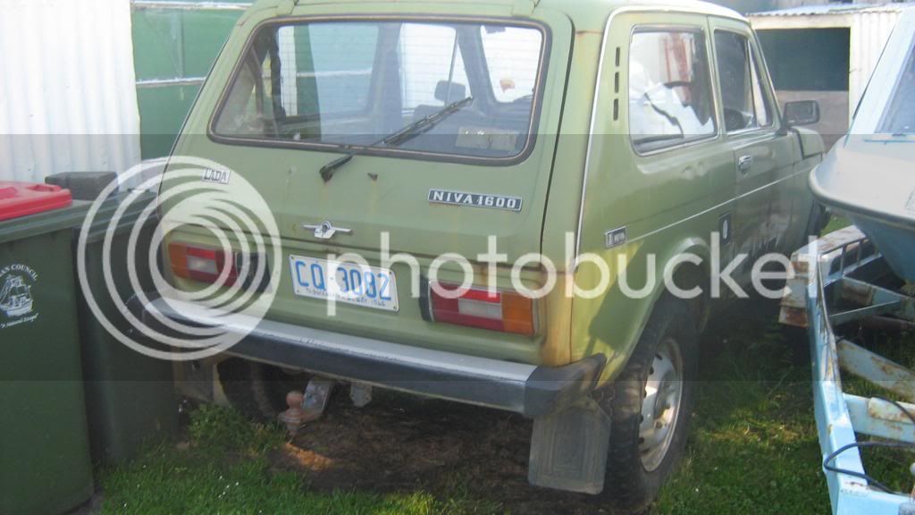

Pics of the lada? :/..for real?...you actually want to see one of these russian horrible little things?...well,you asked for it :/...
Lol - I'm suppose to go tune a Weber on one sometime in Chicago - the guy is an old Suzuki buddy from Uhwarrie board that actually wheels one pretty hard , and it takes it with a smile .
Butt ugly , totally utilitarian but they actually had some good ideas there . I hear the headlight wipers usually run for the first day after purchase , then die a horrible death .
Odd part is the Fiat engine - tough as nails .
Sarge
Yea,mechanically they are pretty solid...but the gearbox is a top loader style bolted to the actual floorpan :/...they are very harsh and the vibrations at revs are terrible...I only drove it once...cost me $60 years ago...only got it coz it had a nearly new battery worth $120 in it :P...so,i got a half price battery,with a free lada :).

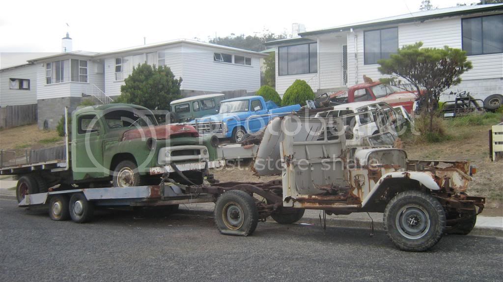

Got another score the other day..swapped an old set of "33 mud tyres that came on an old parts rig i picked up for a 1957 international harvesters 4x4 pickup truck :)...went to pick it up,but I had misplaced the keys to the F100...so,had to hook up the trailer to the sporty shorty,with the standard towbar...luckily I only had to tow it 300 metres...aaand got a puncture on my trailer...is mostly complete,came with all glasswork,missing chrome headlight surrounds but :(..and,I found the F100 keys again :),no more sporty shorty trailer hauler until I sort out a good drop down towbar :)
