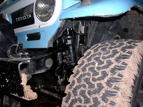

I threw in a picture. You can see where the fender is cut around the PS box, where the box mounts, and the ford shock tower. I stiffened the tower on the side toward the box - I think we had to cut it a little. If you look REAL hard, you can see the weld around the front sode of the plate we welded to the frame.

Correct. You do have to cut the fender and grind the shock tower. People have used a ford shock tower because it is taller and narrower. I dont like that. I want the MAF 2 1/2 towers ground. I can only weld with acetylene. So I want a bolt on job.
