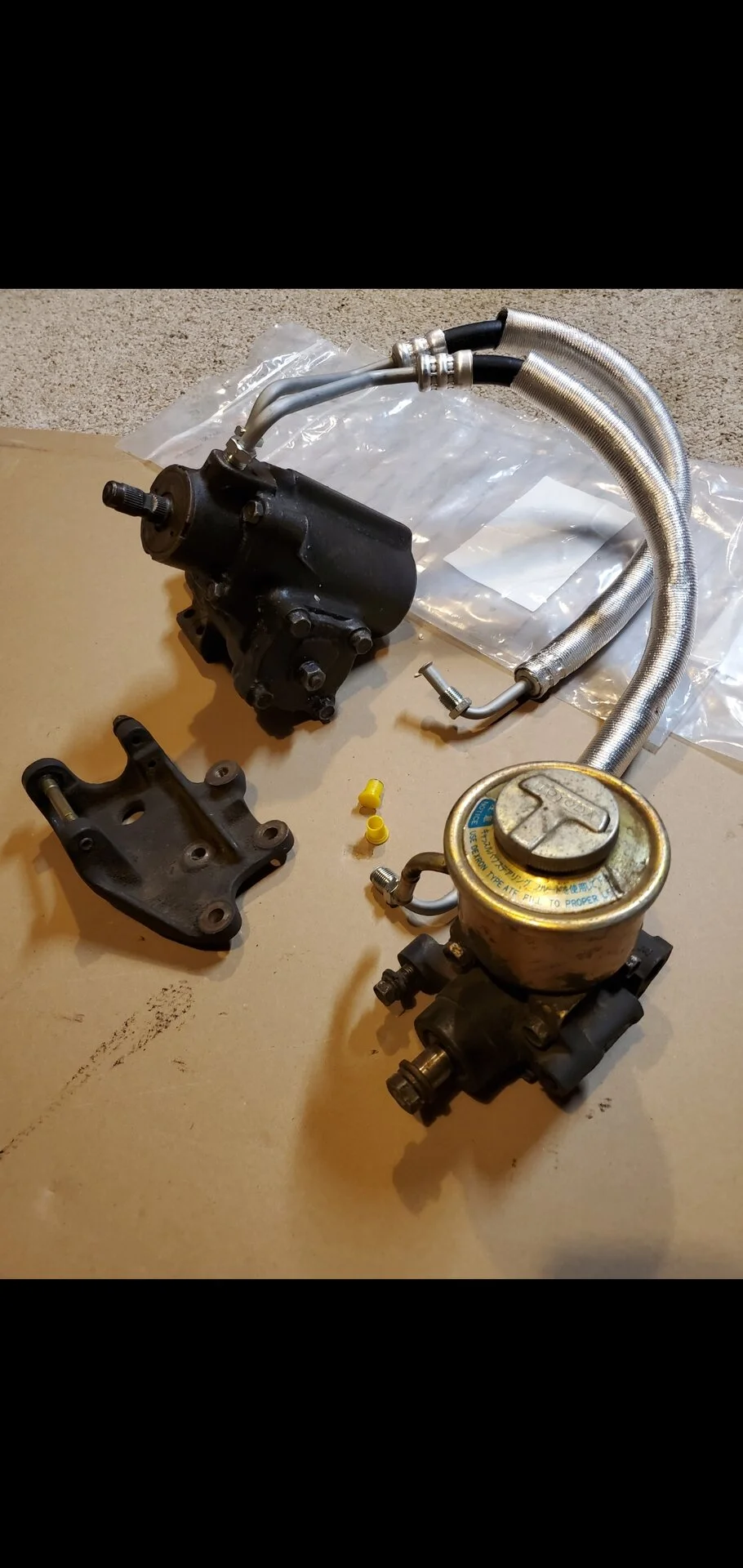

I just posted a pic. Reference it with the box you purchased on fleaBay..

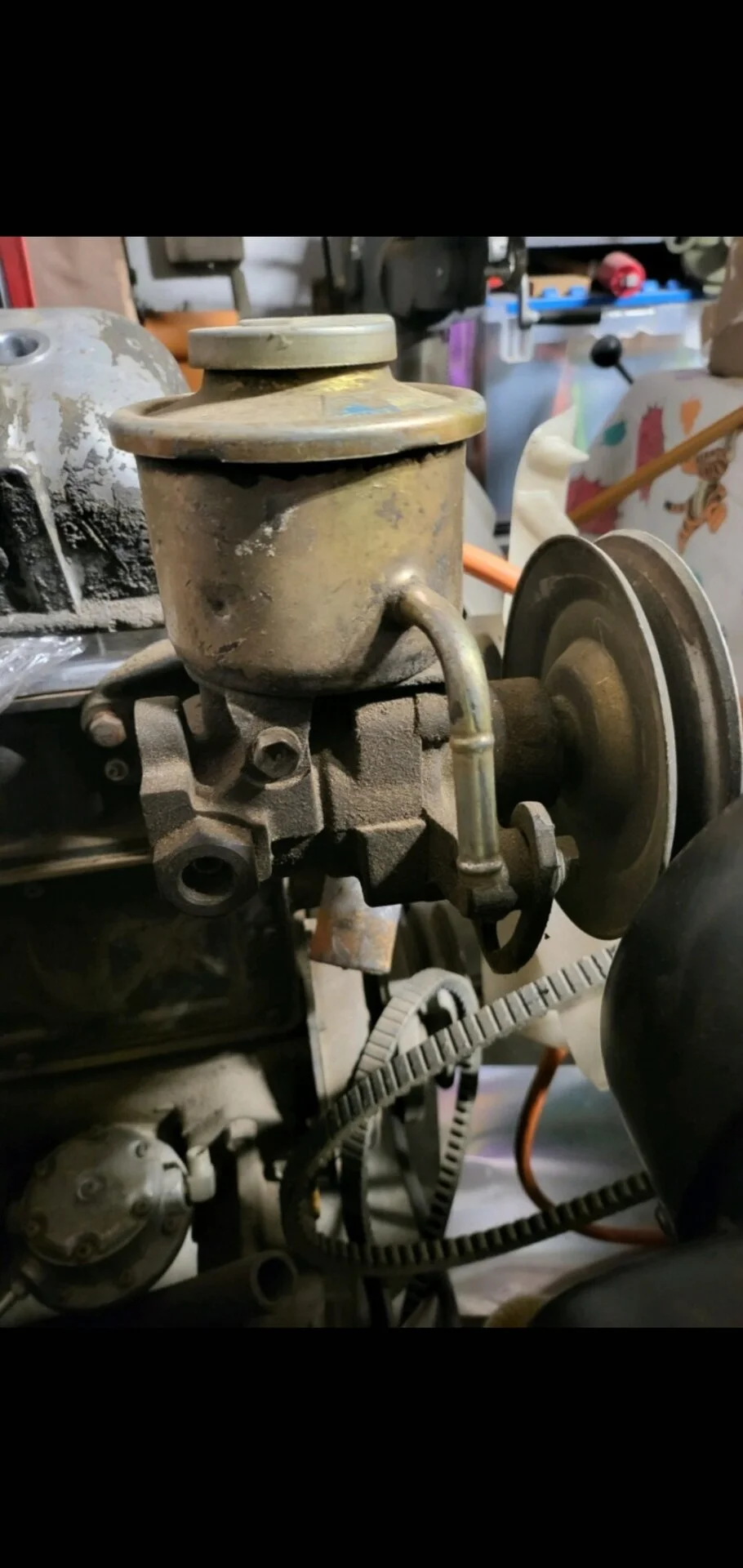

The ps pump bracket in the pic is not for a 2F
Thanks for the insight George. I have a box full of brakets and assumed this was the proper (passanger side mount) he needed. Any idea what this set up is then?
Thanks for the insight George. I have a box full of brakets and assumed this was the proper (passanger side mount) he needed. Any idea what this set up is then? View attachment 3557978
That’s for a carb’s 3F. Typically found on CA and SA cruisers. Mostly 70-series.
