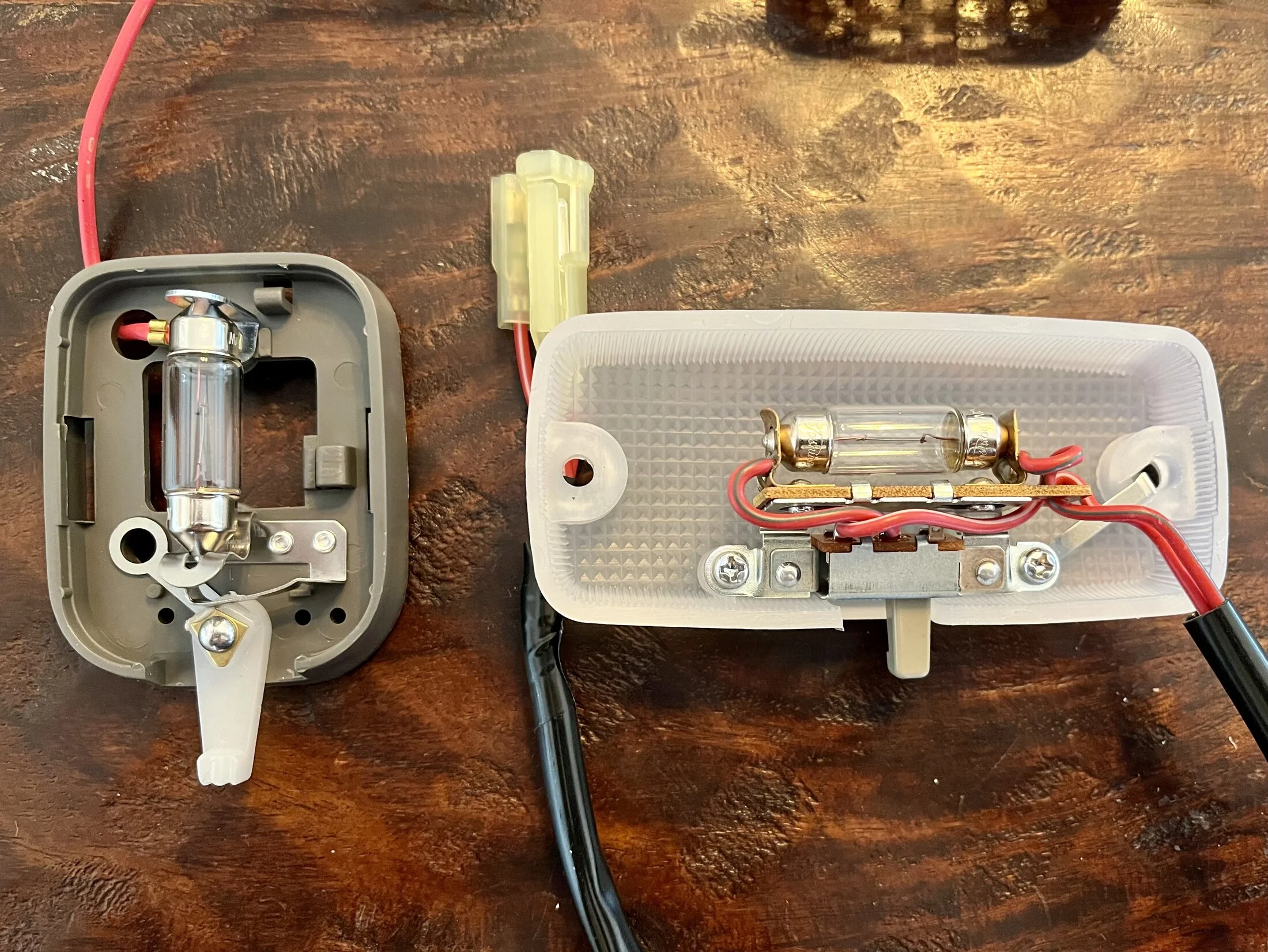

Here's a pic of the finished result if you want to make the call to read on or not: :)

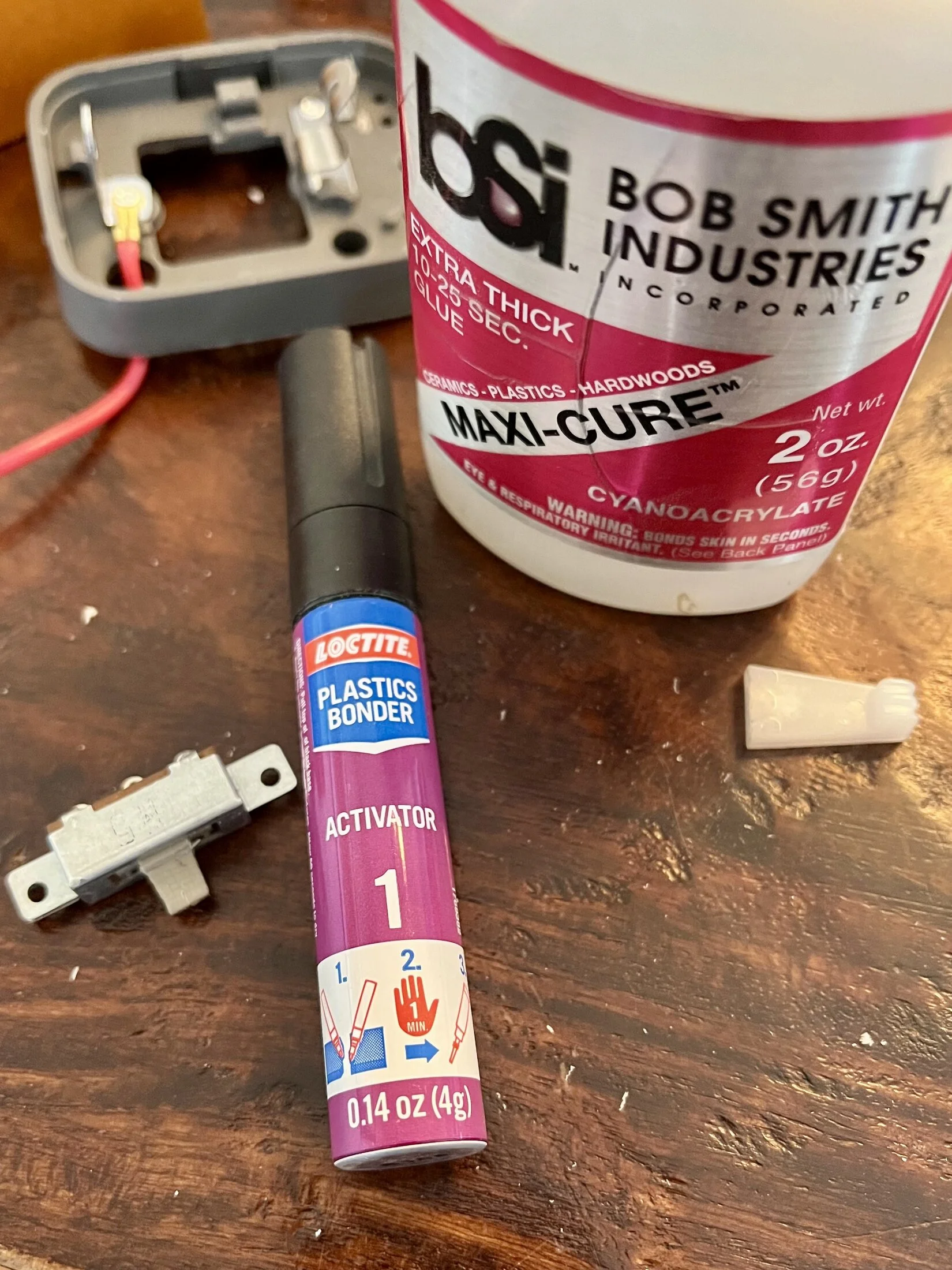

  • Super glue / plastic activator

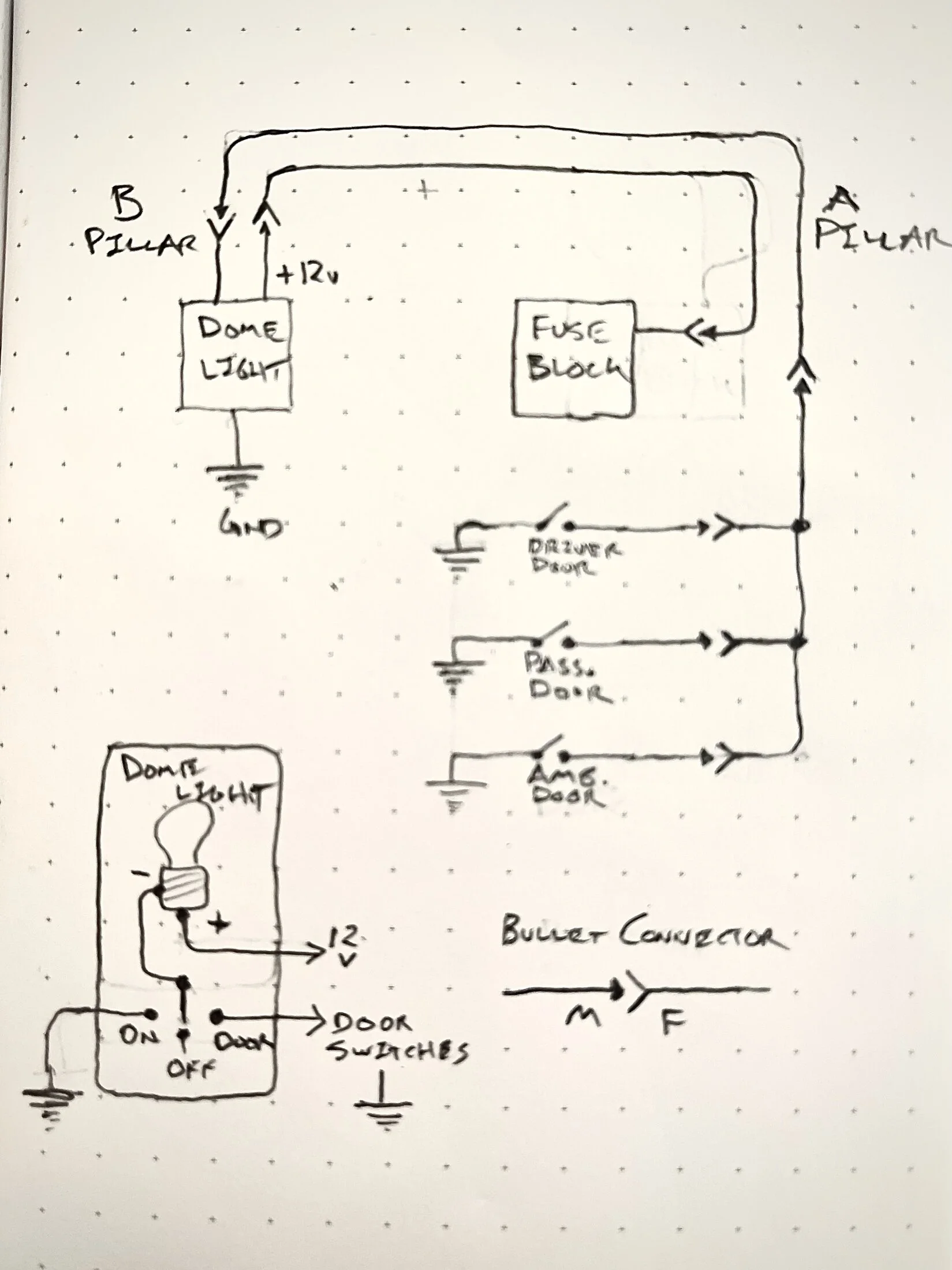

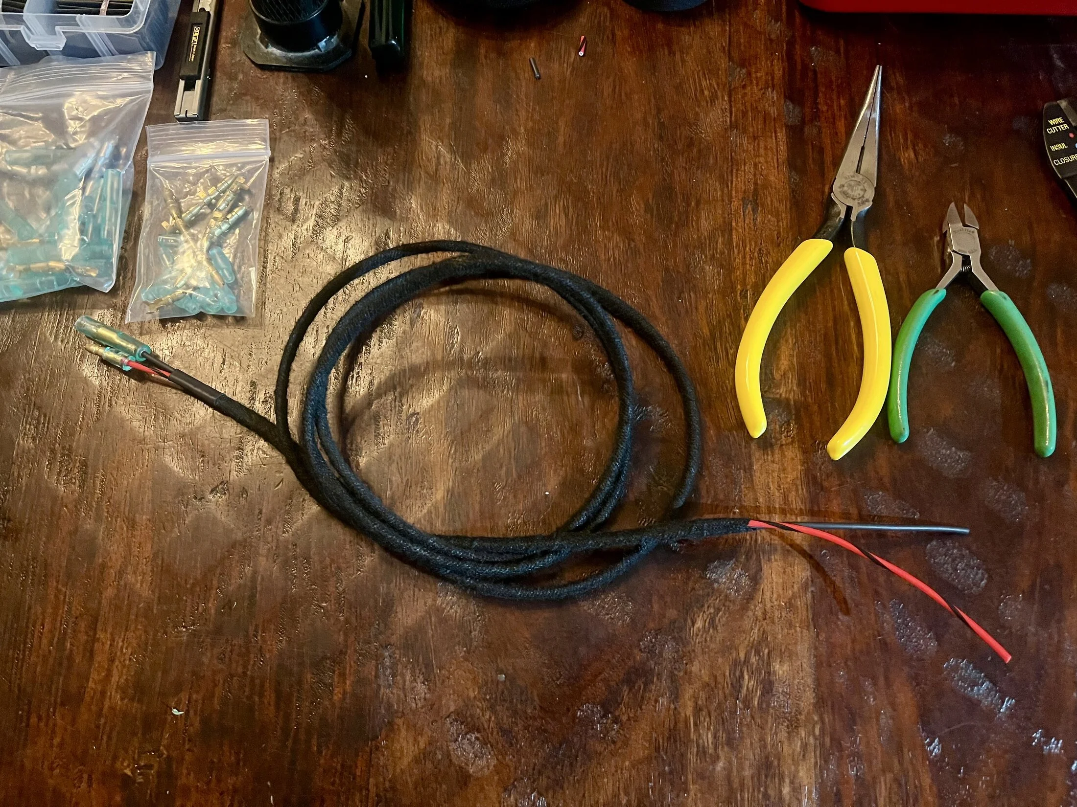

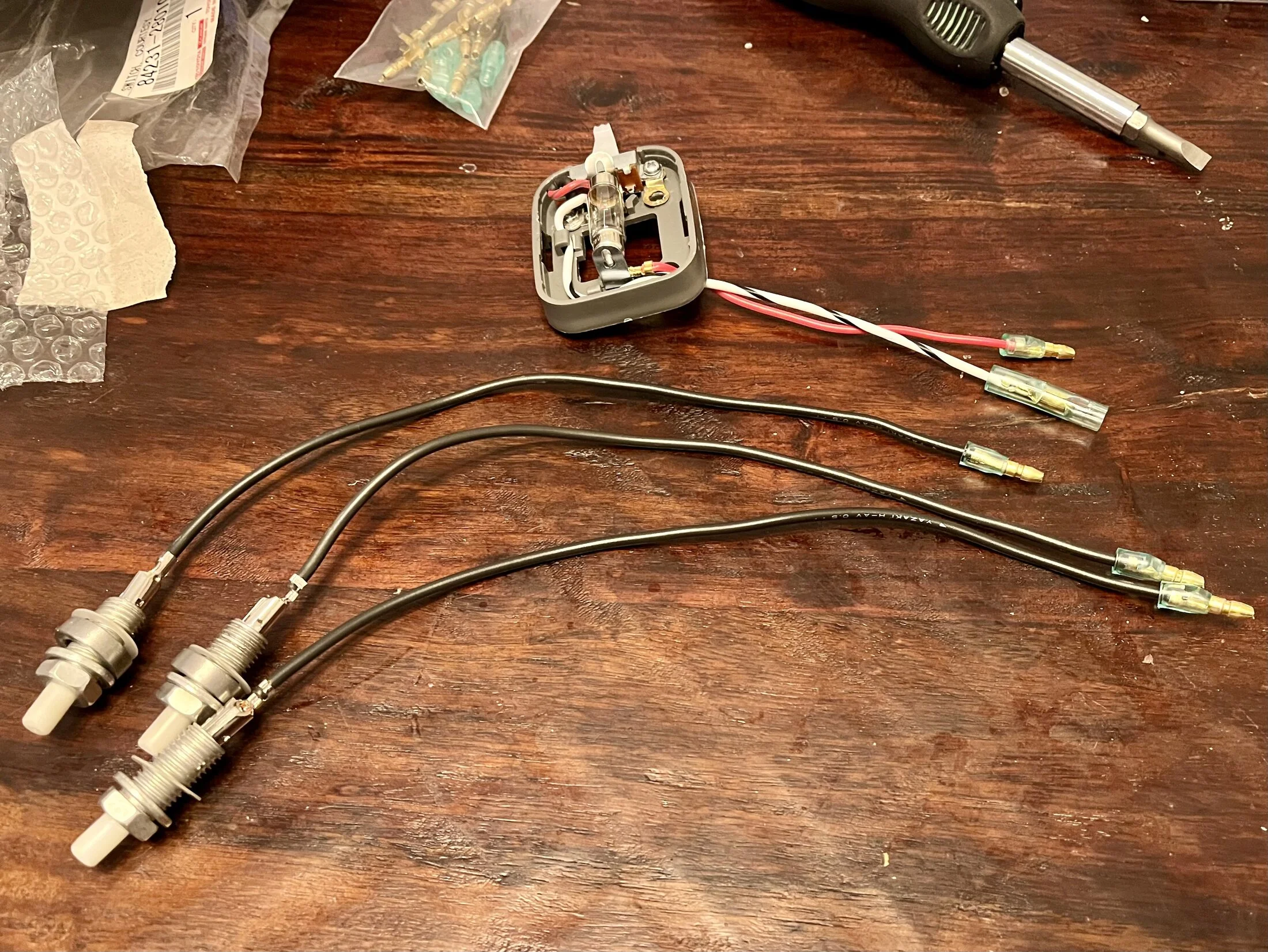

The Wiring Plan
For starters, let's talk about how the dome light will work in this configuration. The pressure switches rely on a connection to ground through the body/chassis, so the dome light must be switched on the ground connection, not the 12v+ source. This is consistent with the current setup for the stock dome light, which also switches ground (which in the stock configuration, is also grounded to the B pillar through the mounting screw). You will need to add an additional lead through the A-pillar, above the door and down into the B-pillar for this switched ground. See the below diagram:

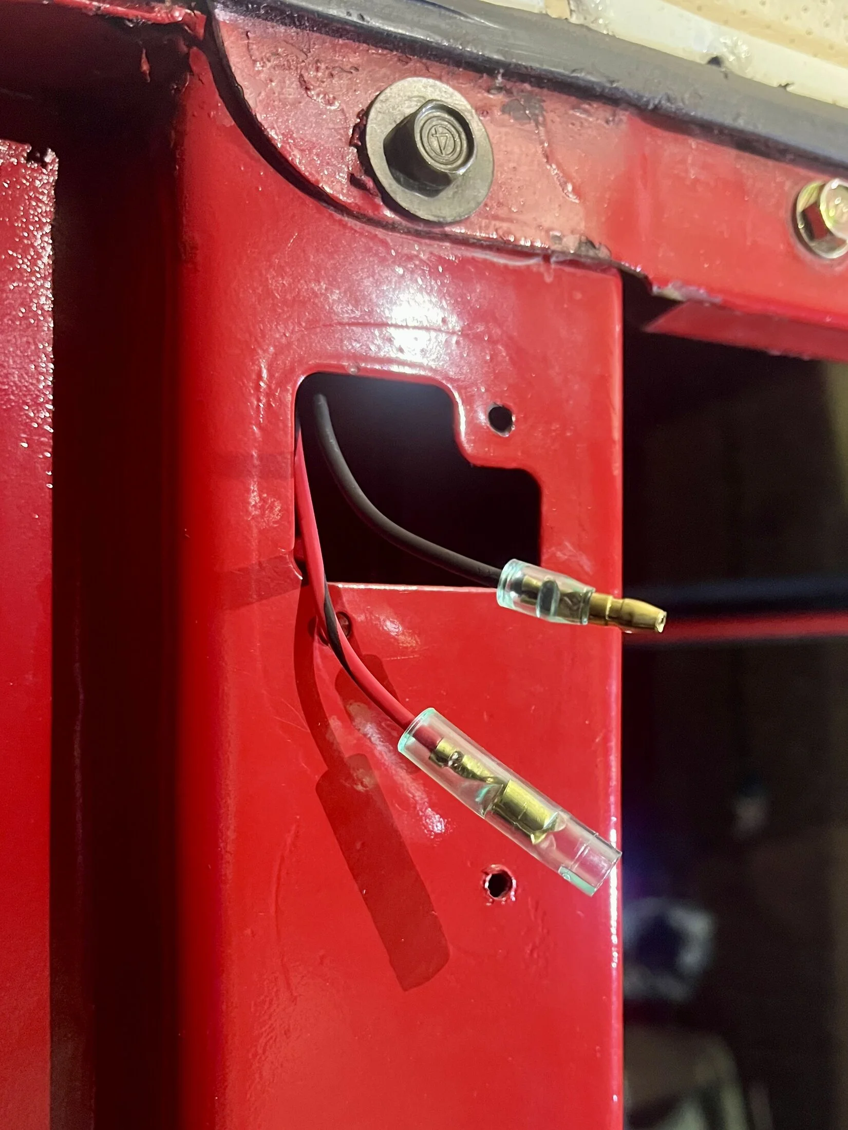

A couple notes on bullet connectors:
  • Be mindful of directionality of the connectors (which end is male / female). Toyota designed the stock setup such that if the dome light is disconnected, the loose power lead won't short against the chassis. When we add the new wiring for the switched ground, we need to think in the same way: If you were to temporarily remove one of the pressure switches, you want to ensure the loose connection won't ground against the chassis and turn the light on (when in "door" setting). The above diagram shows the M/F orientation of each lead (look for -> >- notation)
  • The additional connectors at the fuse block and below the A-pillar are to allow the hard top to be removed. I found additional points as I ran wiring along the harness (on the engine side of the firewall, and on the interior side under the glove box) that could potentially justify additional connectors if you were to remove parts of the wiring harness. I opted not to add these additional connection points, my thought being that I'll add them later if I need to do major wire harness work.
  • The pressure-switches do not come with bullet connectors, to keep it all consistent I converted them all to male bullet connectors, but you could leave them as-is and use the mating connector type (I am not sure of the name of this connector, however)

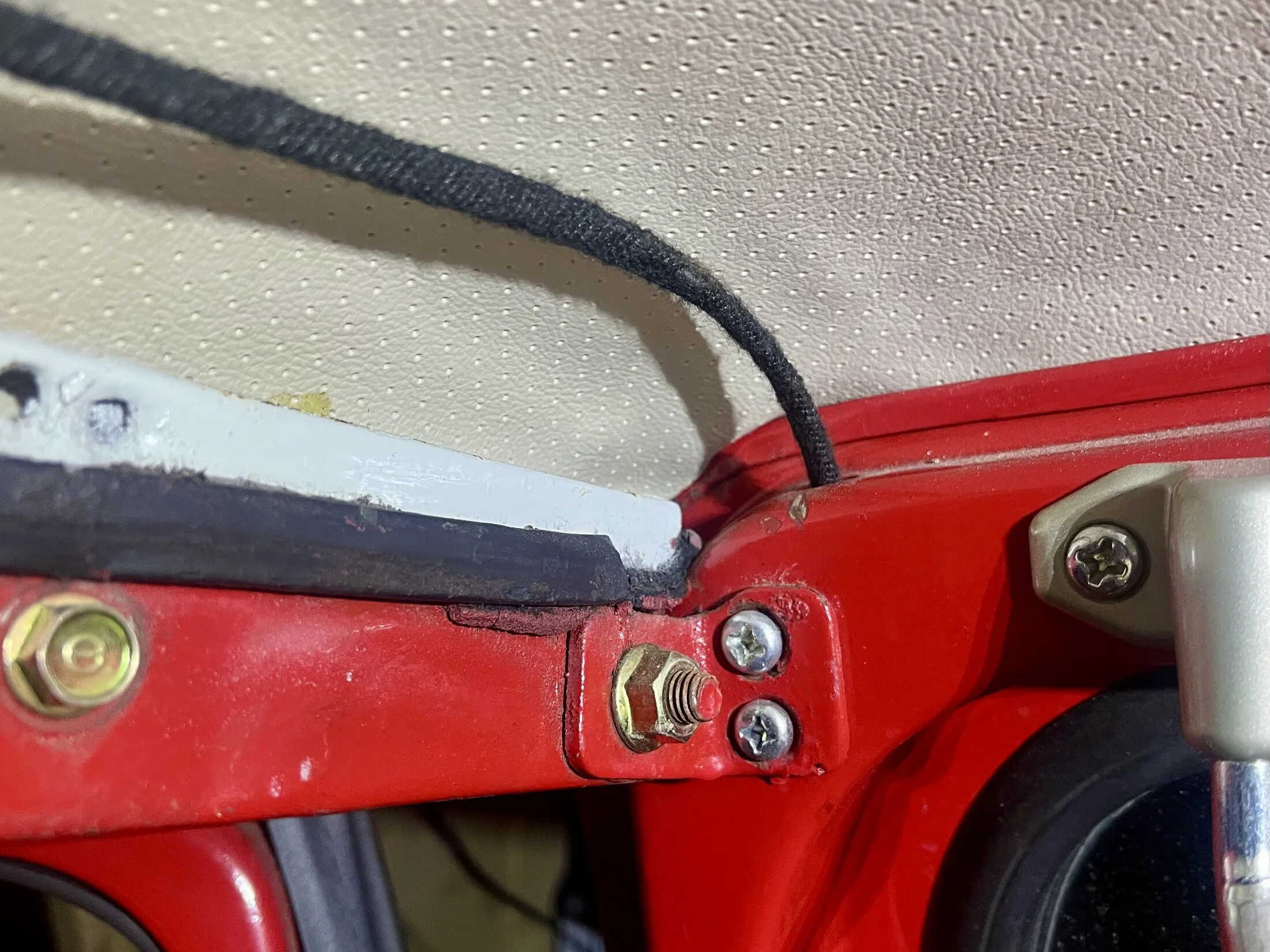

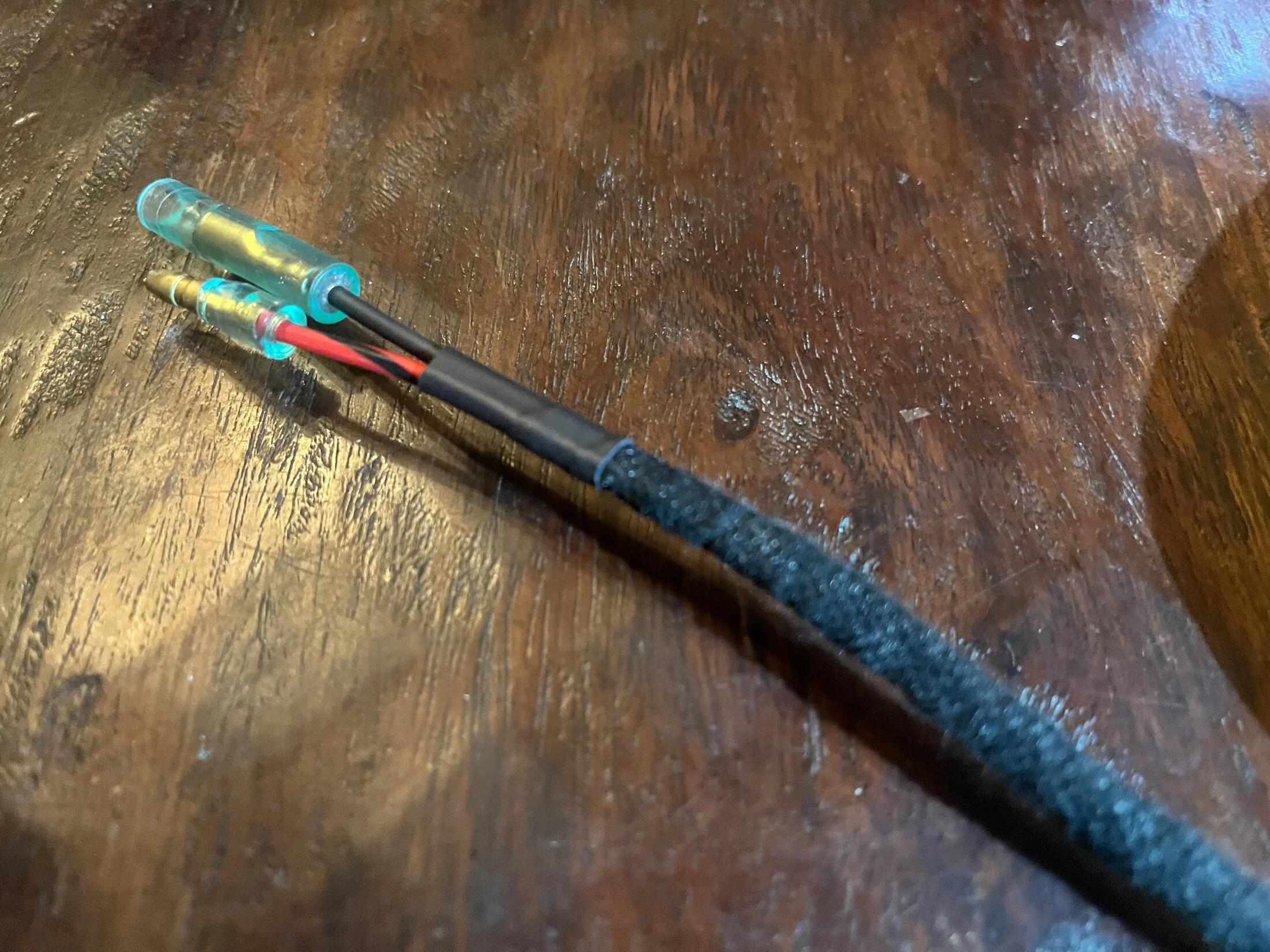

Here's a couple shots of the dome light, pressure switches and completed harness (for the A-pillar, above-door run, and contains +12v and ground leads, wrapped in wire loom tape):
Note: I did not leave the loom like this, this is just to illustrate the path. The wire loom tucks neatly inside the top of the hard top behind the flange.

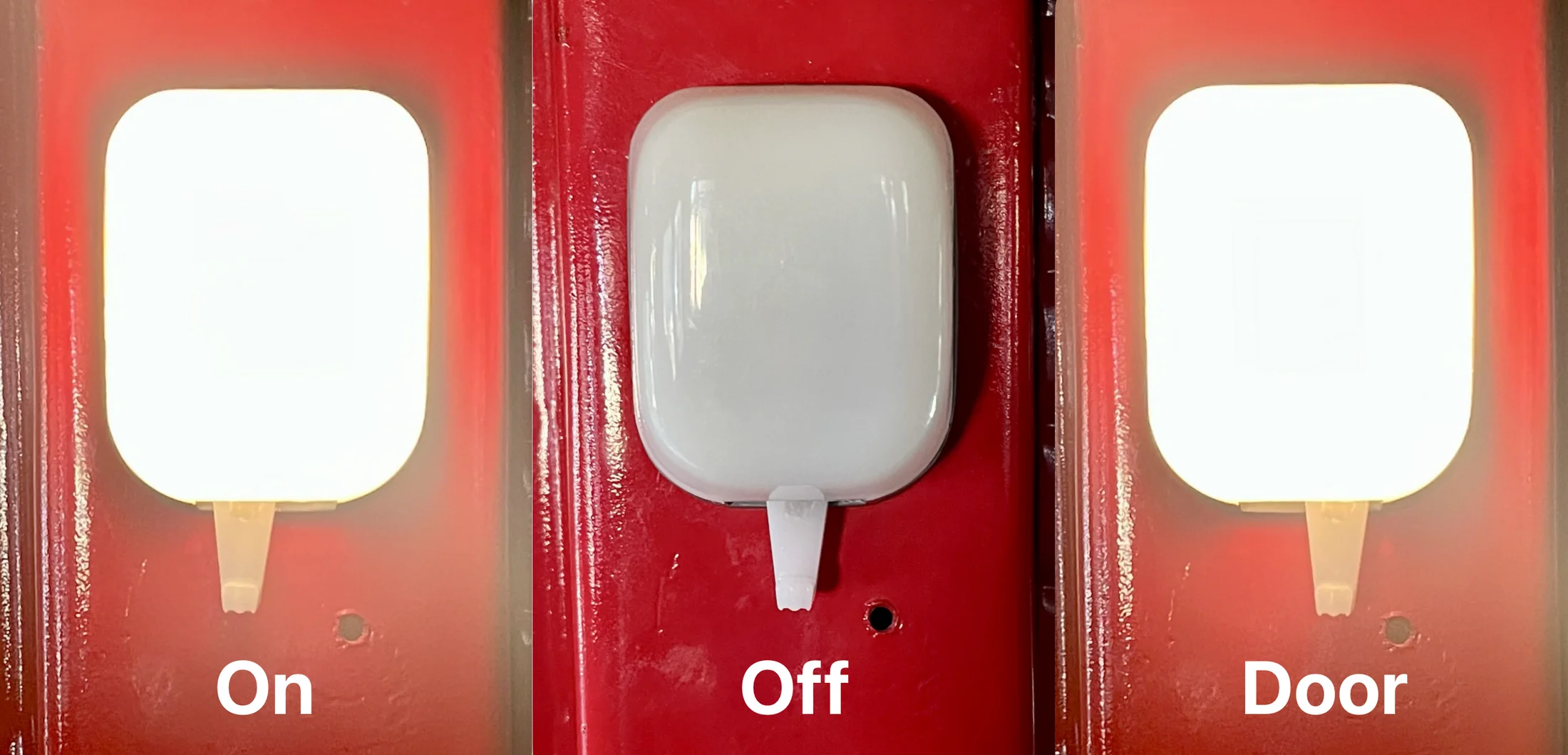

  2. Gain the "On/Off/Door" functionality

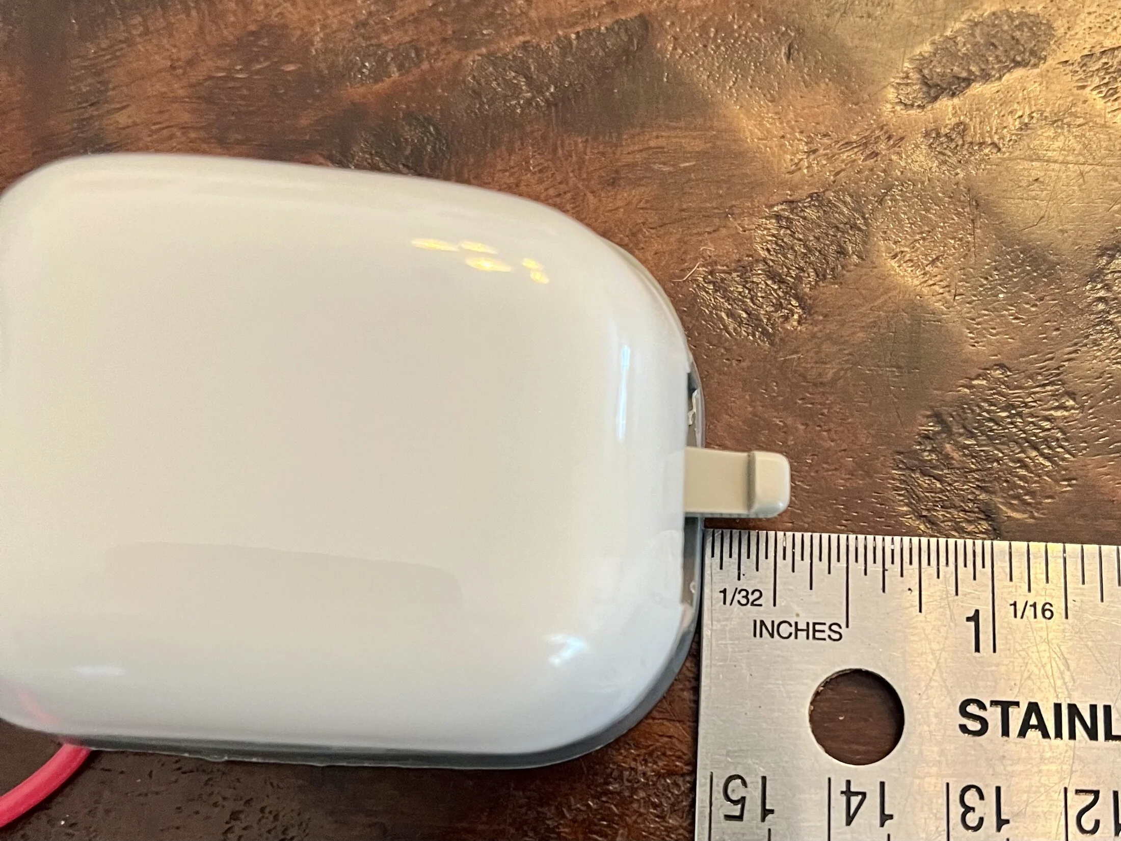

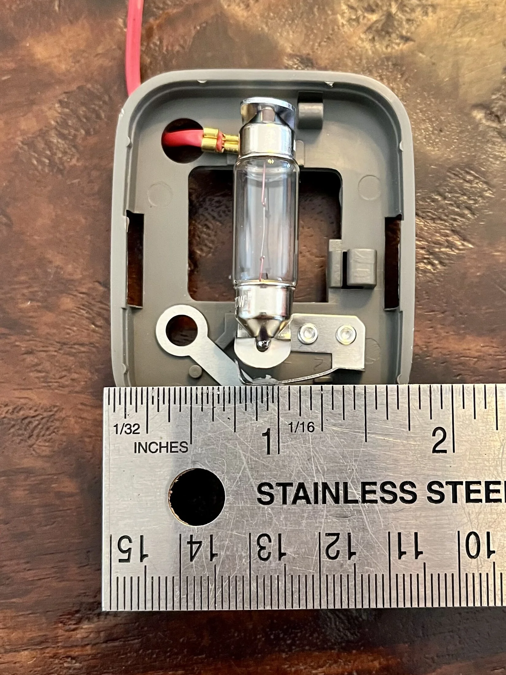

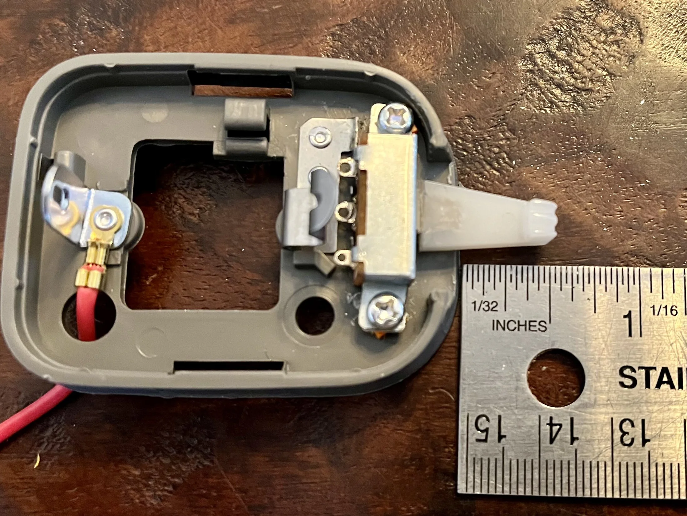

For starters, I took a look at the innards of the stock lamp to get a lay of the land, and note the dimensions of the switch lever:
The lever protrudes from the body of the light by ~1/2". Also, note the open lug where the mounting screw grounds the light to the body. Now, let's look a the FJ60 light:

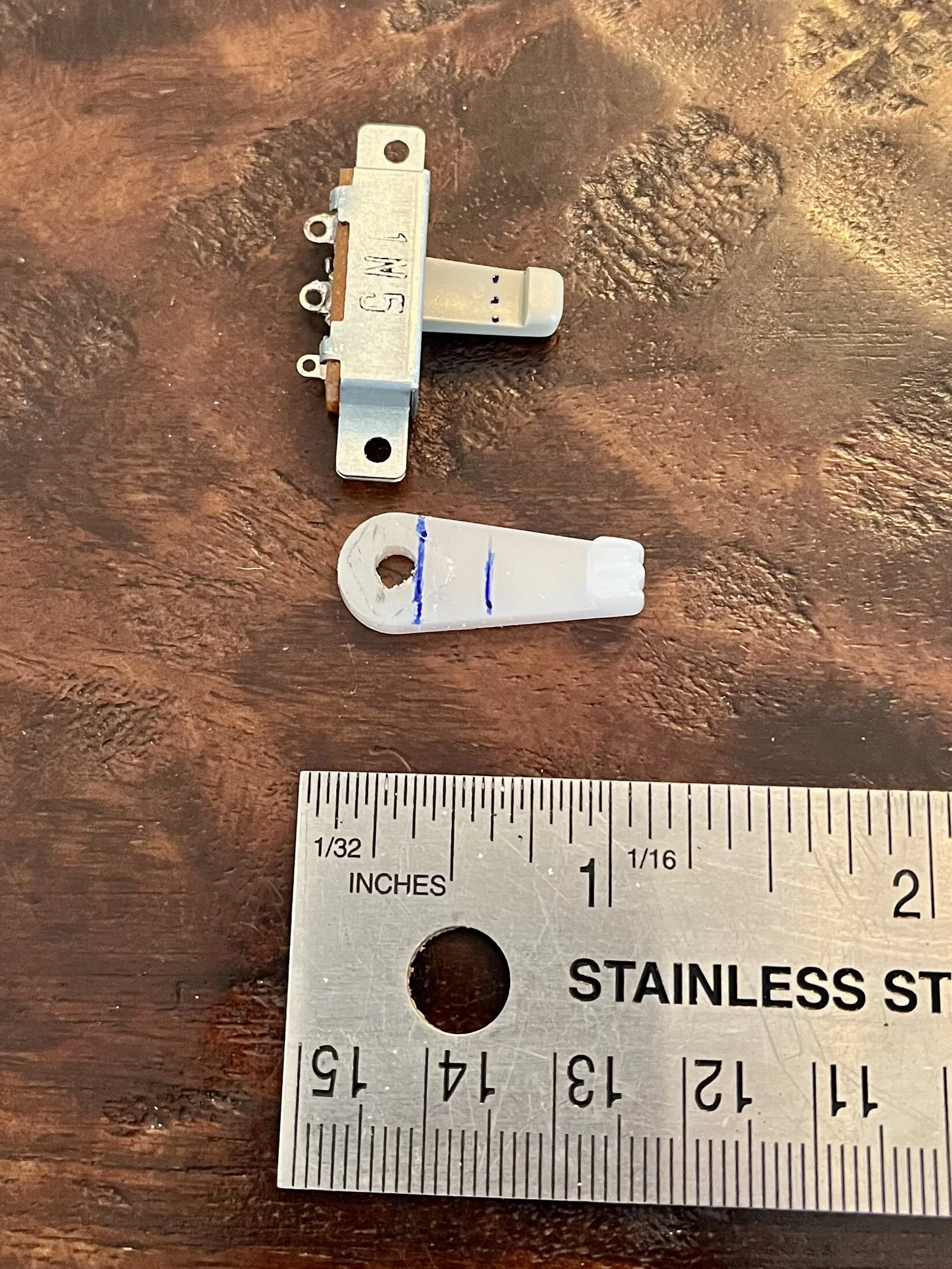

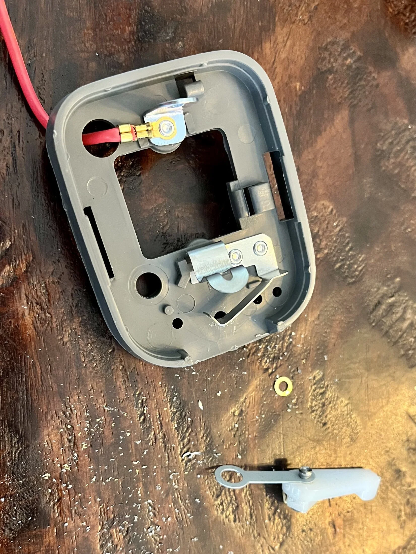

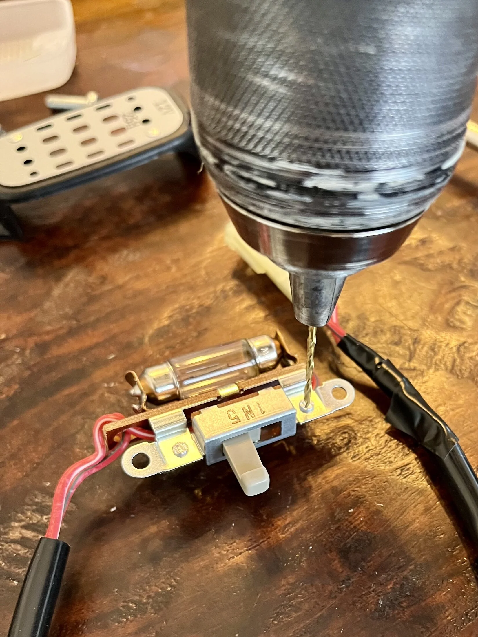

There are two rivets that hold that electrical switch to the armature of the FJ60 light (which is then attached to the plastic body with screws). The spacing of the screws is too wide to fit into the FJ40 light, so I will drill out those rivets to use the holes on the switch itself. It turns out to be a pretty good fit for the empty holes on the FJ40 light (see the smaller holes next to the switch lever on the FJ40 light). I also drilled out the rivet on the FJ40 light to remove the lever:

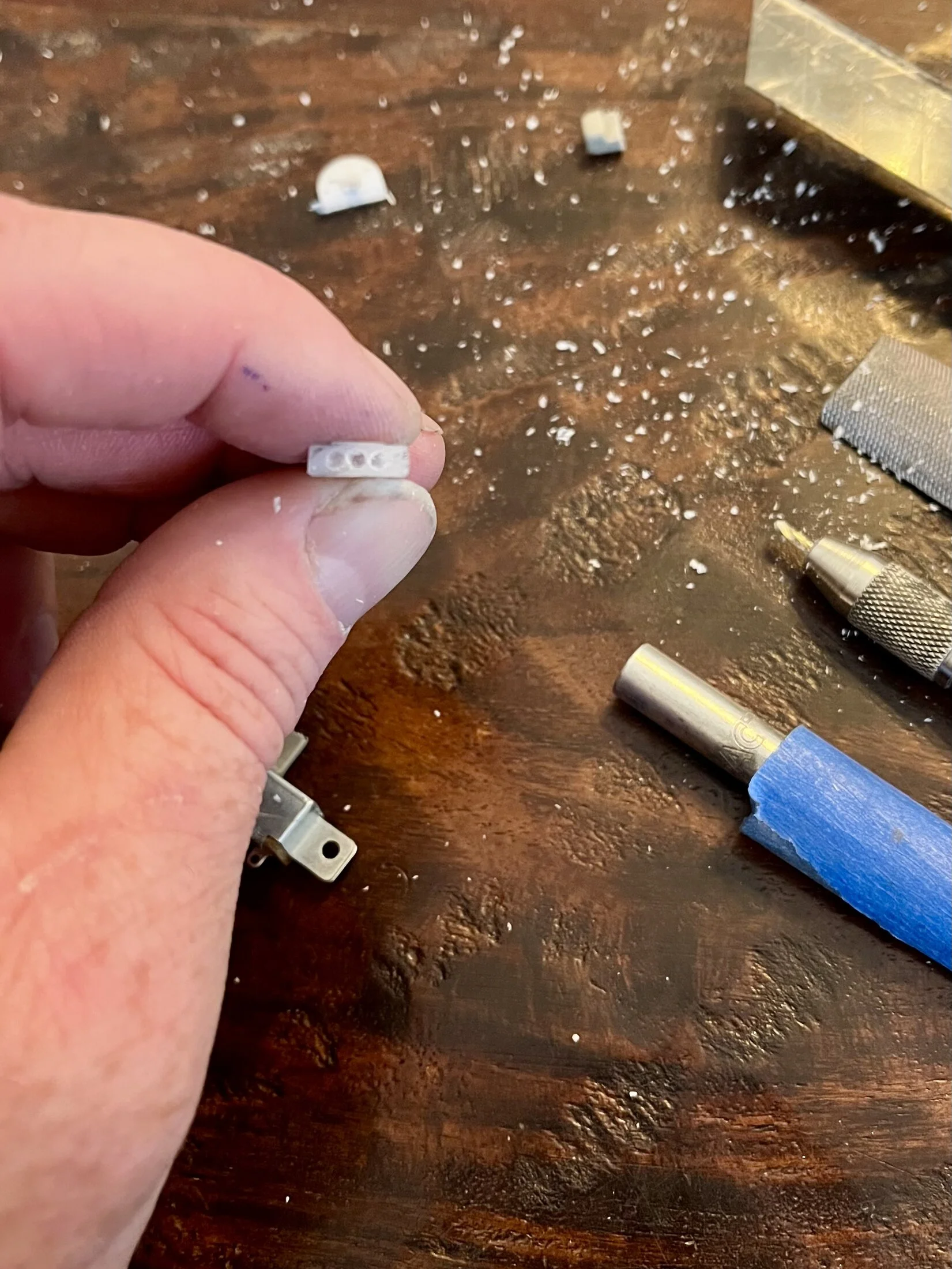

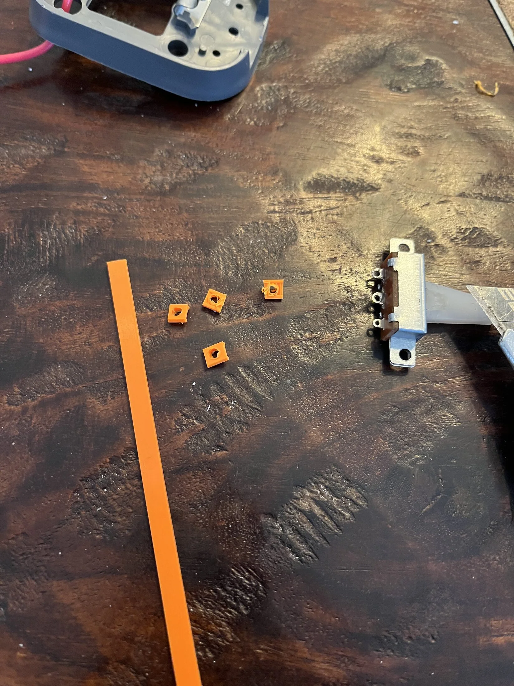

Next up, I wanted to mount the lever from the FJ40 light onto the switch from the FJ60 light. I ended up using what can basically be described as a mortice-and-tenon joint, and this was by far the most fiddly aspect of this project. If you have a pin vice, small files and an exacto knife, this is doable, but take your time. I would not recommend opening up the FJ60 switch further, as the lever is not separate from the switch internals (very fiddly to put it back together). best to keep the unit as-is.
I measured the two switch levers to figure out where to cut, then cut & filed the FJ60 lever down to act as a tenon, and drilled / cut the back of the FJ40 lever to act as a mortice. This took a lot of back and forth, and I was careful not to stress the plastic of the FJ40 lever by forcing it. I kept testing / filing / cutting until I was happy with a nice friction-fit. Then, I roughed up both mating surfaces, and used a plastic-compatible super glue to mate them together:
I started with three holes drilled using the pin-vice, then used a ground-down x-acto knife (like a chisel) to make it into a single hole / mortice.

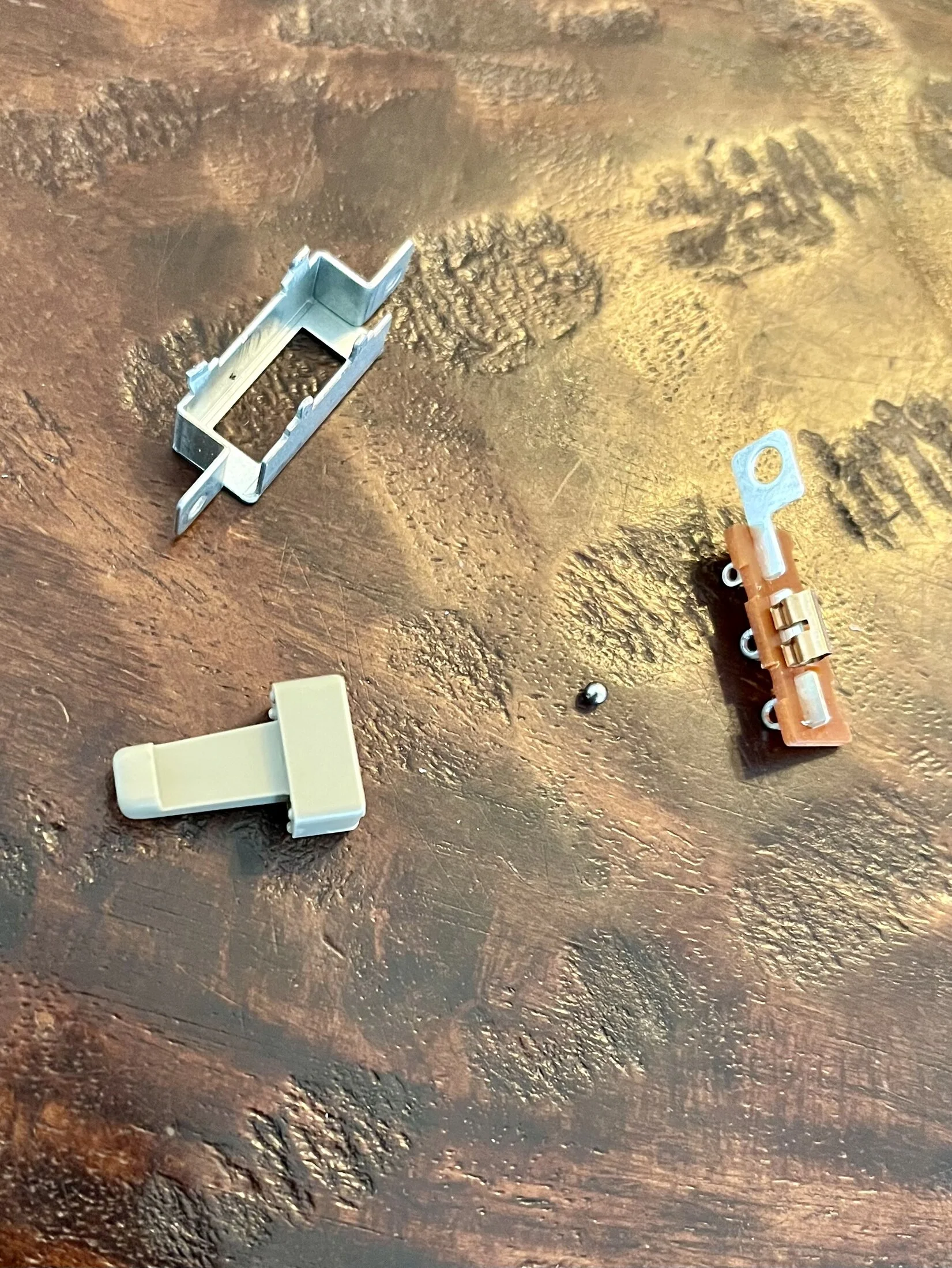

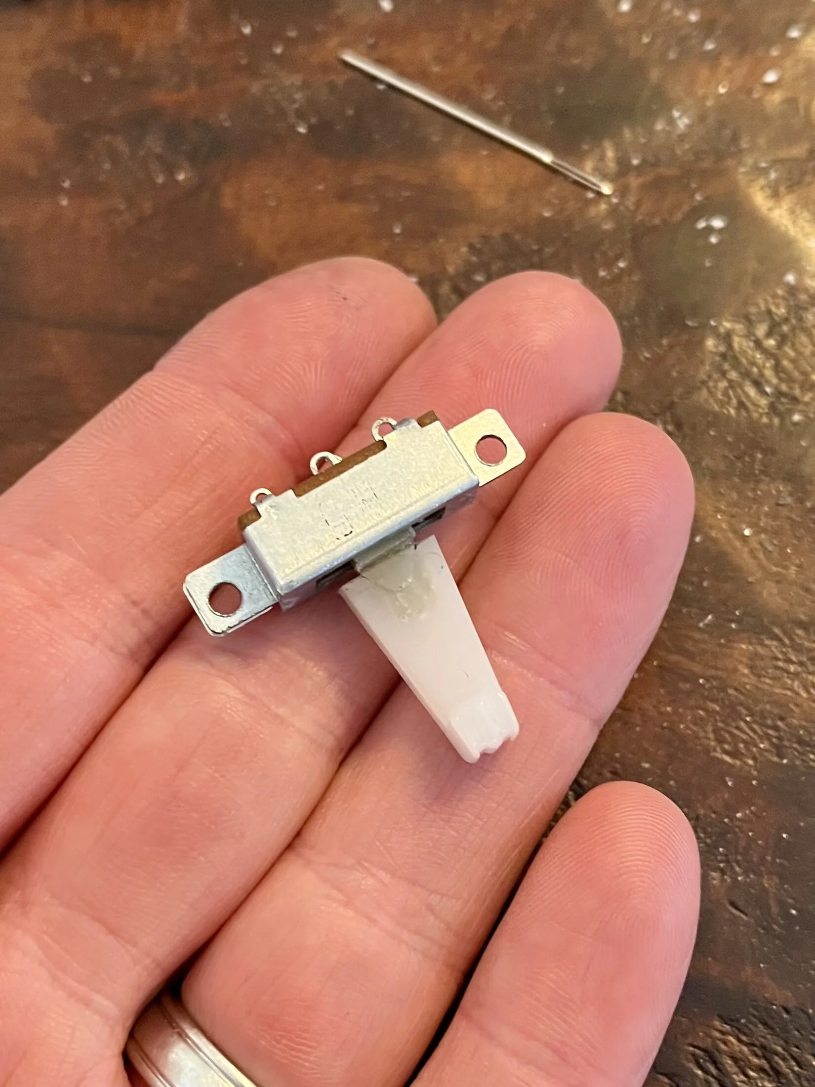

And as noted above, if you want to see what the inside of that switch looks like, here you go (I do not recommend taking this switch apart, as it's not needed for this project. I was curious / hoping to avoid the mortice-and-tenon work described earlier):

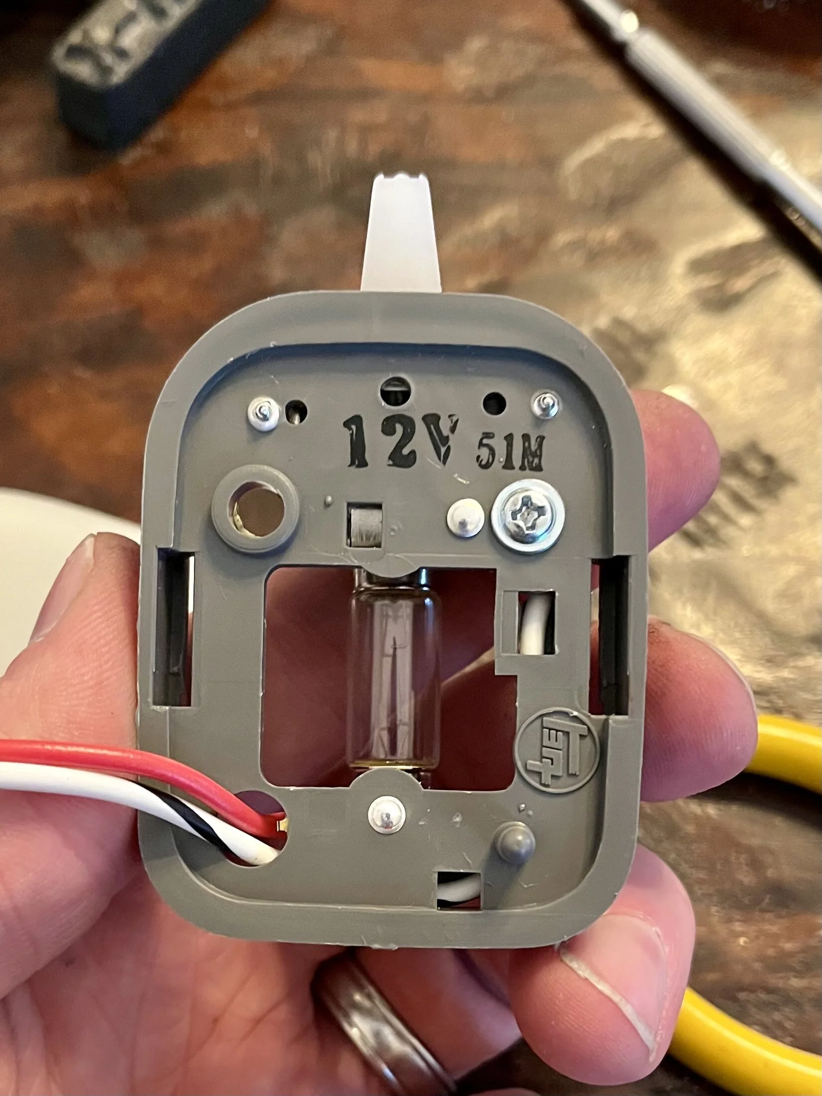

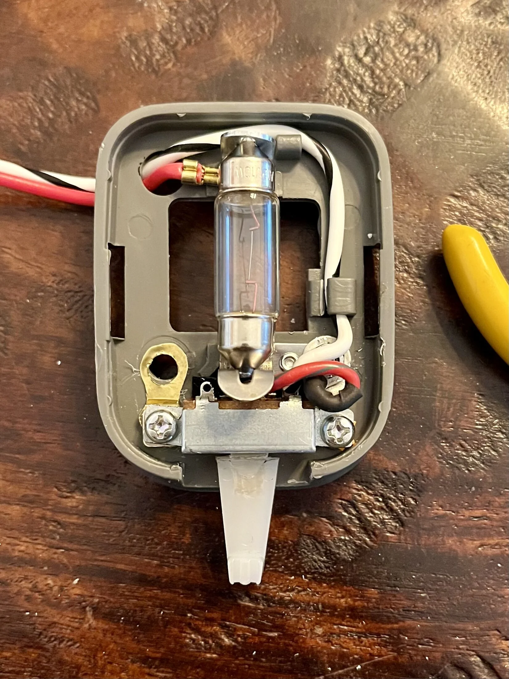

Next up is assembly. Interestingly enough, there are tabs to route wires for the later-model FJ40 lights (that had the "door" setting), but alas it is just the plastic frame that has this functionality. We'll use those tabs for our own wire routing.
You'll note the janky brass hoop connector there. I tried to use the existing hoop connector from the FJ40 light (see earlier photos), but I was not able to get the bends I needed and drill a hole through it for it to mate up with the body of the switch (important here, as it saves some wiring: The "on" position of the switch is bridged to the frame of the switch itself to make for an easier connection). After trying and failing to use the existing part, I made one out of some scrap brass sheet I had laying around. If you are careful, you should be able to use the hoop connector from the FJ40 light, just be more delicate than I was.
The "door" position on the switch is soldered to that black/white wire, which uses the helpful tabs Mr. Toyota gave us. A note on the connection to the sprung post which holds in the actual bulb: Try as I might, I could not solder anything to this, and I didn't want to ruin that part lest I lose the ability to hold in the bulb. my solution was to drill out that rivet, use another hoop connector, and screw it to the plastic. It's not ideal, maybe some of you folks could tell me why I couldn't solder there.
I had to create spacers in order for the switch to sit properly on the plastic frame. I made them from drilled zip ties in this case. Just note that the hoop connector that bridges between the metallic switch body and the mounting screw for the dome light has to be on top of the spacer, or you won't have connectivity and the "on" setting won't work:
Here's the finished wiring from the back:
I used tiny little course-threaded screws that I dug out of my hoard of computer-building parts. I think if you had access to the same sort of tooling to do rivets in the same style as the stock light, that would work much better and be real clean, but I am new to the rivet scene. Again, an improvement for a future iteration perhaps.

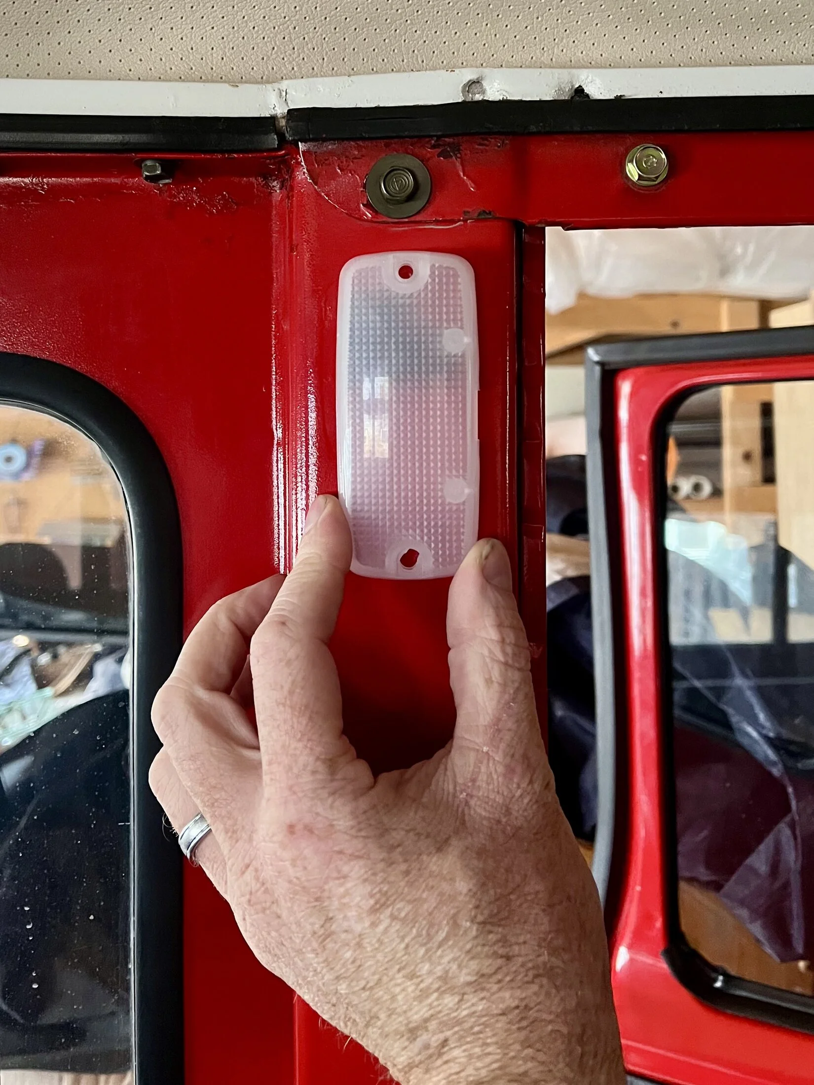

Lastly, as an alternative to this whole thing, I had considered what the FJ60 light would look like against the B-pillar. For reference, this is how it would have looked. Not bad, but not great, and it would require modification to the body of the light or the B pillar, neither of which I wanted to embark on:

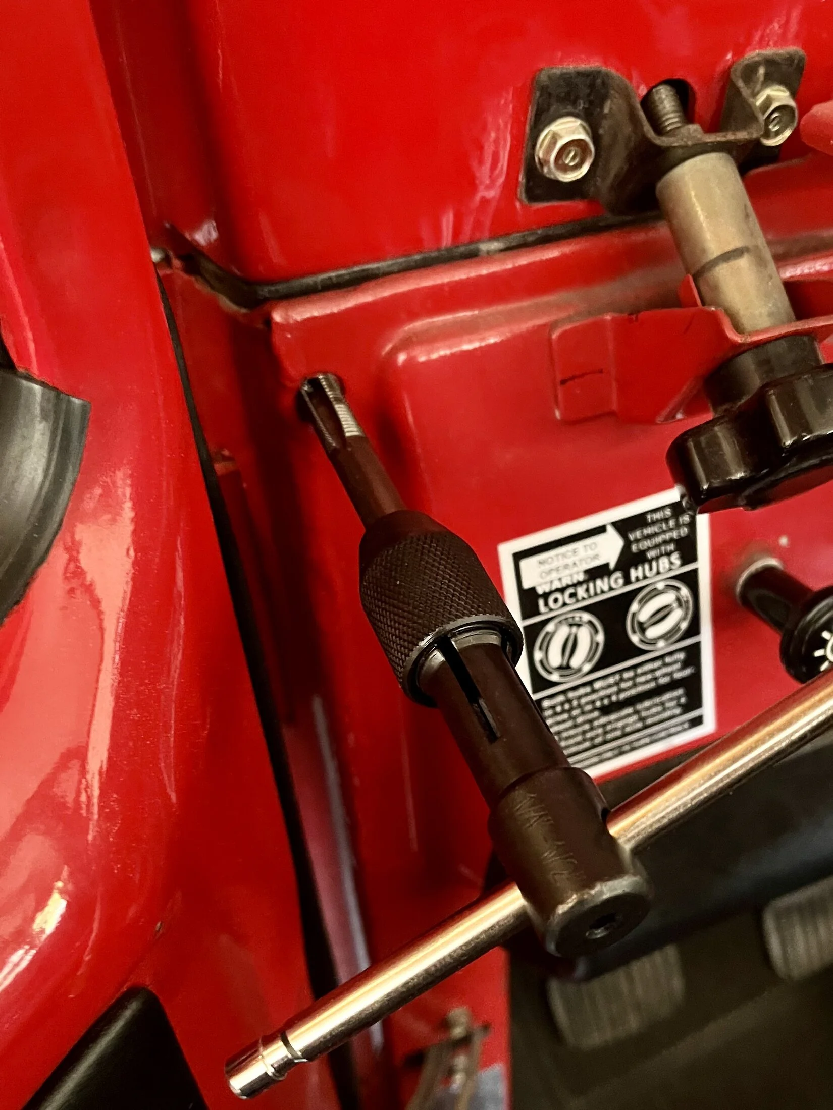

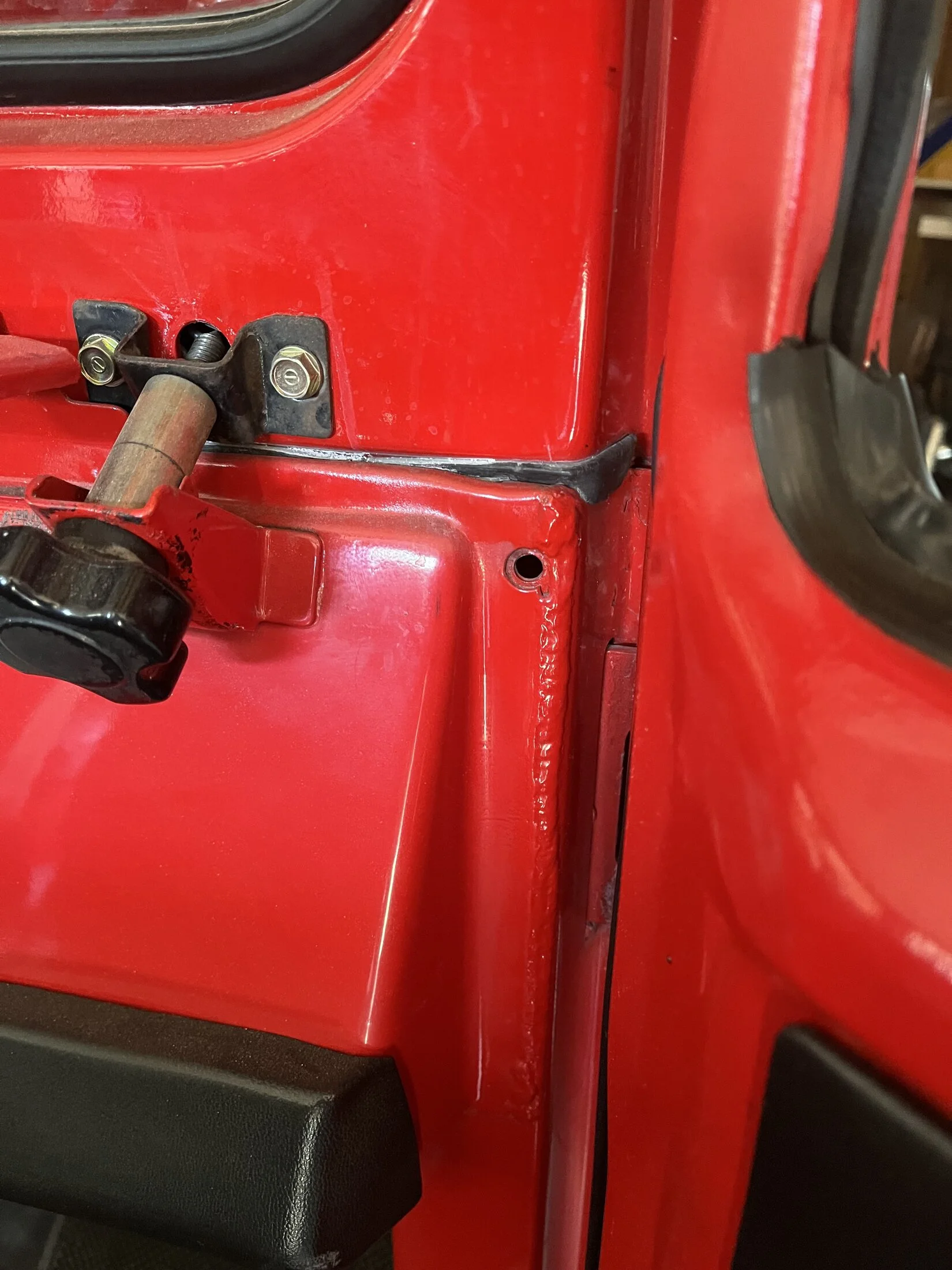

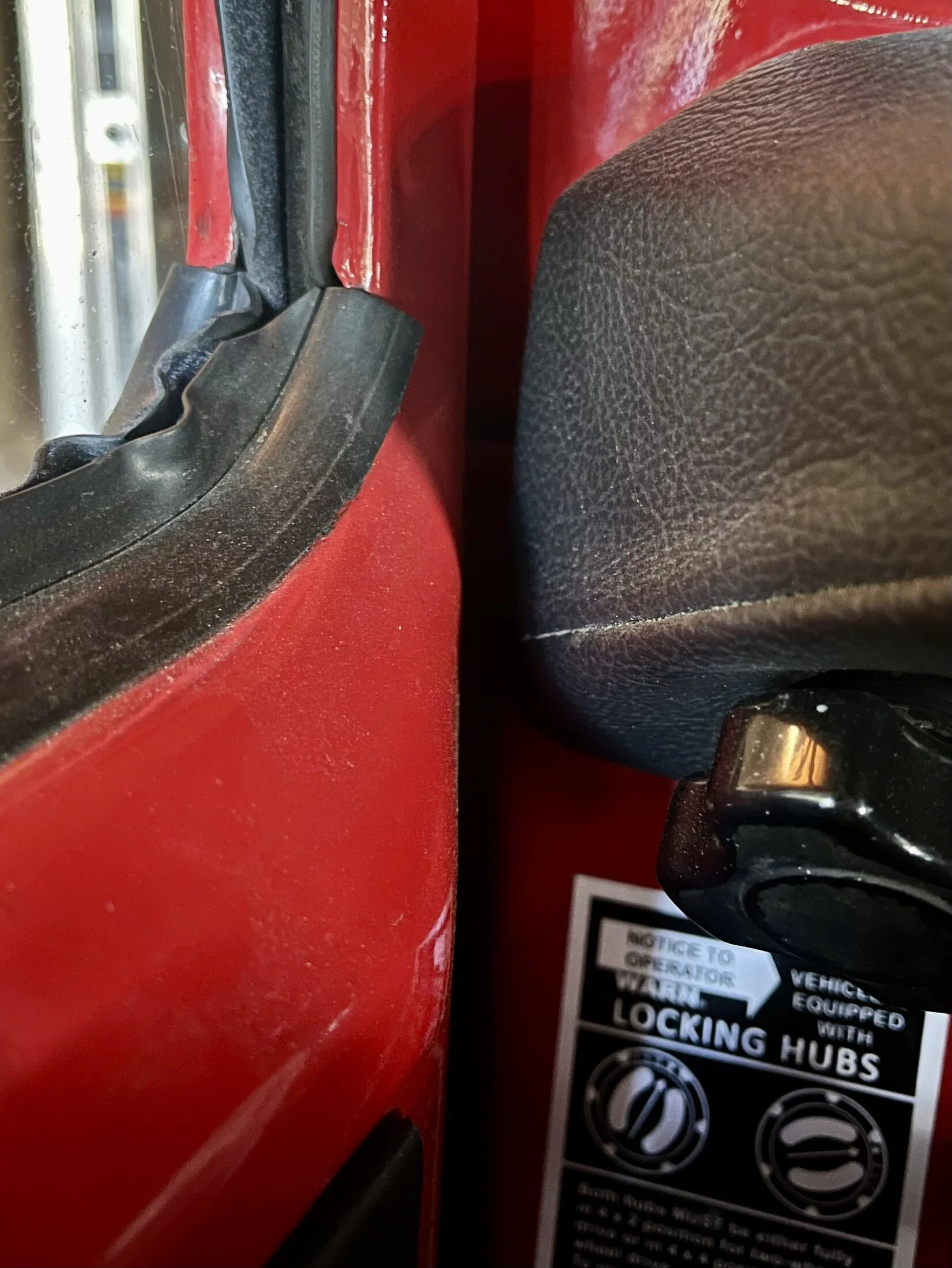

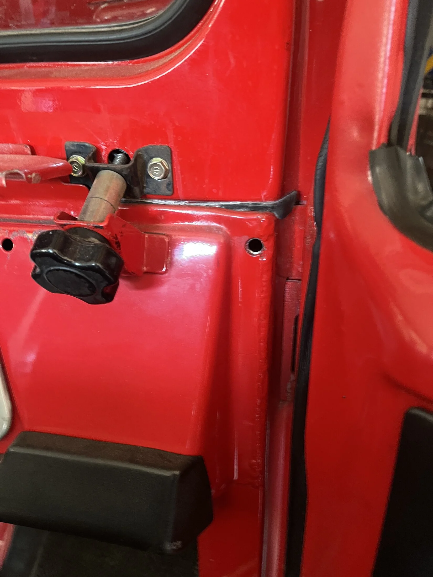

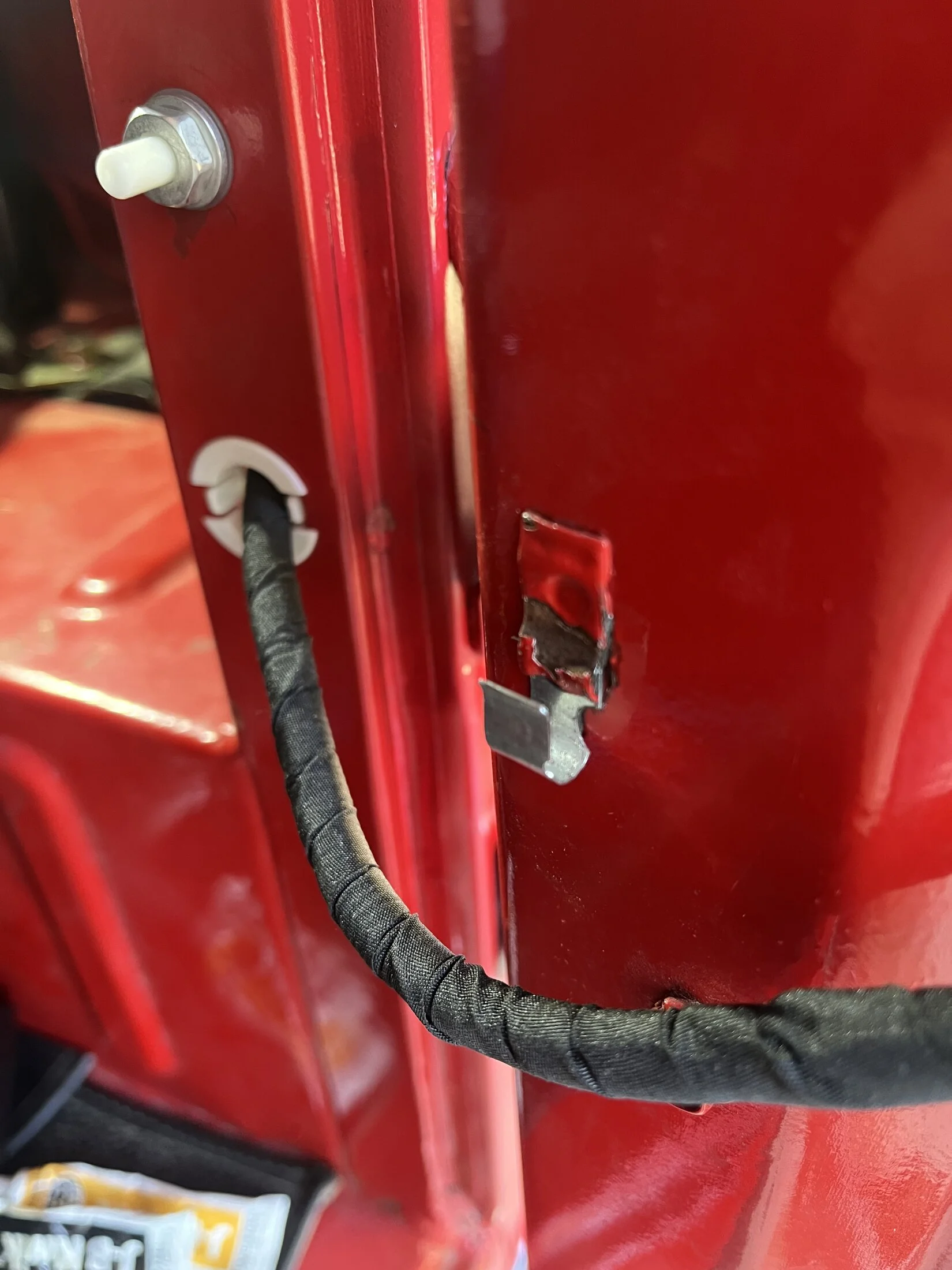

The pressure switches require an M10x1.25 thread to screw into the chassis. I wanted switches on the driver door, passenger door and the passenger-side ambulance door (my tire carrier is on the driver side). I didn't feel it necessary to add to both ambulance doors as the kids really only use the passenger side one to get in/out of the truck.
Another big consideration for me is that I didn't want to add holes to the truck that weren't there. Also, my truck being a '78, I do not have the "nubs" on the door to activate the pressure switches, so the stock location for late-model '40s was likely not going to work for me.
In the end, the ambulance door was the easiest. I'm not sure if this hole is stock or was added from a previous owner, but it was already drilled out to around 11/32, and was an easy pick for tapping:
On the driver/passenger doors, I found a small threaded hole on both sides up towards the top of the dash. I have no idea what these holes are for, and they may / may not be present in your truck, but they worked for me. Do note, if you plan on putting the pressure switches elsewhere, make sure they have enough room on the inside to actuate properly. I found some holes in the base of the A pillar near the floor that looked like they could work, but would have required drilling in order to get enough travel for the backside of the switch. Here's the hole I ended up using (same on drivers side as well):
I did some measuring, and was convinced it would work, albeit with some spacers. Here it is after embiggening it to an M10x1.25 thread (pictured to show that this really wasn't much of a violent act, haha):
Here's some minor violence on same hole on the driver side:

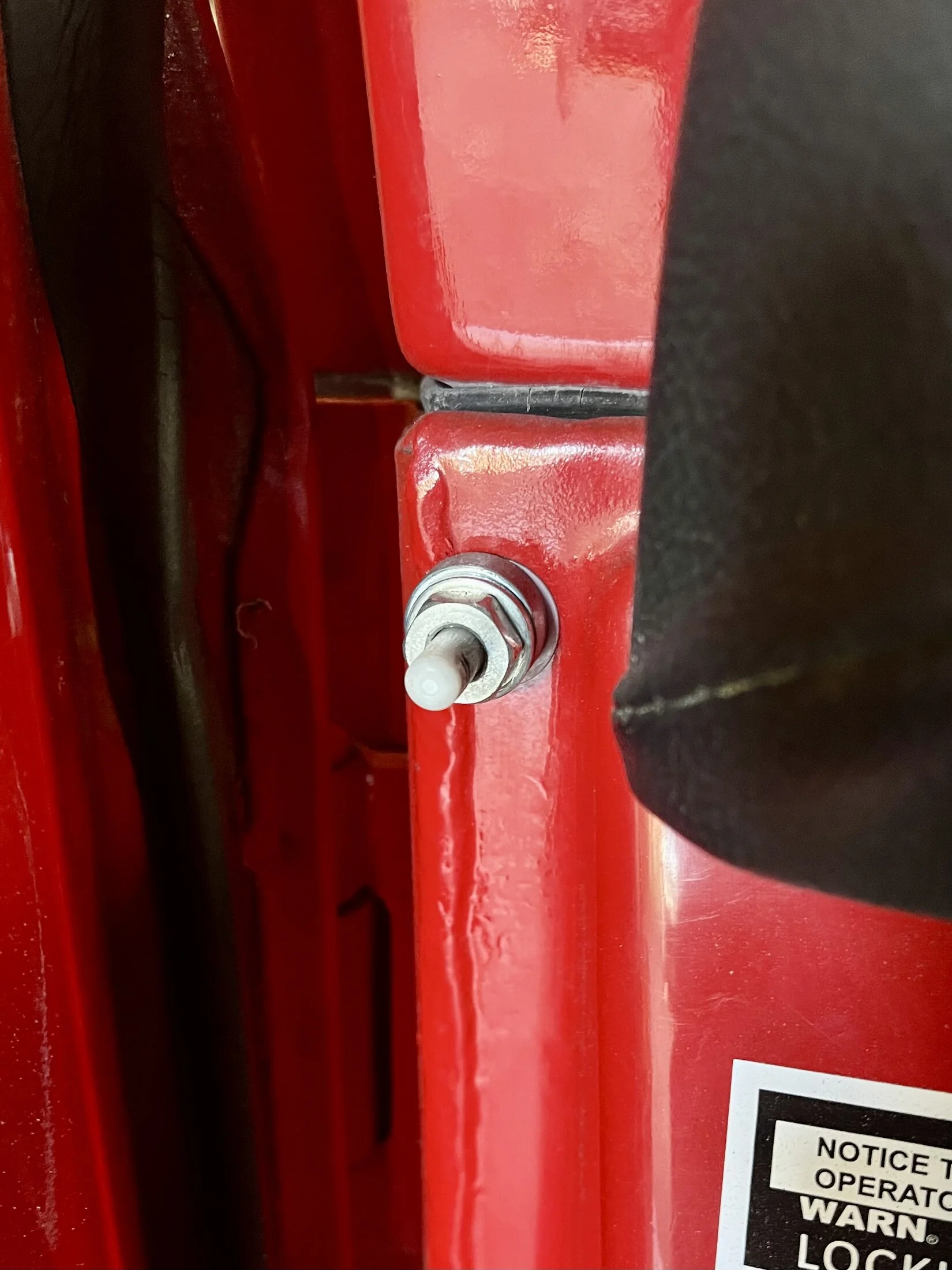

In the end, I did need about 1/8" of a spacer for both front doors to get the switch to actuate properly (none needed for the ambulance door). As I don't have access to a lathe, I took some M10x1.25 jamb nuts, drilled the threads out, used another (threaded) nut to hold them into a bolt, and chucked the whole setup onto my drill. After some judicious use of an angle grinder and some files (aka the redneck lathe), I have two convincing spacers, and I don't think it looks half-bad:
I do need to center the plastic washer a bit better, and I think I'll paint the switch (mask off the white plastic part), but once the door is closed you can't even see it (assuming you have the dash cover):
And that's it! It works exactly as it should now, and here's a nice completion shot of the job all finished:
