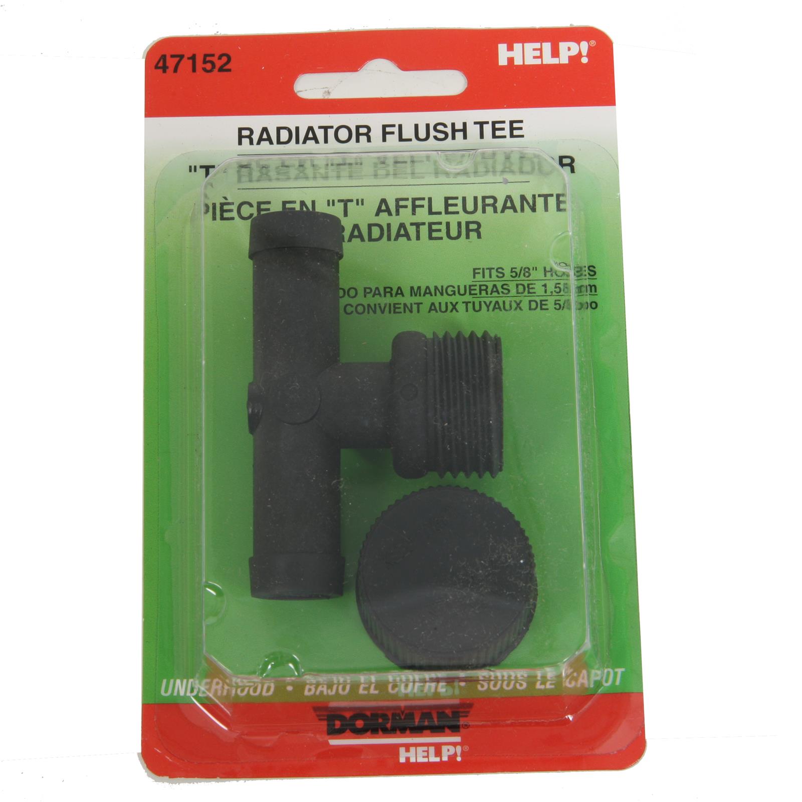

I did all that with just the block drain. Will try again tonight.I put something pretty similar to this on the heater hose from the head to the heater core:

First empty, drain under the radiator and under the block, to remove all the old antifreeze.
To flush, hook a garden hose to it and run with the radiator cap off. It's going to constantly add water, so it shouldn't get hot enough to open the thermostat, but run enough water through it to eventually end up with only clean water in the system. You're really only putting in enough water to remove old antifreeze or any other water soluble contaminates. At this stage it's pretty much just water that's running through it and shouldn't need to worry about catching and disposal.
Then open the drains again and empty the water, you don't want the minerals in tap water constantly near boiling in the system.
Refill 50/50 antifreeze and distilled water, or the premixed stuff. Leave the cap off that "T"'s garden hose connector until water comes out or the radiator is totally full, maybe fill some from there once the radiator is full. The air pocket that would typically need "burping" is going to come out this while filling.
