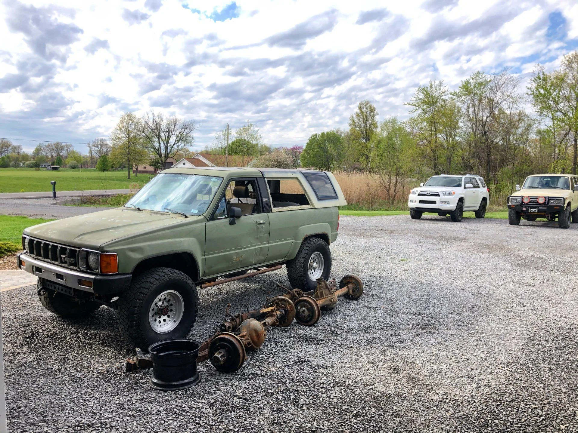

Looking for some feedback on my little bobbed ‘86 4Runner project. Scored some fj40 axles for the right price with 5.29 gears and was thinking of using them for my SAS. I know the gas tank will have to be moved to clear the driveshaft but has anyone else done this swap? Any issues id probably run into?

Looking for some feedback on my little bobbed ‘86 4Runner project. Scored some fj40 axles for the right price with 5.29 gears and was thinking of using them for my SAS. I know the gas tank will have to be moved to clear the driveshaft but has anyone else done this swap? Any issues id probably run into? View attachment 2316797
you’d be way better off finding a mini axle and use your ifs rear. That 40 axle has drum brakes, coarse spline axles and is spring under.You’d be way farther ahead buying 5.29’s for 8” diffs than all the fab work it will take to make those work. Your deep dish wheels won’t overcome the width differences. You can use your ifs hubs on a mini front axle and the width will match your ifs rear.
What he said. You're going to eventually put disc brakes on that coarse spline 40 axle and you won't like it doing it. Oh and you'll need to center the rear diff. Sure it can be done but again, why?
The ring gear is larger, but so what? Unless you plan on running sticky 42s and hydro steering and will be fully locked, you're fine. I've run 35s with stock original ring gears and original birfs for almost 3 decades with this rig.
Good luck with the build regardless of what you do. It's your rig, feel free to ignore us. Have fun.
Bigger differentials bring lower ground clearance.
