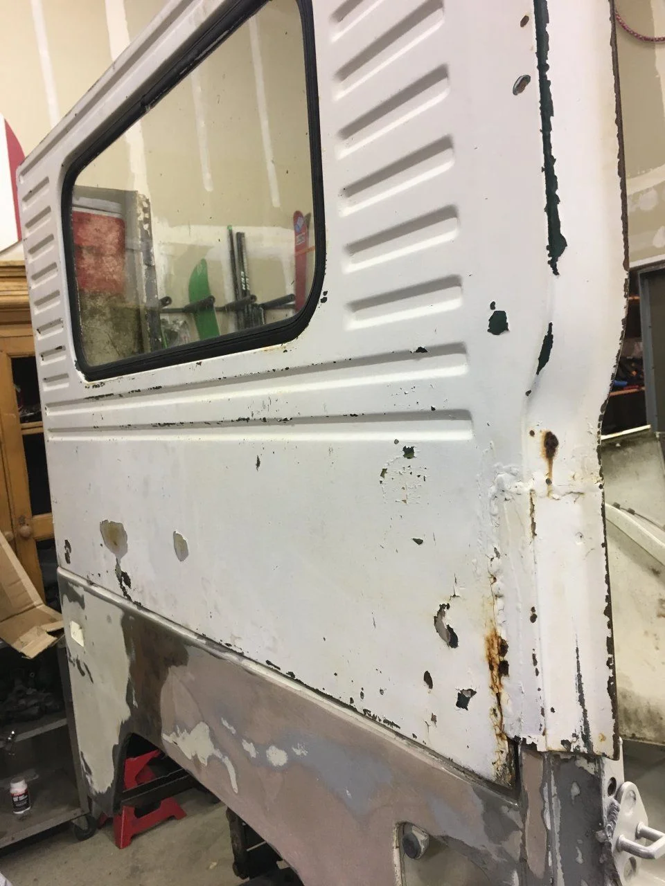

Scored an FJ25 hardtop. I think it's an FJ25 because:
The fiberglass had the vent in the top/back area.
The bifold only has a window in the top part of it, and only has the buttons to open (no levers).
So, I want to put this on my 1975 FJ40 tub.
Questions:
1: I keep reading that these have a "tall b-pillar". What are people referring to? Placing one of the hard top sides on my 1975 tub... it seems to fit and line up.
2: I also read that the fiberglass lid is "longer". In this case, the fiberglass is trashed... was delaminating. Can I rivet a newer fiberglass lid to the FJ25 gutter?
3: All the glass is there... but the window rubber is trashed. What can I use as a window rubber?
Thanks in advance!

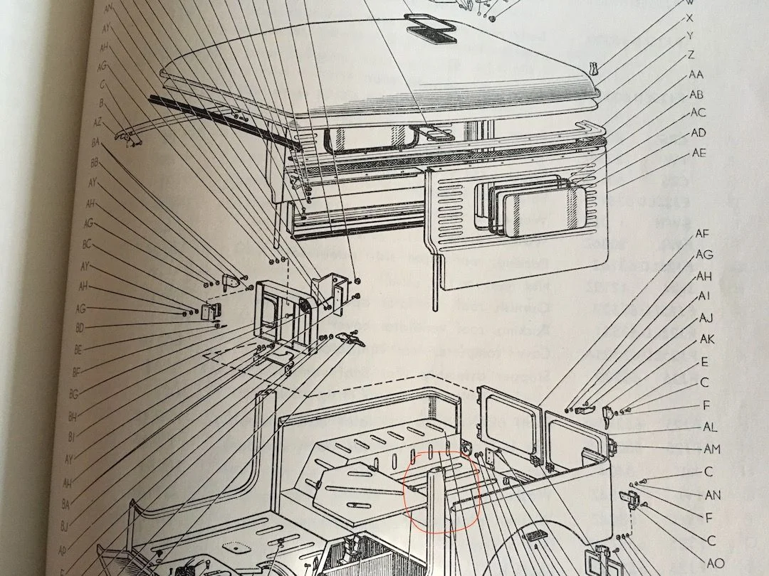

1:Tall b-pillar in red circle. 2: I have never compared the two, seems possible with some modification. 3: SOR has new rubber, i would ask your local auto glass guy to see what they can find
ohhhhh
ok that explains this front section welded on.
someone must have already put this on a 40 series.

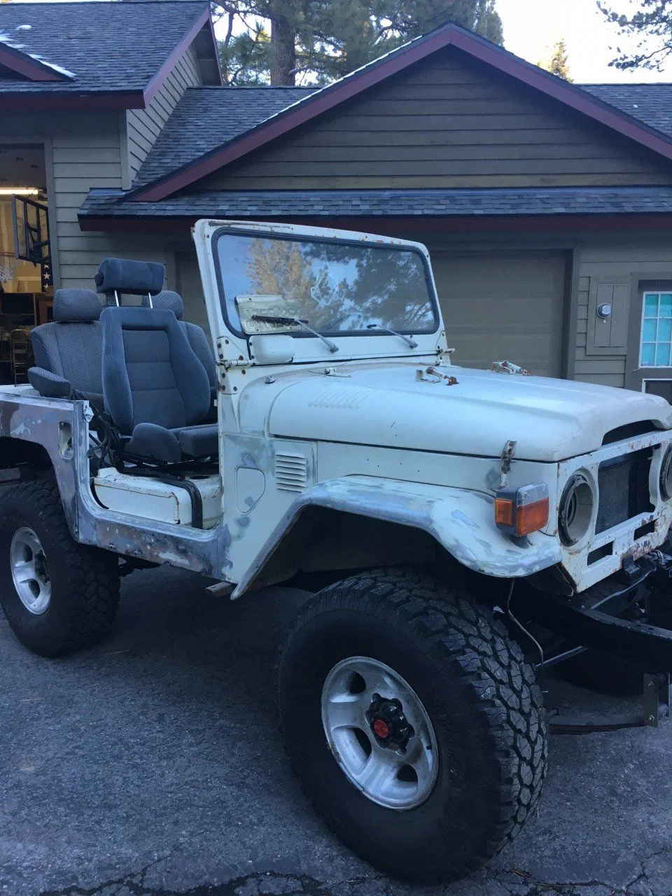

hey @tahoe40/45 what else you got stashed away? ha ha. Bought this beater 40 from the guy who owns Big Bear Auto (brown bear?) on 89 between River Ranch and TC. He offered to drive it to the house (I'm working out of a buddy's place in ponderosa palisades) and engine seized in the driveway. I guess owning a repair shop doesn't require you to do basic things like... check the oil (zero). Been building it into a "loaner Rubicon rig" for past few months (2F/SM420/35's/disks/Harrop-locker). Everything I've touched has had to be replaced. Was barely worth the $800 I paid (once the motor seized).
But it's getting damn close to being a running/driving/wheeling rig...
